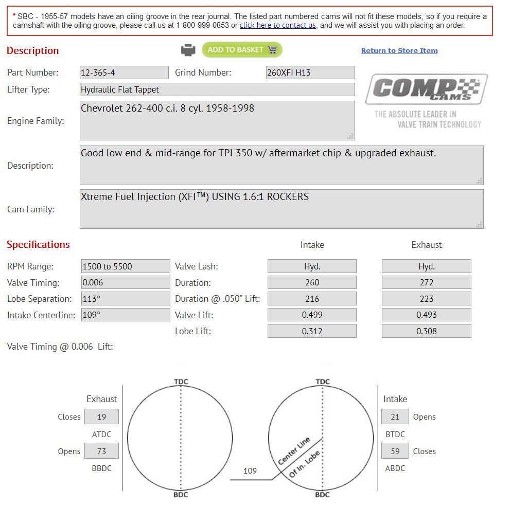

I think I stand to be corrected here on the cam. The OP said it was a PN: 12-465-4, I couldn't find that part number as a Comp cam PN. The 12-365-4 is the cam mentioned above and I have run that cam for about 10 years or so in my old 383 and it does run well, (12.95 ET in my 82) but NOT with a stock 82 ECM with that duration @ .050" even with a modded PROM. Here is the spec for the XFI cam 12-365-4...
So, whoever said the cam listed is NOT the issue is wrong, sorry, jus sayin'. If this is not the cam you have, please post the correct PN and full cam card spec, thanks.

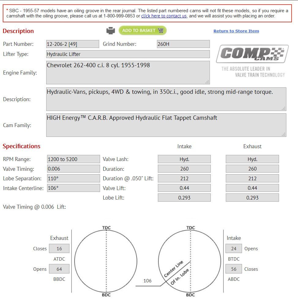

Here is a cam I also ran for about 5-6 years in the beginning. It's a single pattern cam, not a power house cam, but it does run well and is stock ECM friendly and likes chip mods. Run 1.6 rockers for a bit more lift if you like which should put it roughly .470ish. Just a suggestion, there are plenty of others out there to choose from.

I did type the incorrect cam part number. The cam I have is the 12-365-4
