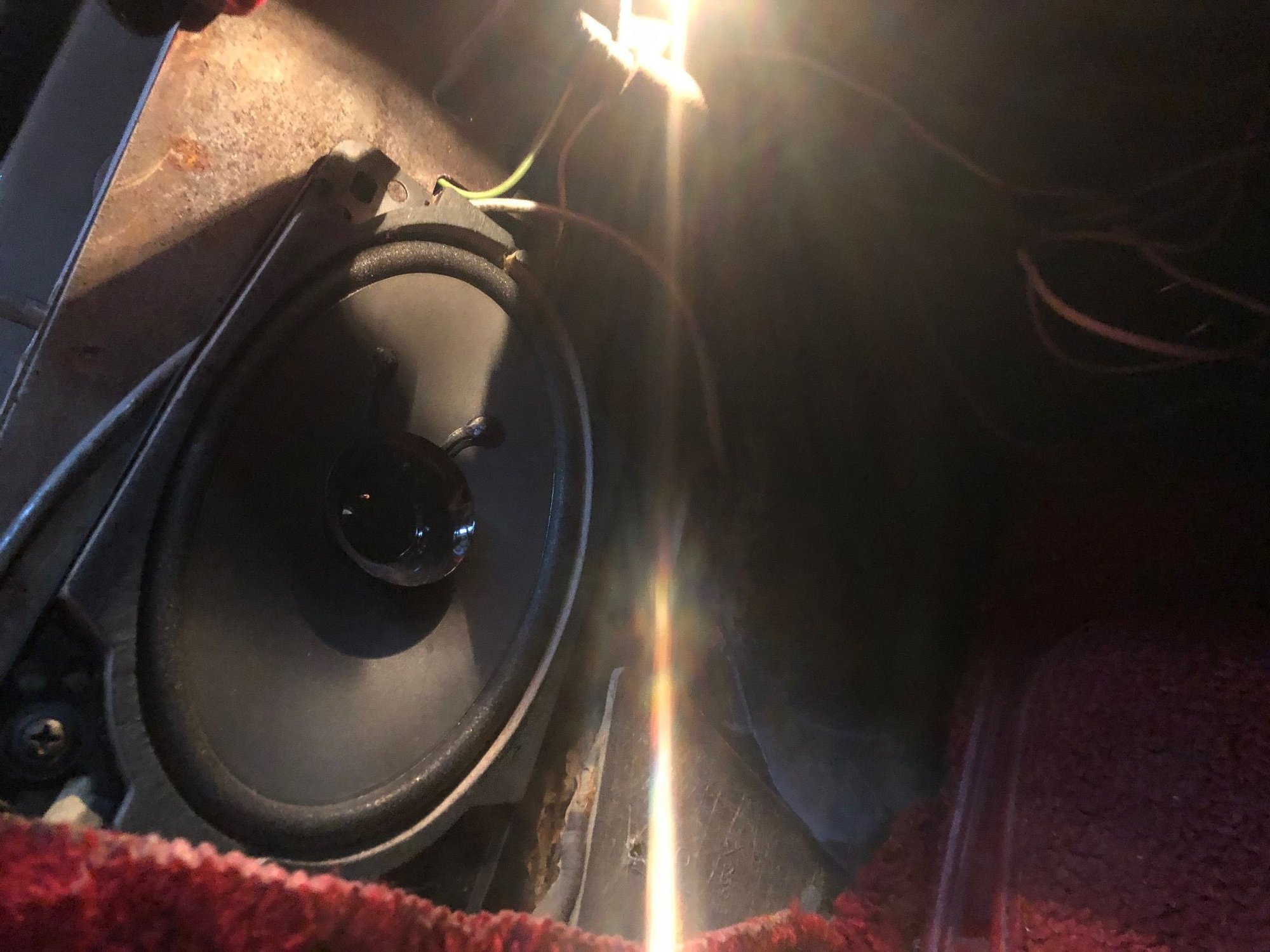

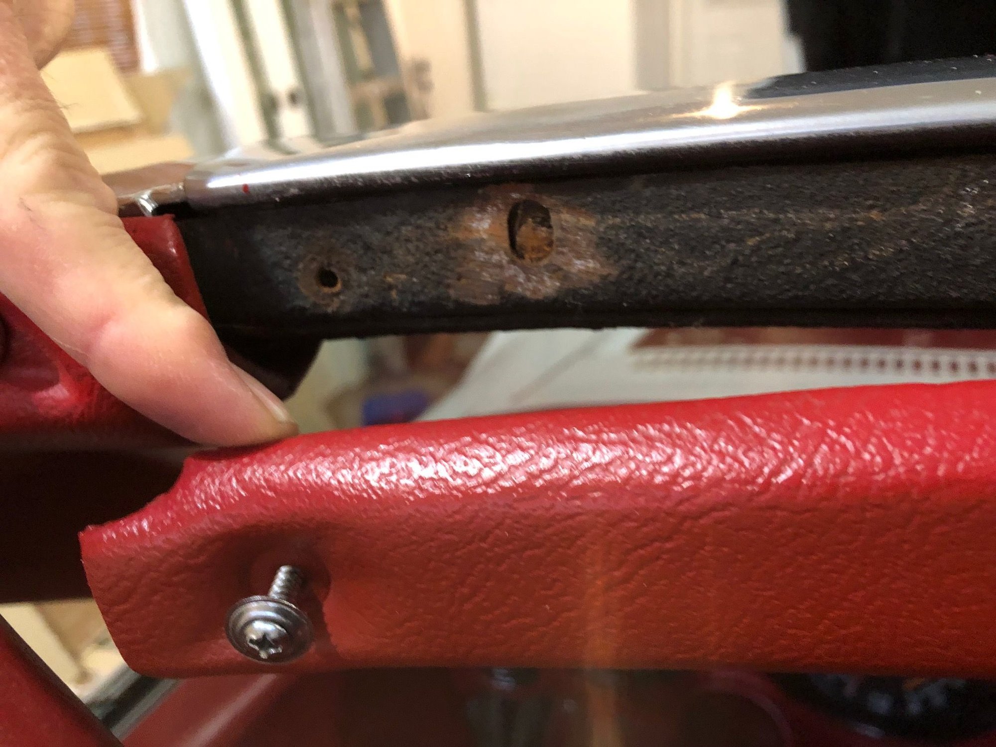

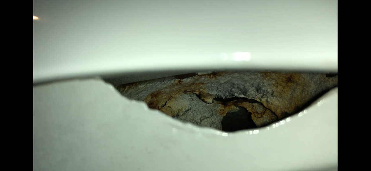

thats the location of the hole
behind the kicker panel
looks rusty, but felt solid when scratched with a screwdriver

Yes thats bad rust in behind the front guard.
The area behind the kick panel , well that speaker is in the way so no idea on how much rust is down there.
But really the first 2 pics would be enough for me too walk away from it. Unless you want to do a restoration on it, which would involve removing the front clip all together.

Depends on who is doing the work. If could get very expensive. Would include removing the bird cage and fixing. Anything is fixable... However, the removal is basically a full body off restoration, so you will be deep in the 5 digits to have someone to this for you. If you are after a project car for yourself and know your way around a paint gun, welder etc it can be somewhat affordable. But this is probably a big multi year project.
There are better ones out there. Unless you are wanting a large project, I would probably advise to move on to something else.

Looks like someone has done a "lipstick rebuild" on that IMHO. Looks great from across the parking lot, but you will do yourself a big favor by looking somewhere else.

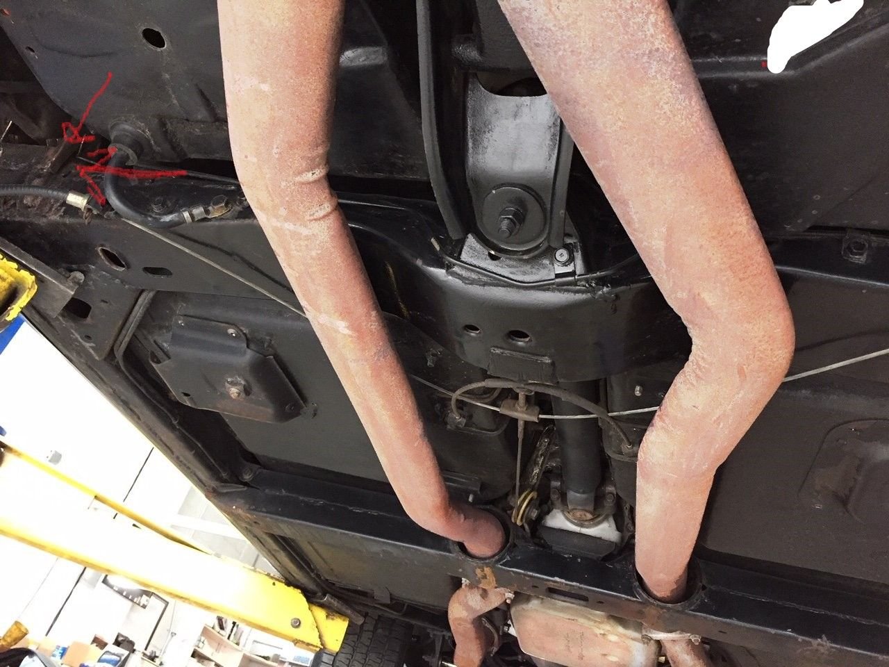

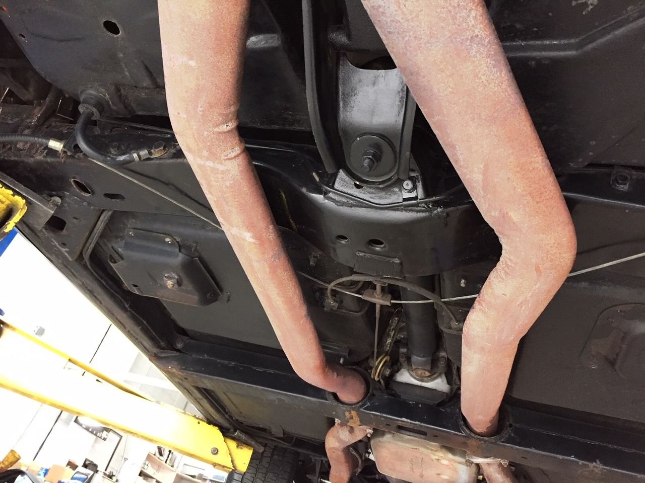

just noticed the left trailing arm area has its re-enforcement cut away , they are usually full of mud and stones anyway. Also has a new seat belt mount that's just pop rivetted on ,so yes looks like the easy to get at rust was taken care of ….kinda !
