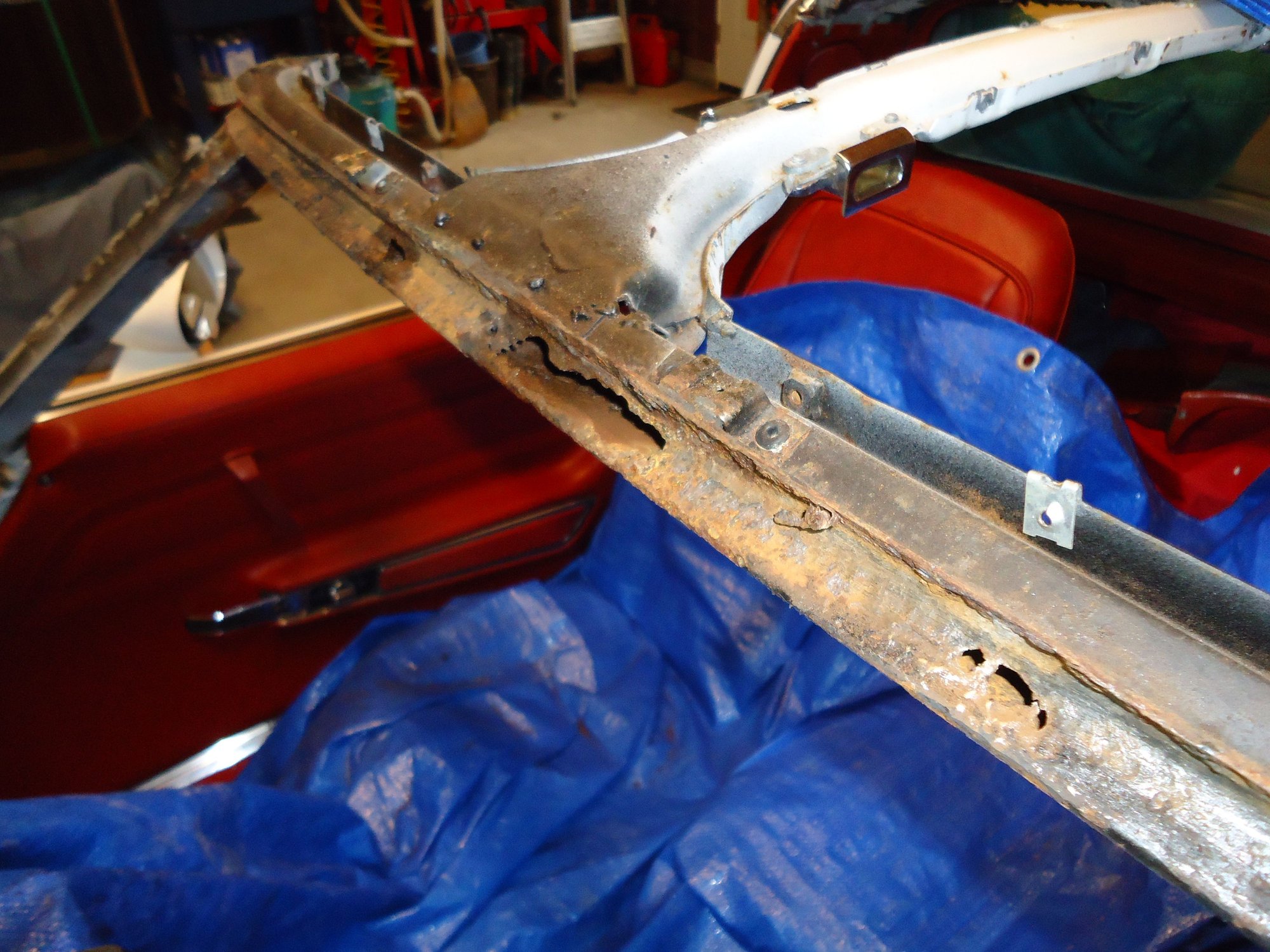

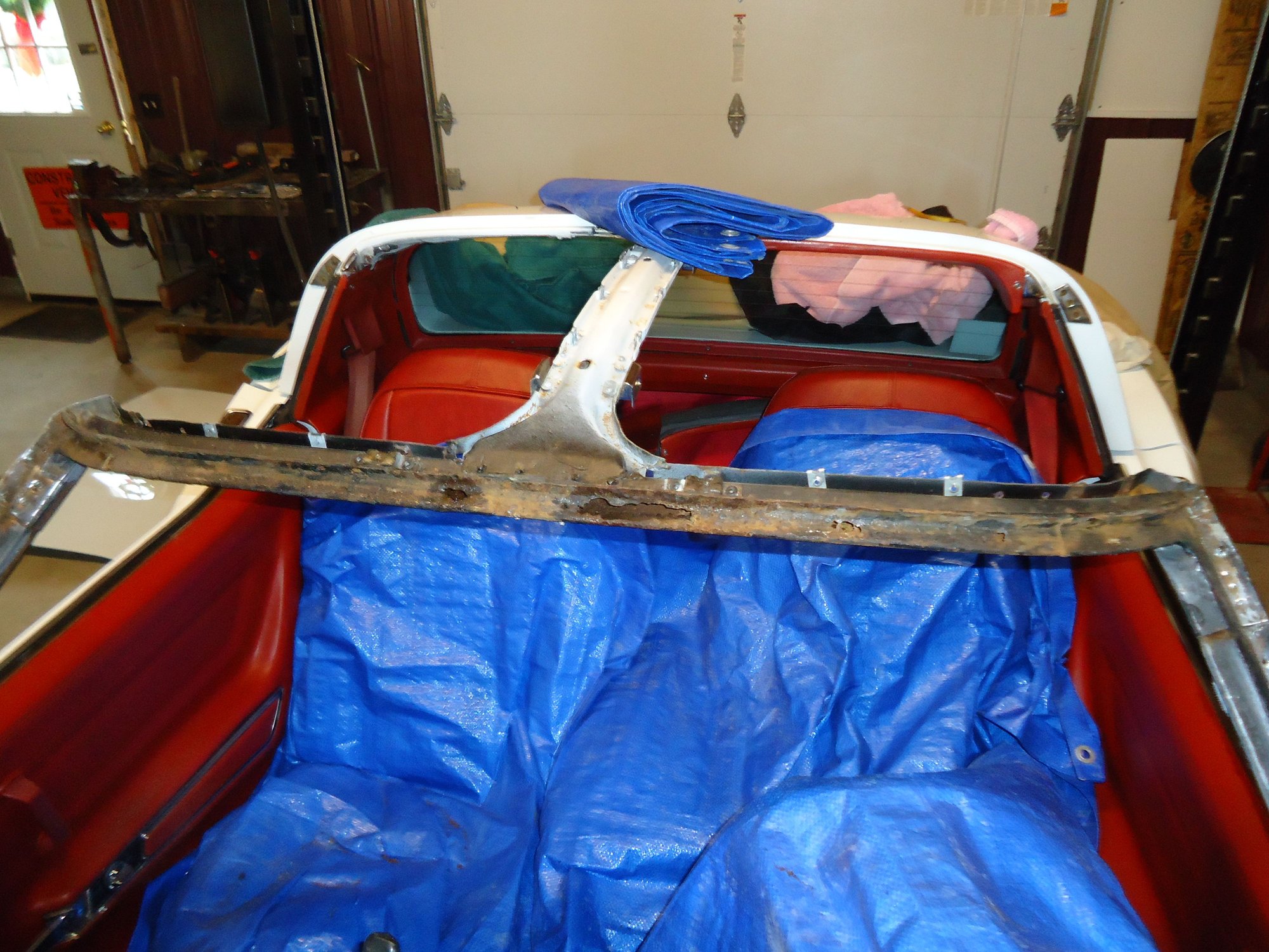

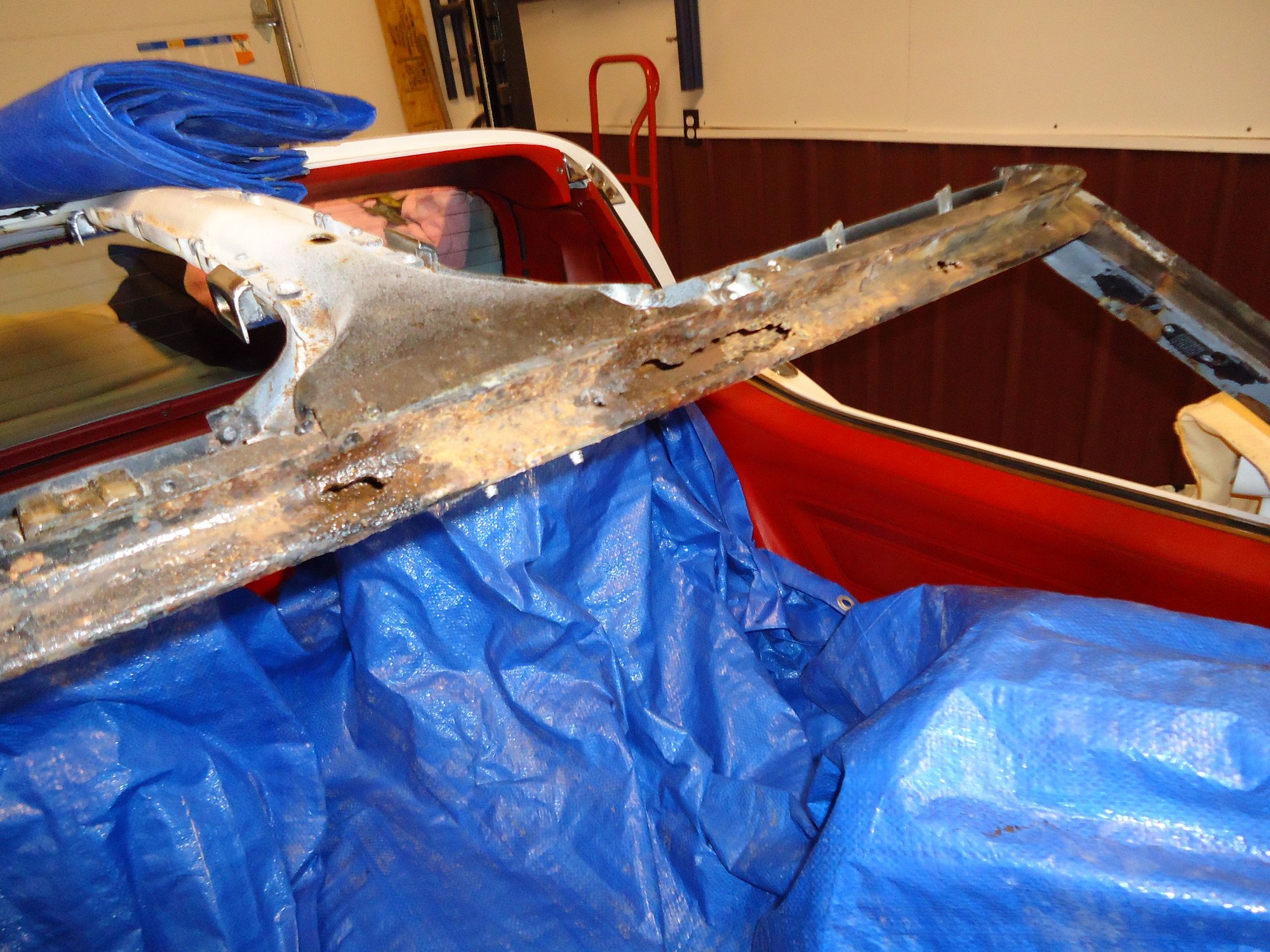

Its been a while since my last post but once again I need your assistance. I'm dealing with some rust issues on the windshield frame. I did a search for old posts , but I would like an opinion. most of the frame isn't bad rusty but solid. Just clean up and prep with rust inhibitor. how ever along the top, I have some pretty bad holes. Instead of replacing the entire top rail, what do you think of cutting out the top area that's bad and fabricating a piece to weld back in. It would be maybe 2 feet long. the underside is still solid, its just the area where the glass lays. what do you think?

Others on this forum that are "body men" will likely have better advice than I. But I think instead of fabricating something that may or may not fit correctly, is a bad option. Over the years I have found web sites that specialize in salvageable parts from Vettes. Basically, Vette scrapyards. Bodies gone, drivetrain gone, but still have the birdcage intact. I think I would find and contact one of those vendors and see if they have a donor car, are willing to whack off the top frame and are willing to ship it to you. (YouTubes Corvette Ben has one "outback" in Texas right now) You would be a lot farther ahead. Then you know the glass will fit correctly, all the trim / molding will fit correctly. Plus the T-Tops will seal correctly and in the unlikely event of a roll-over, it should support the top.

If I have to replace the top frame, ill get new pieces . the header $375 ish and corners around $90 . Its a big job to replace those pieces, just trying to avoid all that work.
Not to mention possibly misaligning the frame creating a poor fit. I have read of other members making repairs on smaller holes, I wonder if my idea was ever attempted with any success.

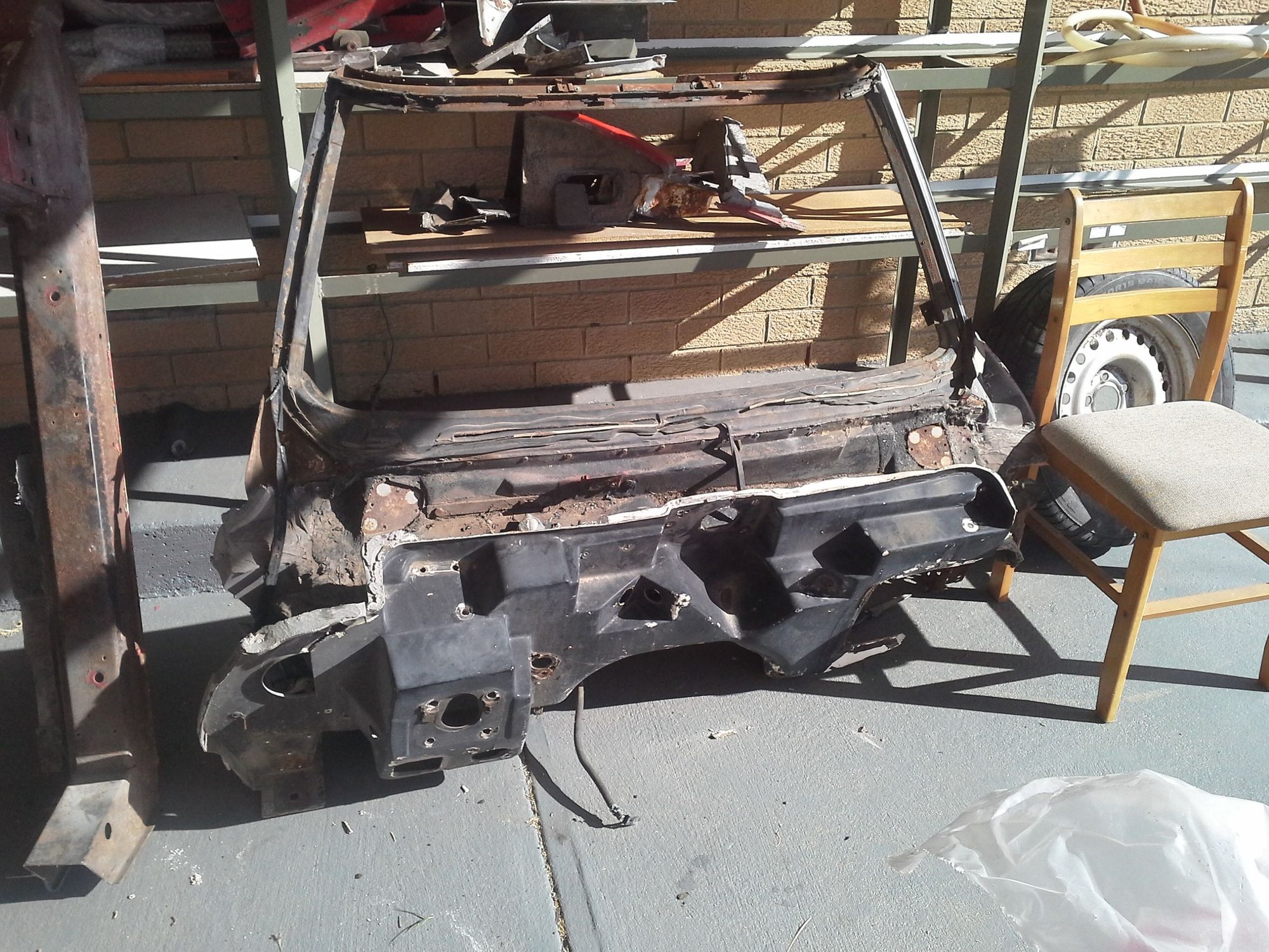

I have done some rust repairs on 69 vette , I would not attempt to "make a piece " , it is such a complex shape .
Also apparently a concern (I have read here) that area is under a pre-load , so as soon as you cut the piece that comes from the back it will spring apart.
I would contact those vette wreckers and get the replacement piece from another vette (as it was made in the factory jig and should be a better fit ) than "aftermarket " pieces.
FWIW , what I would do if it were mine , I would cut the top ( front to back) section in the middle of where the 2 chrome trim pieces are , that way you can use the 2 trim pieces with their 4 bolt holes to help realign the join
Depending on how bad the rust is INSIDE that top section would be how I would work out the cuts for the left and right side , but I would try hard to leave the corners there.
I have a real nice windscreen surround here which is exactly what you need , from my 74 birdcage donor car !

If you are only fixing the forward upper edge where the holes are, I've been selling some of our old test headers parts as repair pieces.
So, will these parts work for the entire length.... Nope.... All the parts are from headers that didn't work. They were out test mules.
But if you just need the metal sections for the area you have the holes I believe it would be a good repair part. (It's not my choice for the repair). But the option is available.

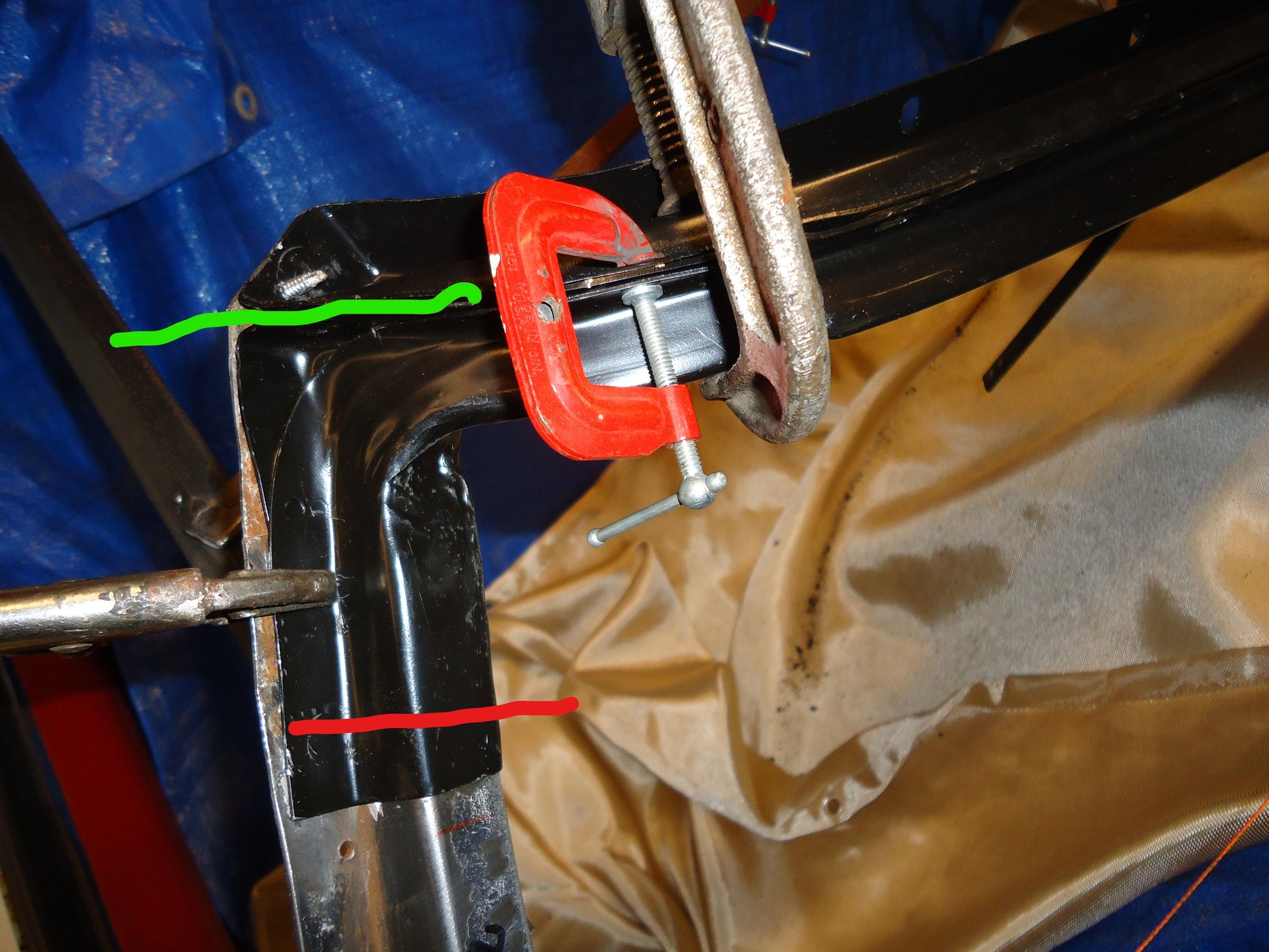

Ok Now I need help. I fitted the new header piece in place. The drivers side fit pretty good but the pass. side is giving me some trouble. I tweaked and pulled the best I can , but the corner
just doesn't look right to me. The corner where it meets the indentation on the side post is too low. The red line on the pix. Can I trim 1/2 inch off of that or leave it alone. Also when I removed the old piece, there was some type of calking in between the joints. The area with the green line. what do I do there? Now to welding, I don't have a spot welder so I assume I drill holes in the corners and plug weld those ????
What do you think?

Did you take any measurements before you cut the old pieces off???
Do you still have the pieces you took off around???
DUB

Not the corners ,the old top is intact What are you thinking?

My measurements are the same I think the replacement corner is a little off. I braced the sides with angle and an x brace. they can t move

The more I look at it, I think I got 2 lefts instead of a rt and left. That corner was labeled wrong . Hey willcox what do I do now?

After looking at it again this morning, I was wrong , it is the correct piece, just 1/2 inch long on the vertical side. I don t know why????
