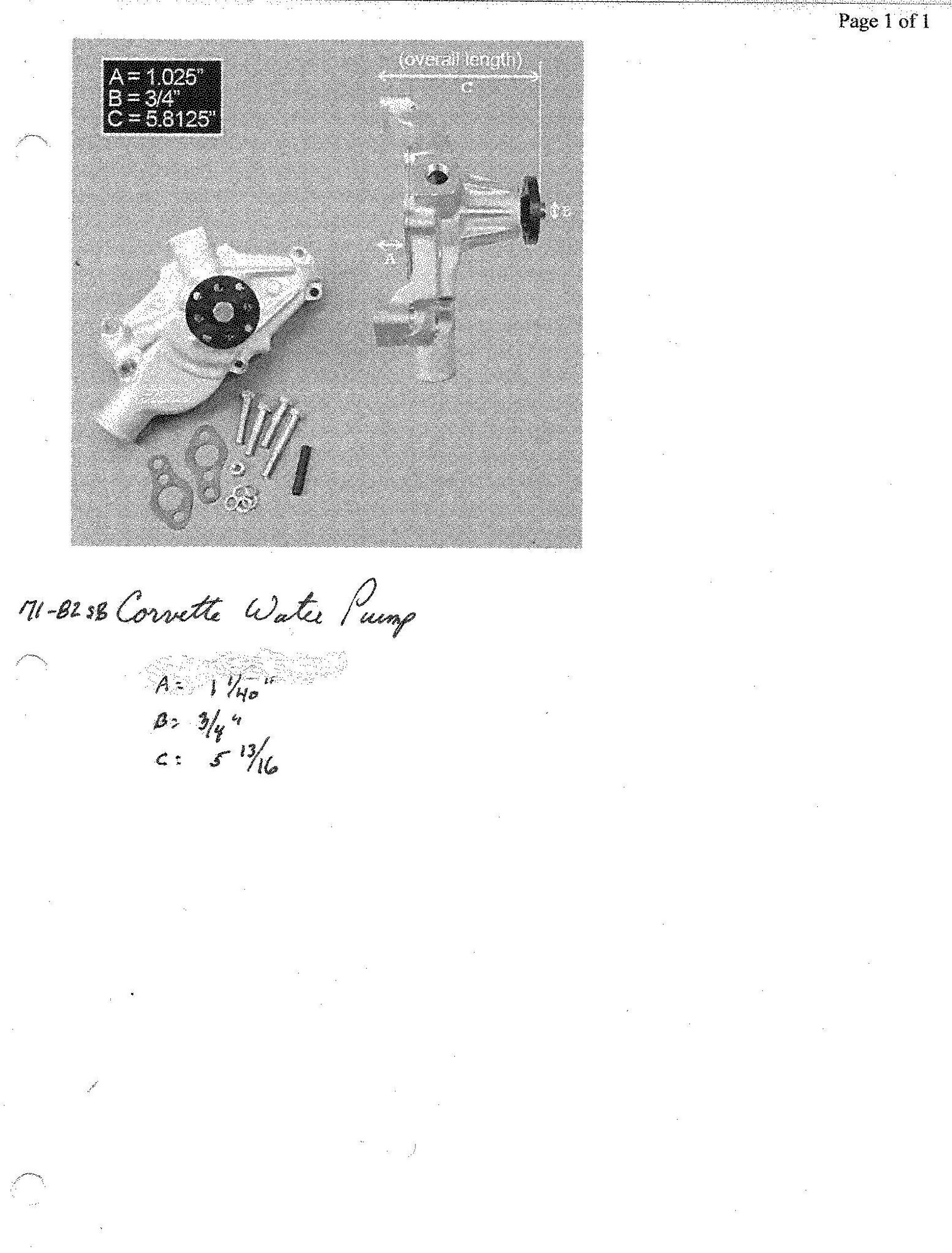

The water pump is Corvette only so measure the old one to compare the size.

What Vehicle did the Norway 350 come from? A vette, a truck, a caprice or what? Does it have a Long pump now? Does its pump match dimensions Peterbuilt supplied above?
Just as sbc 73 Vette pump is unique, so are the 73 Vette combinations of sbc brackets & pulleys which are configured to fit sbc vette pump only.
Big Block Vette brackets & pulleys combo are Not configured to fit small block.
