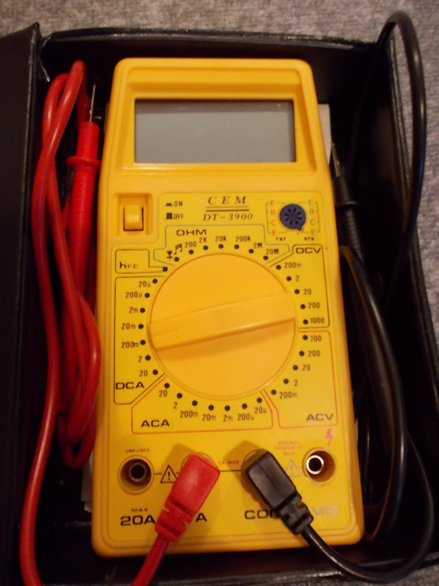

I have this digital multimeter but I don´t know if it can measure amperage draw?? If it can -could you please tell me what option to select on the multimeter before measuring?

I know some guys have these high-tech DVM's and can use them but I have a specific tool I use to check amp draw so I have not clue on how to use what you have and would have to read the manual that came with it or call the company who made it an talk with them.
If it were me...I would put it on the DCA scale with the headlights on and have it set on 20 and read it and go from there....then turn of the headlights and see what it reads. Obviously you have your battery cables attached I presume for this test.

That meter is more for electronics, but it will work. Referring to the photo, the red test lead is shown inserted into the A (amp) connection meaning it will measure basically in milliamps. This setting is good for small measurements. Do not use this setting if you have a large amperage draw thru the meter, it will blow the fuse. If you know you will be drawing a large amount of amps or more than 1 amp (something turned on), move the red lead over to the 20A setting so you don't blow the fuse. I am hoping it is fused, I couldn't find the manual online for that model.
What I would do is start with the 20A to measure the draw with everything off, doors closed. If the meter shows a very small amount, switch the lead to the A setting. The photo shows the selection switch on the 200m or milliamp setting. The switch is correctly set for direct current amps (DCA). You could start with the 2 setting then range it down by just turning the switch back down to the 200. All that really does is move the decimal point for you. Hope this helps.

I have now tried this...in 2 setting it shows .006 and in 200 it shows 06.4 What do these numbers tell us?

If you have a newer stereo with memory, it's fine. 6.4 ma is next to nothing. It would take months to drain a battery at that rate.

My C3 has still got the original radio.. But if 6.4 ma is very low then it must be 99.9% a bad battery!

When you switch the setting ****, it just changes up the decimal point. As posted by B2B, the 6.4 milliamps (thousand = 1000) is a very low draw.
Yes (as posted before) get the battery tested, but I would also check and clean all batt/cable connections.
