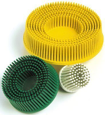

I use these with a 90 degree die grinder........best thing ever invented:

They are plastic....different durometers....the green is for cast iron....white for aluminum.
They do not scuff or mar the host metal.....
The white ones were actually developed around 2000 for the 100% failure rate Dodge Neon 2.0l head gasket repair.
Get a $40 90 degree grinder and the adapter and use these....they are the bomb dot com.
Jebby

3M bristle discs AOK ... I use a yellow bristle disc on iron & white on aluminum.
*place rags in bores ...cover rest of openings as you should with any build.
First, Clean decks with gasket scraper ... then, with a light touch, clean the remainder off with bristle disc.

Agree completely with Jebbysan on this one. Been using the Roloc pads for a couple of decades. They are excellent.
Scotchbrite pads came on strong and we loved them at first, until we got the bulletin from engine manufacturers in the mid 90's. Their issue was that they removed too much material (generally on aluminum parts) and distorted gasket surfaces. So we switched to Roloc.
