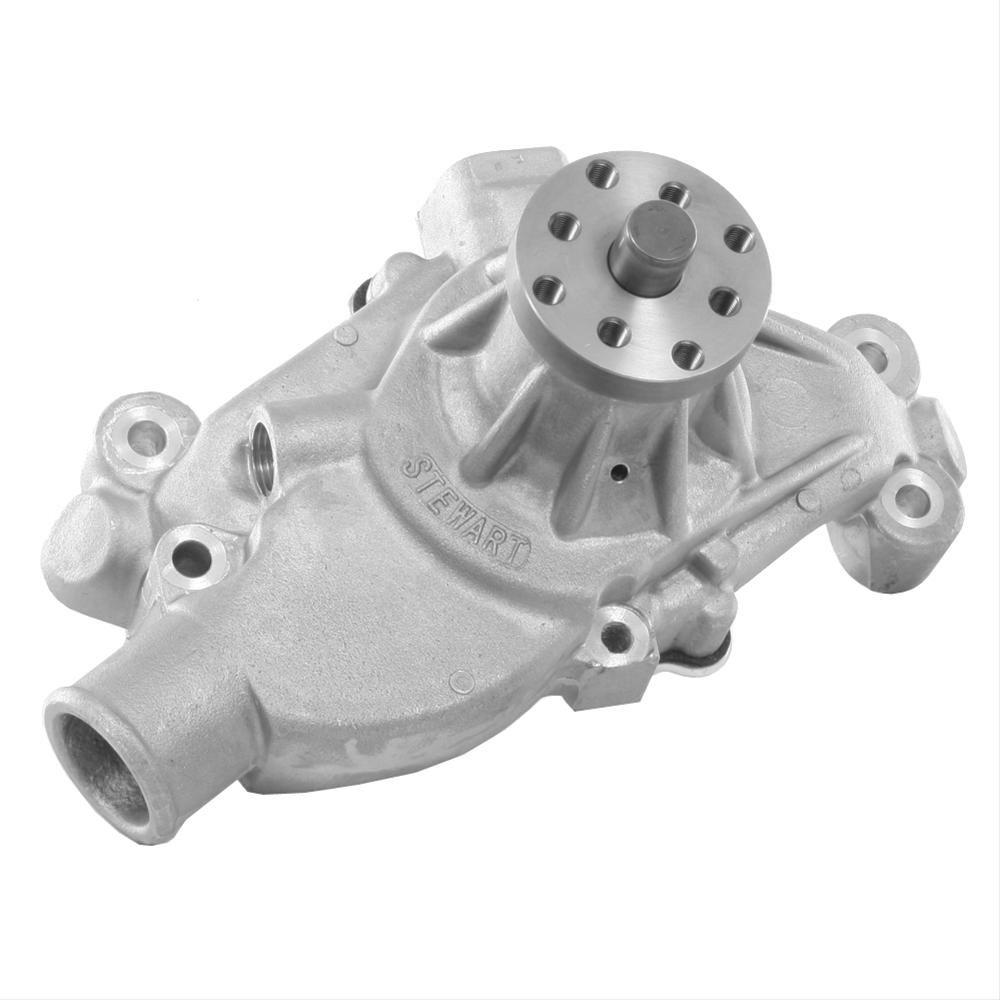

This is the stage two Stewart pump that I'm using. The point that I want to make is that, the modified tstat is not really needed with this pump. Stewart says to use the modified tstat. When I do that the motor doesn't warm up.

The stage two pump doesn't have a bypass so the ts needs to be modified. Also, the stage 2 pump is more for race than street use.

I just looked at my pump. I have a nipple coming out of the side of the pump. It is plumbed to the heater valve. I have a pipe plug in the top of the pump. The other heater hose hooks up to intake manifold from the heater.
Sorry forgot to take a picture.
I put the non-modified 195 degree stat back in just now. It's getting to 195 and dropping to a steady 180. So that's how I'm going to run mine until Summer.

This is actually the correct pump that I am using. It has provisions for two outlets. Is this what is considered a bypass type pump or not?
Small Block Short Stage II pump
