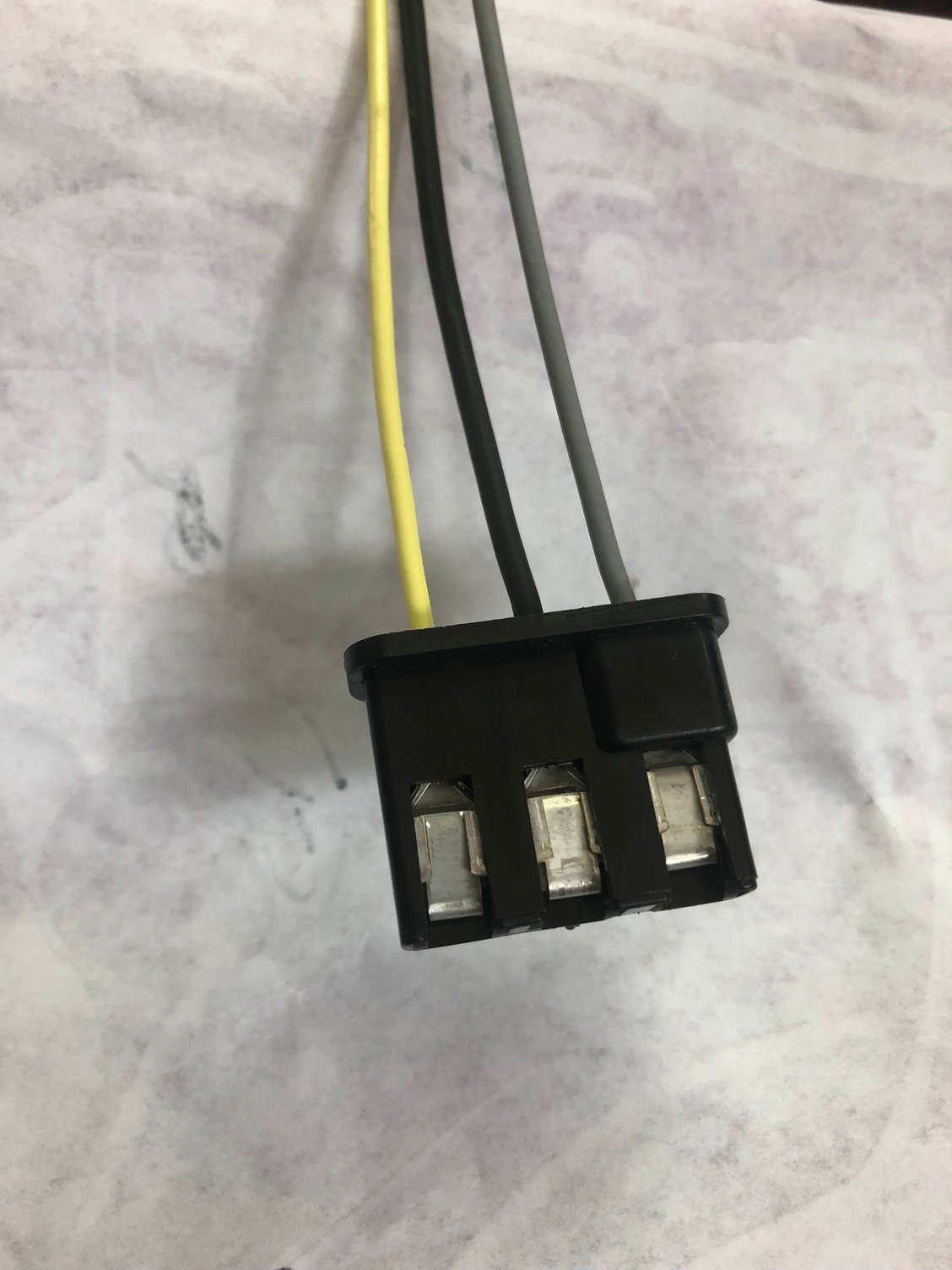

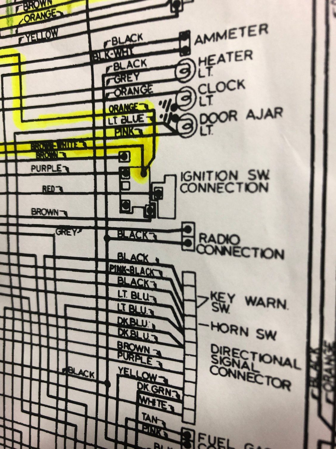

Anybody have a picture of 72 radio plug. I think I found it but to many wires according to wire diagram I have
Not the highlighted area

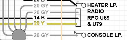

I believe that's the correct plug. My diagram shows as grey, black and yellow

You have a much better diagram then I do apparently

I've got a bunch of different diagrams that I've been slowly merging into one that's actually (?) correct

Croaker, this is correct for the radio connector. Yellow is power, Black is ground and Gray is dial light.
