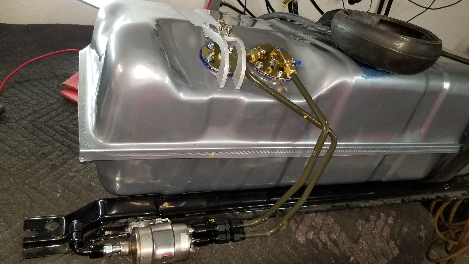

This is my almost return-less system. It spills back about a foot away from the tank at the filter /regulator and the regulator at unit gets capped off!

I copied 'redcruz' idea, worked out well. Thanks again redcruz. T

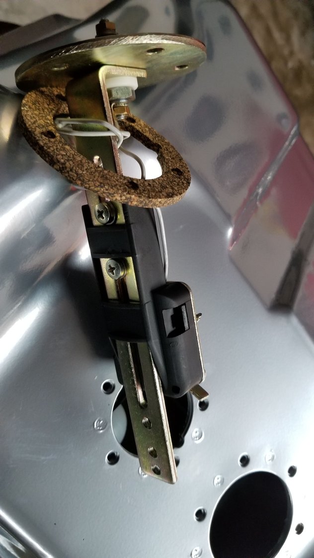

Is that the tank from Holley (or Tanks)? If so, does this tank move the sending unit to the top of the tank? I have never pulled my tank, and some of the videos I have seen show the sending unit on the bottom.

Holley purchases their tanks from TANKS INC. T

The pic above looks good. Looks like what is typically done for LS swaps. Fuel filter regulator is from a C5 Corvette. Regulates at 58 psi. I typically don't run hard lines. I use -6 steel braided for the return and up to the fuel rail on the engine. If you do decide to run hard line I would suggest using Ni-Cad brake line. You can buy it in different lengths and if flares like butter.

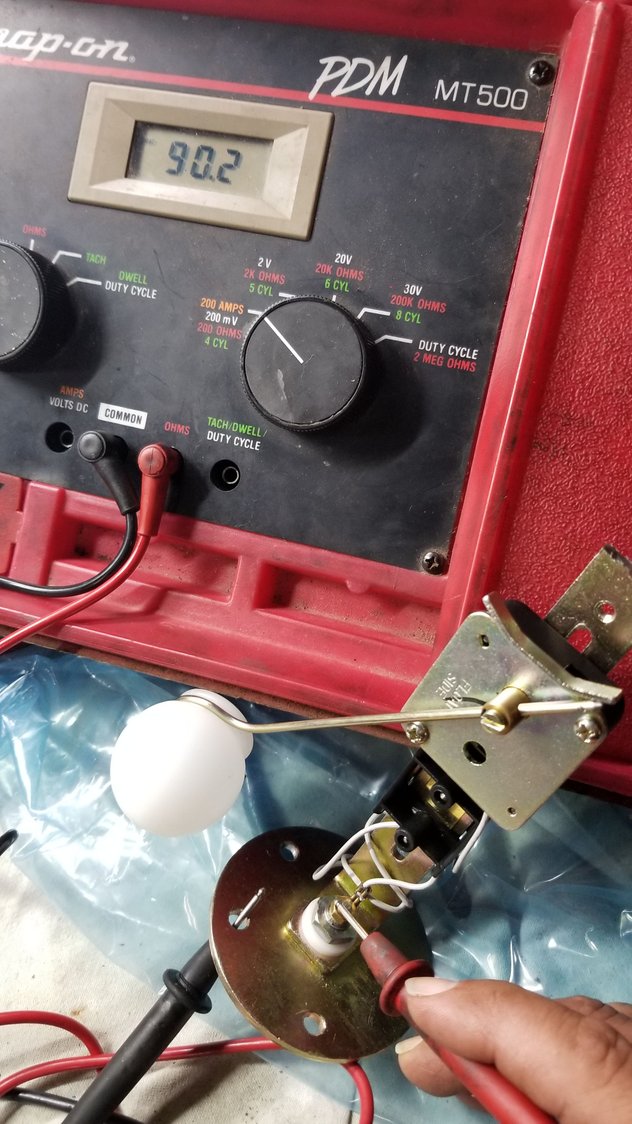

Its from Tanks Inc. Same one holley sells for them. You do have to purchase a new sending unit that goes to the top of tank!
