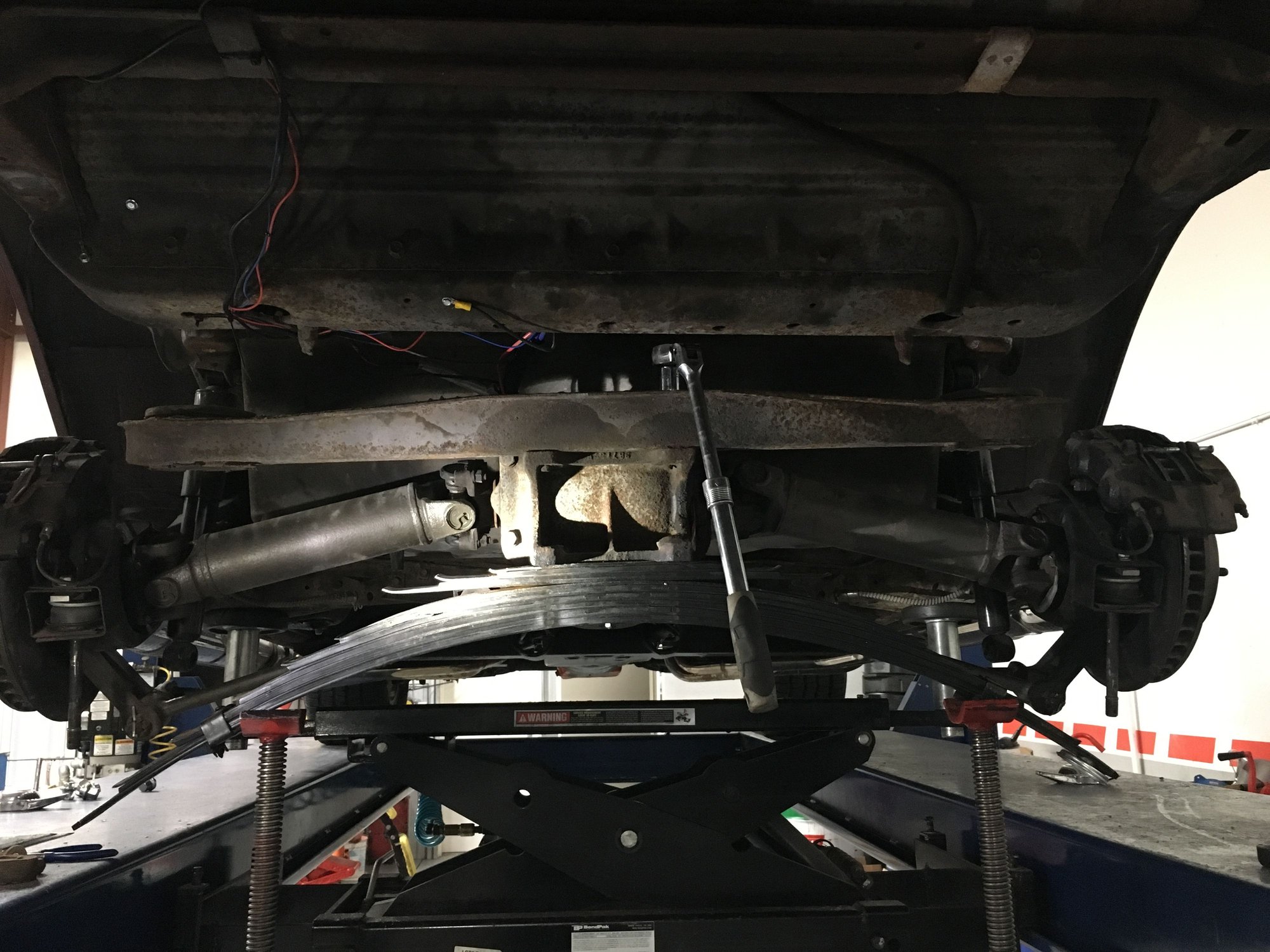

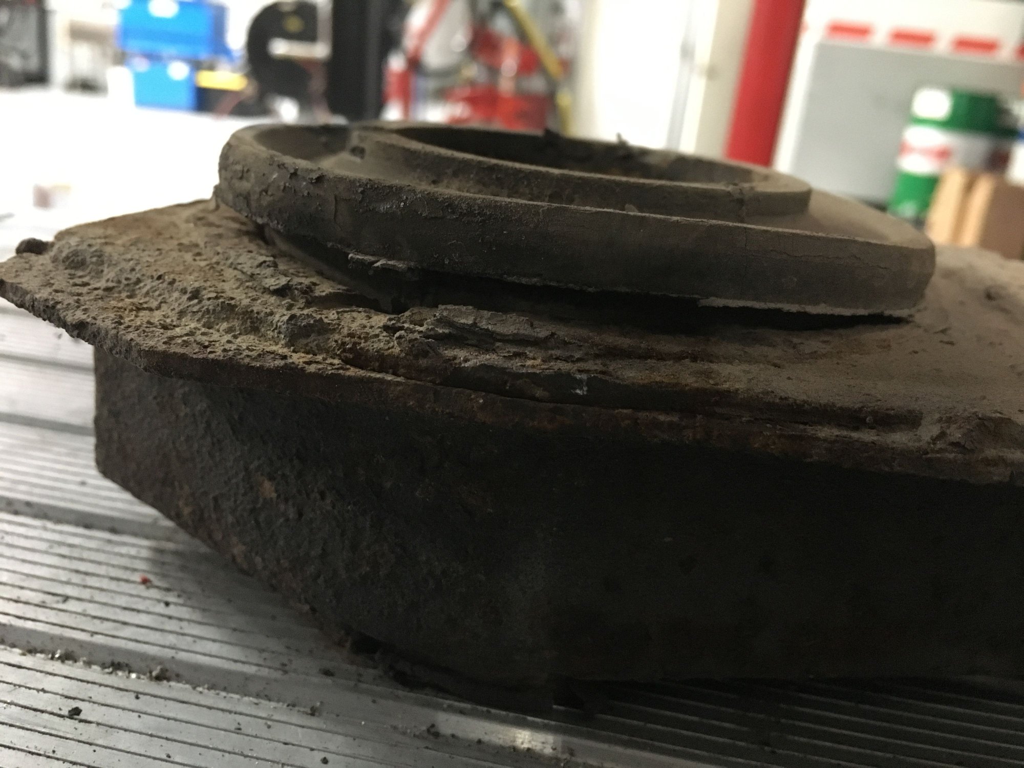

Having blast cabinets is handy.
Left side
Right side
well, I’m deep into it now. Hopefully these and the next batch of pictures will help me and others.

Have diff level
Clearly right side not hanging as low
Look at gap to shock for reference
Right side sitting on frame
Left side sitting on frame

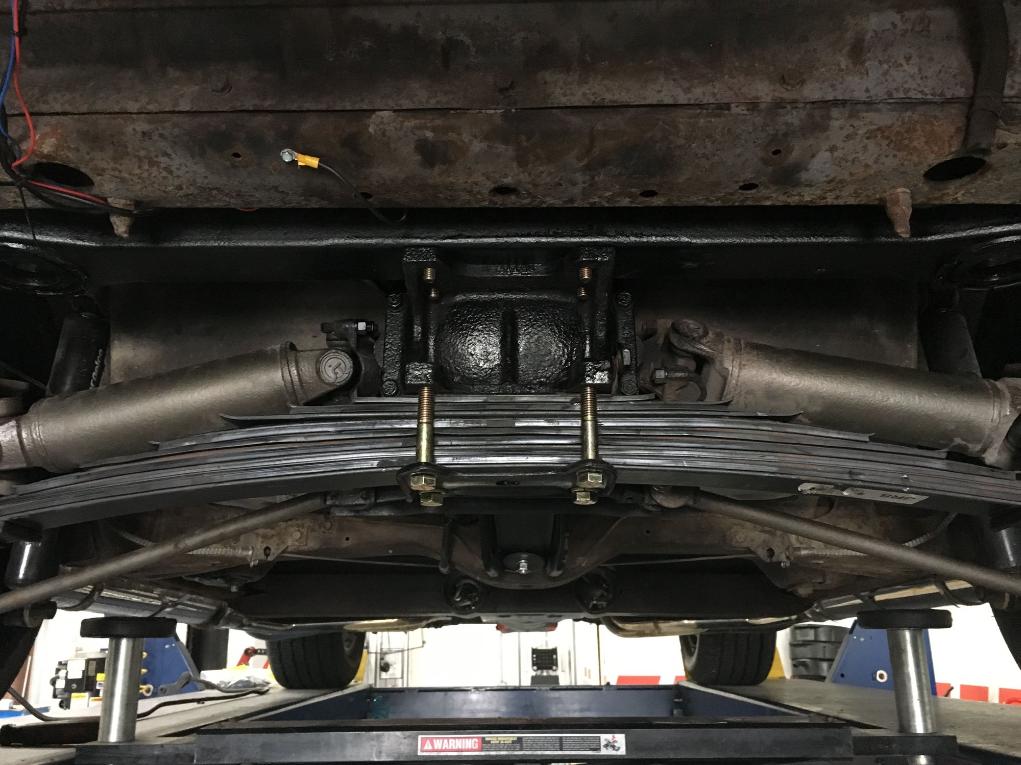

In photo number 4 from the top it looks like the arch of the spring is higher on the right side that the left side. Could the spring itself be tweaked or weaker on one side than the other? A bad spring maybe?
in photo 4, the spring was just being supported. The stock spring allowed the pass side to sit low. I bought new 9 leaf spring. It still stat
low. I reversed spring to make sure it wasn’t a weak leaf. It sat exactly the same.

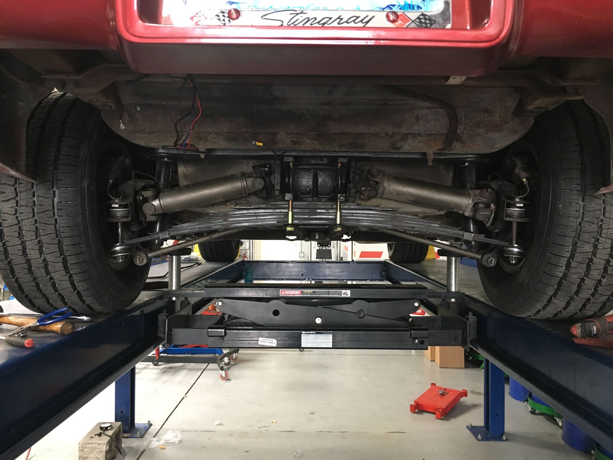

In the photo of the rear with the level the left lower mount looks off - it may be the photo angle.
I would take the spring out and after the rear is remounted check the mount for level and / or bends.
The spring should hang almost level.
I'm often too exacting so I would be cleaning and measuring each part as I went. IT's easier now then to take it apart later.

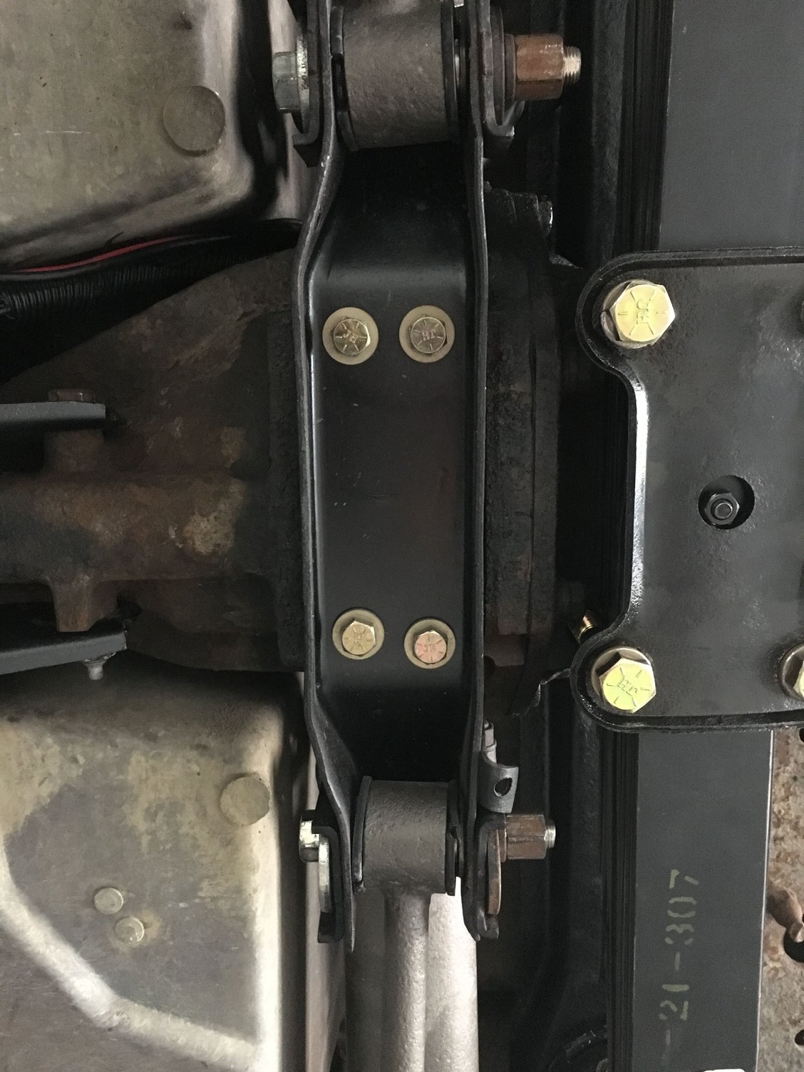

Thanks for all the help so far. At least I’m learning about the car. So, after thinking I found nothing serious wrong, I reassembled everything with the new snubber and crossmember bushings. Car sits low 1” to passenger side stil.
So so then I wondered about the strut rods and bracket as they have been replaced with new bolts before me. Something looks amiss.

Is this the correct bracket as I’ve seen many different ones in google images. This one is obviously bent. Also looking like the hard angle on the strut rods would be reduced if the bracket were flipped 180 degrees.
If im buying bushing, brackets,etc, any validity to get the adjustable units I’ve seen?
The strut bracket looks like it's in the correct position, flat side to the rear of the car. Check out Globalwest.com and watch Dougs Video on strut rods. I've installed these on my rebuild/yet to be tested, but I'm confident they'll do the job.

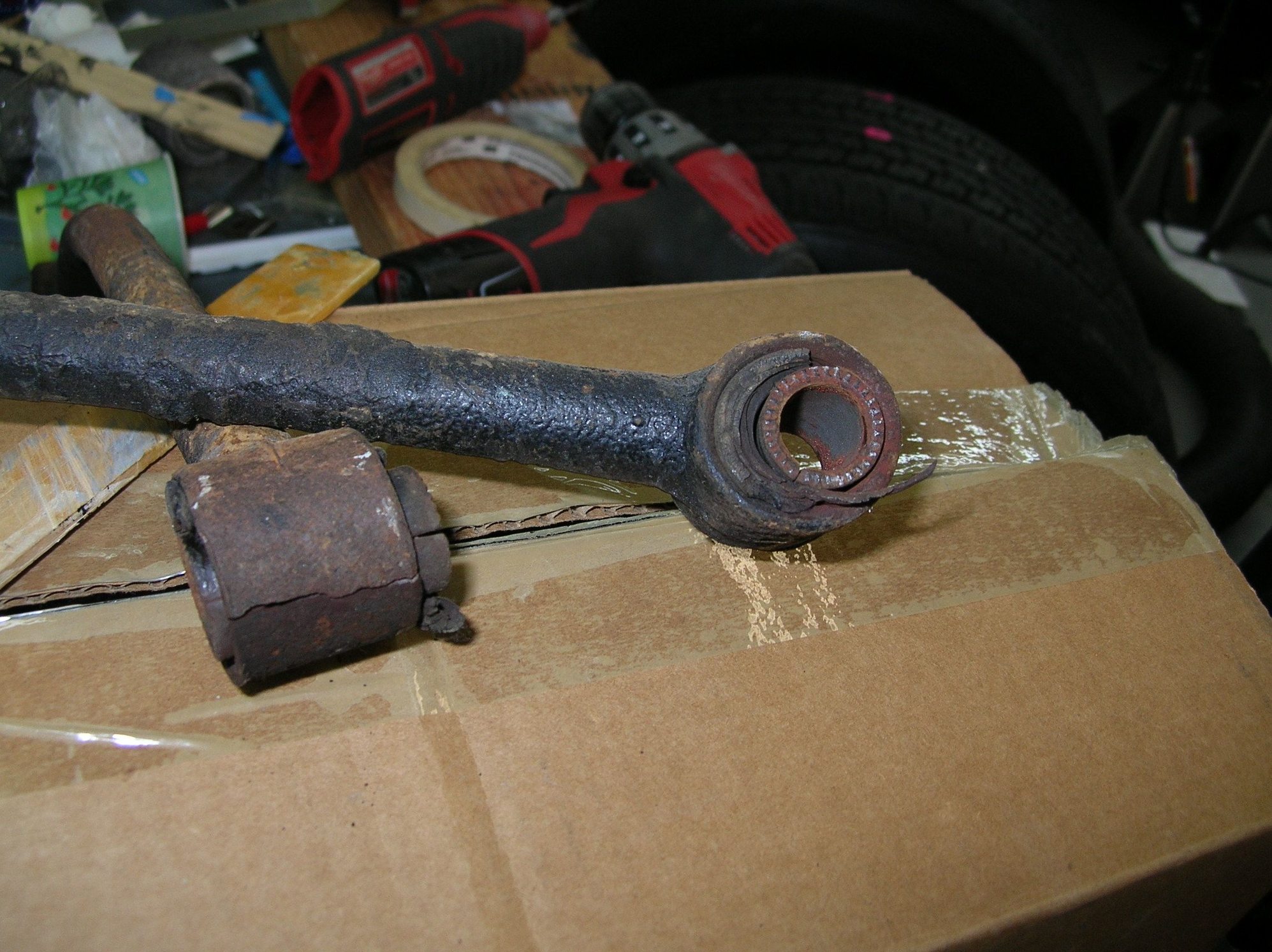

I got mine from RICKS CORVETTE, They make alignment easier. They are also more durable if you intend to really push the car. If yoy are going for an alignment in the rear I would get the SS shims for the rear trailing arms - 2 packs.

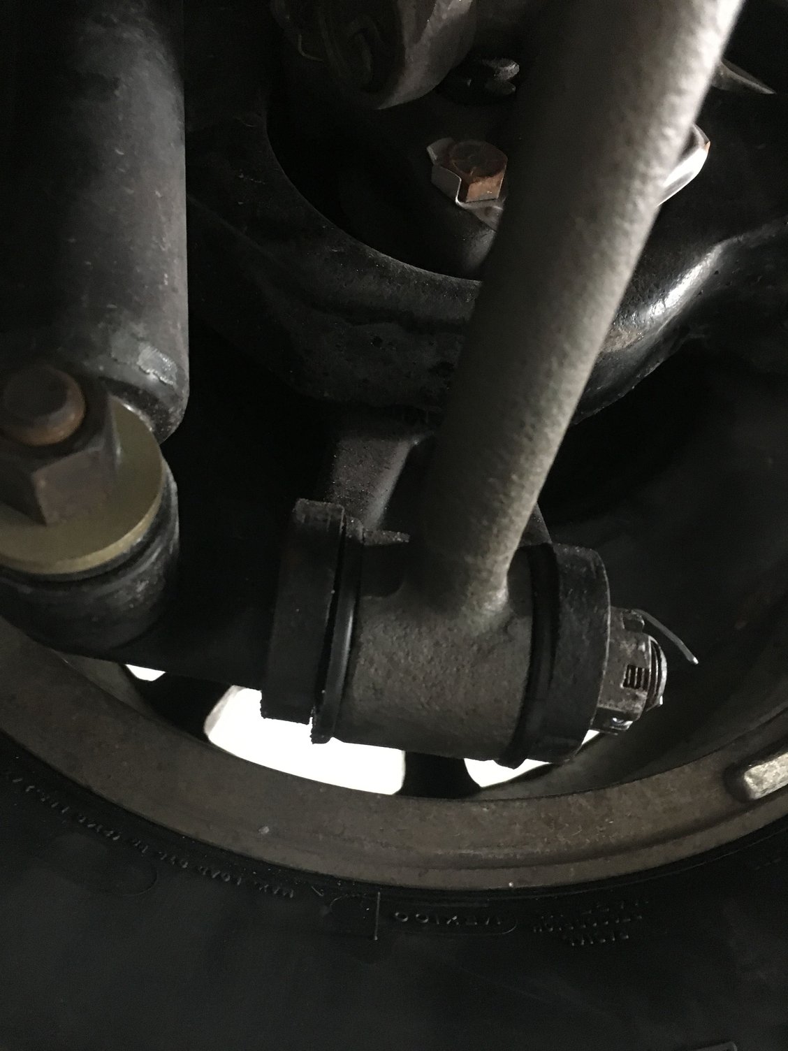

This is why I replaced mine.

Wow! Those are bent bad.
So, is it normal for the ends to look so tweaked to the side? It’s like the brackets were not angled properly.
Any thpught to the rods with heim joints instead of bushings?
