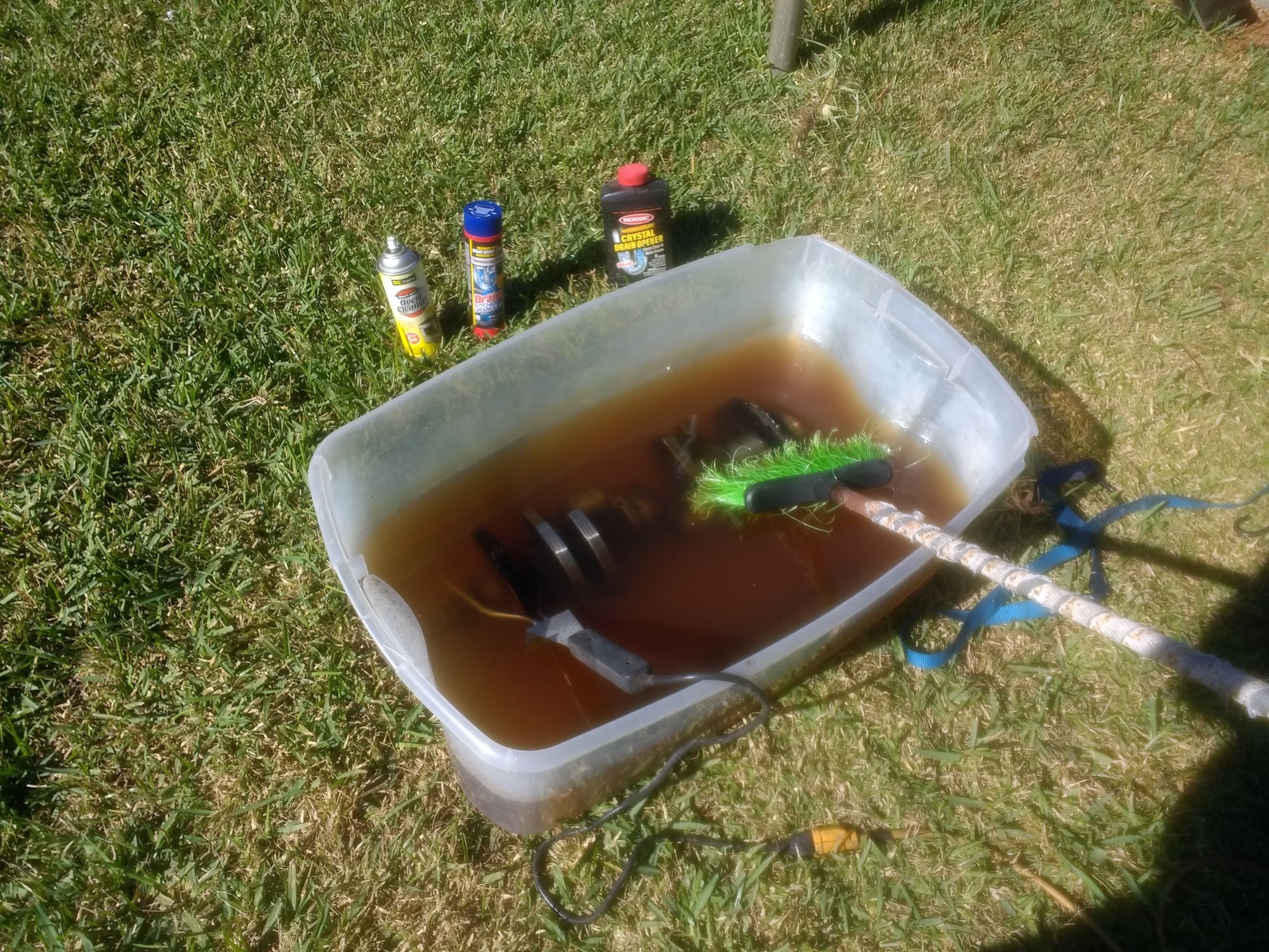

What you have here is your basic backyard redneck engine parts cleaner...

Hey Cleetus thats pretty good,, whats that electric cord for
A. Some type of fish aquarium heater to dissolve grease.
B. Some type of vibrator, perhaps from a sleezy motel bed, to dissolve rust.
C. Car parts 220V anti-theft device when plugged in.
D. A homemade ultrasound gizmo to check for fractures.
E. Demagnetizer for release of iron oxidizing.
that there's for the water heater I use that in my grill to to light the charcoal..

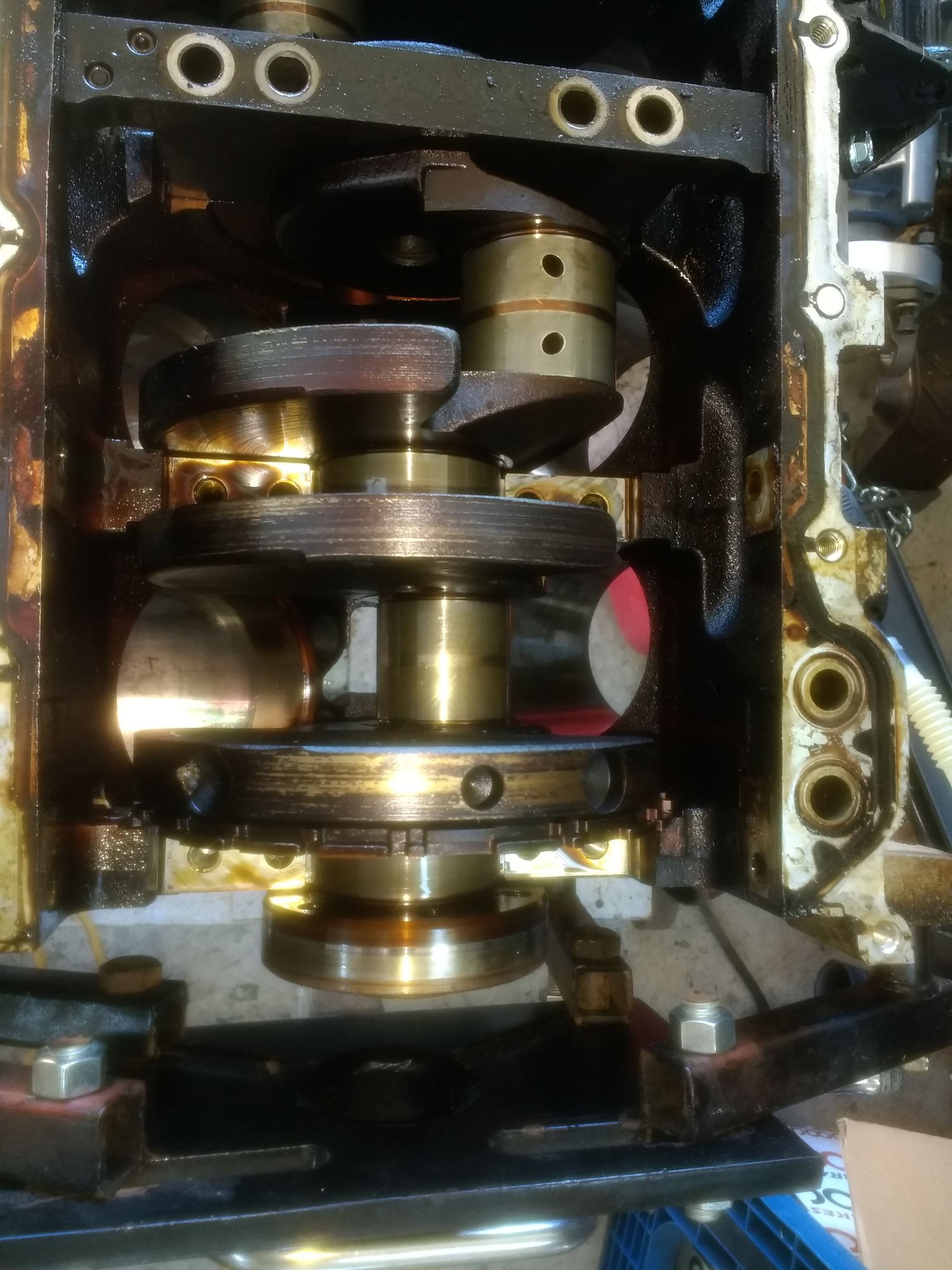

Default ironically it works

Looks clean but the journals don't have the shiny chrome look to them anymore. Almost looks like the harden finish was removed.

Yeah, I know what you mean, but they looked like that prior to soaking. I don't think the previous owner ever changed oil. I suspected it was aluminum from the bearing, partly why I decided to use sodium hydroxide (lye, Drano) because it dissolves aluminum, but no such luck.
2 hours of polishing with 800/1000/1500 grit and it looks ok.

Looks much better.
Be careful or you'll be buying oversize bearing inserts.
