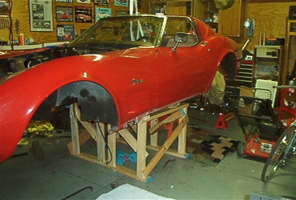

Check out this site
body mount replacement
Unfortunately my frame and rocker channels were not in good shape so I ended up with a lot more work.
