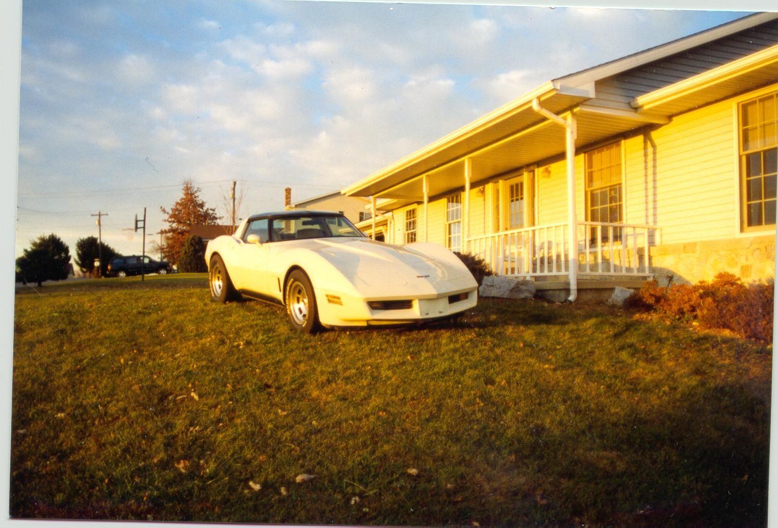

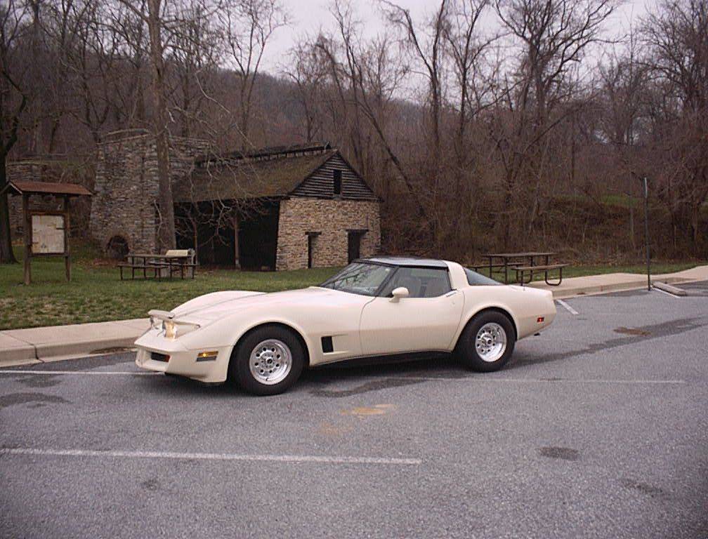

This is an old pic I had when I ran 295 50 15 street tires on the back. I don't think stock wheels would work very well, even though I know a few guys have run them. My Welds are 15x9 and if I could have figured out how to fit 15x10's I would have. The tire looked a little bit pinched on the 9, which is why I would have preferred 10's. I also am running offset T-arms which allow for a wider tire in the 15 inch size. If you are running a stock T-arm, then the tire bulge may hit the T-arm. 275 60s will fit for sure. Here's apic with 275 60's on stock wheels.

245-60-15s on the front. 275-60-15s on the rear. Not without rear modifications.
Were the 295’s inside the fender on suspension compression? What was the backspace of those wheels with the 295’s.

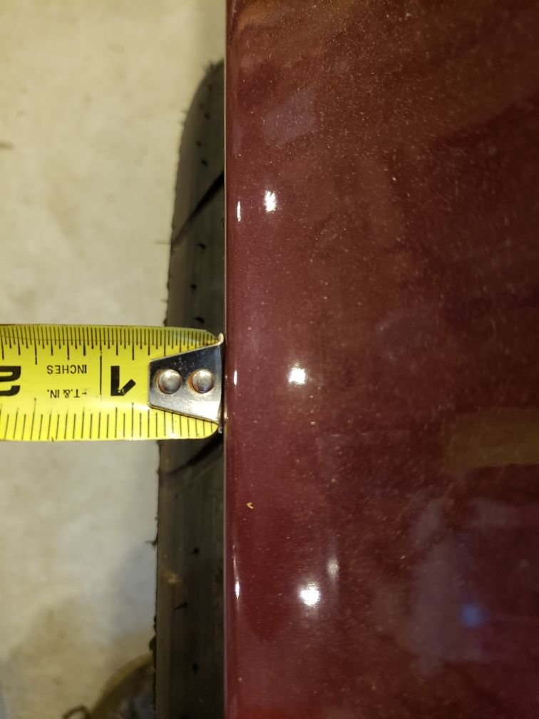

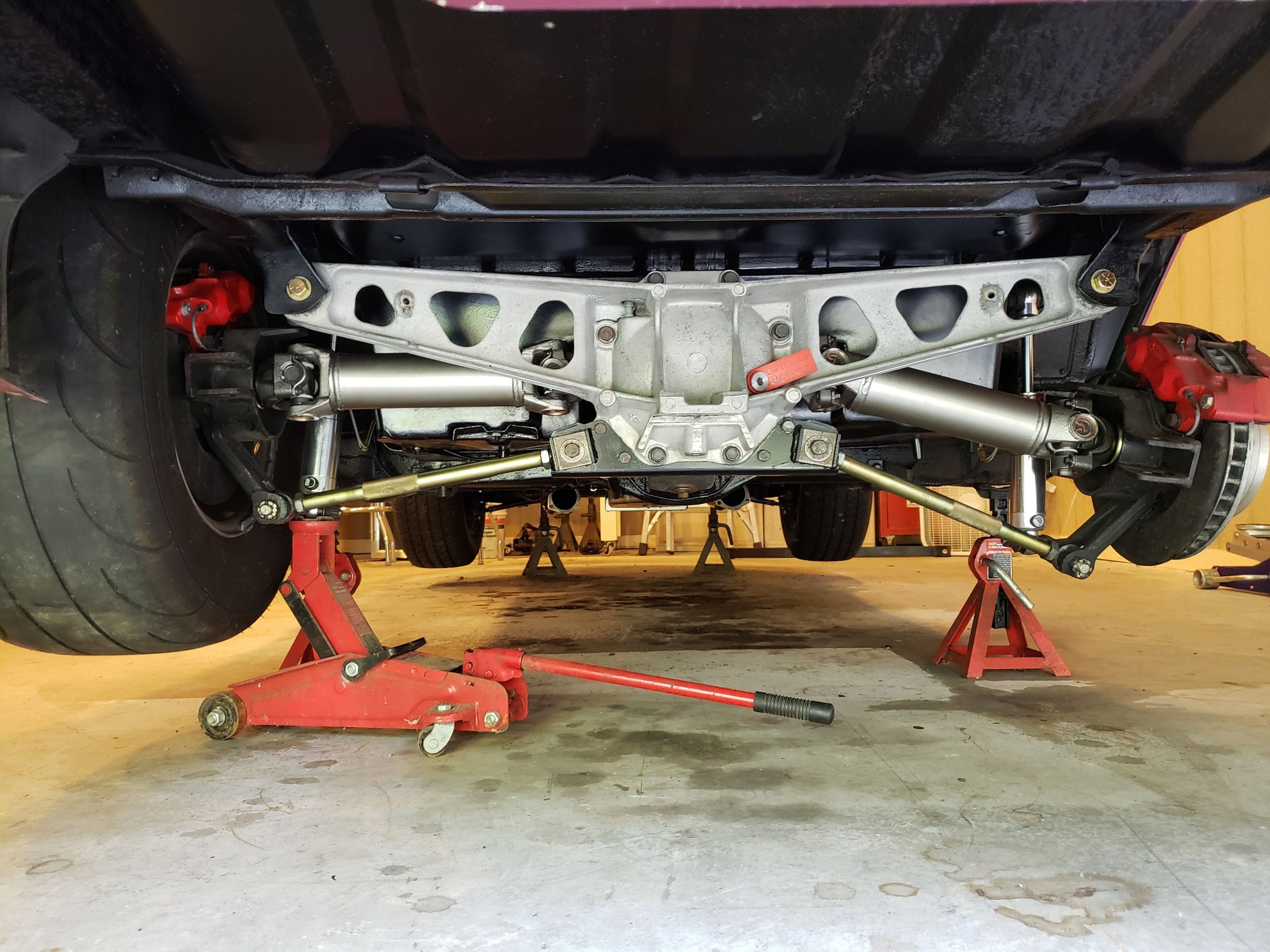

The 295's were on the same Welds I have now. They're 15x9 with 5 1/2 inch backset,...but at the time I was running a VB 1 1/4 inch wheel adaptor, so the effective backset was 4 1/4 inches. I had to do that because of the brake caliper, and the fact that Weld will not make custom offset wheels. The tire did stick out past the fender about 1/2 inch, but never hit the fender in the decade I ran them.
I know this is a bit off the OP question, but will add that I now run 295 55 15 MT drag Radials on the same wheels,.....but because they were a bit wider, and I'm a bit ****,....I recently got thinner wheel adaptors to pull the tries in some. When I had the spring out, I checked full compression and with my new bump stop have an inch clearance between the tire and fender. Even though the tire still only sticks out 1/2 inch, there's no way it will ever hit the fender. This mod required a custom shortened spring and a few tweaks to get it right, so by no means a bolt on deal. But the MT's are huge tires...
Here is a pic showing how far the tire sticks out past the fender. As you can see it's mostly sidewall bulge, not tread that sticks out.
