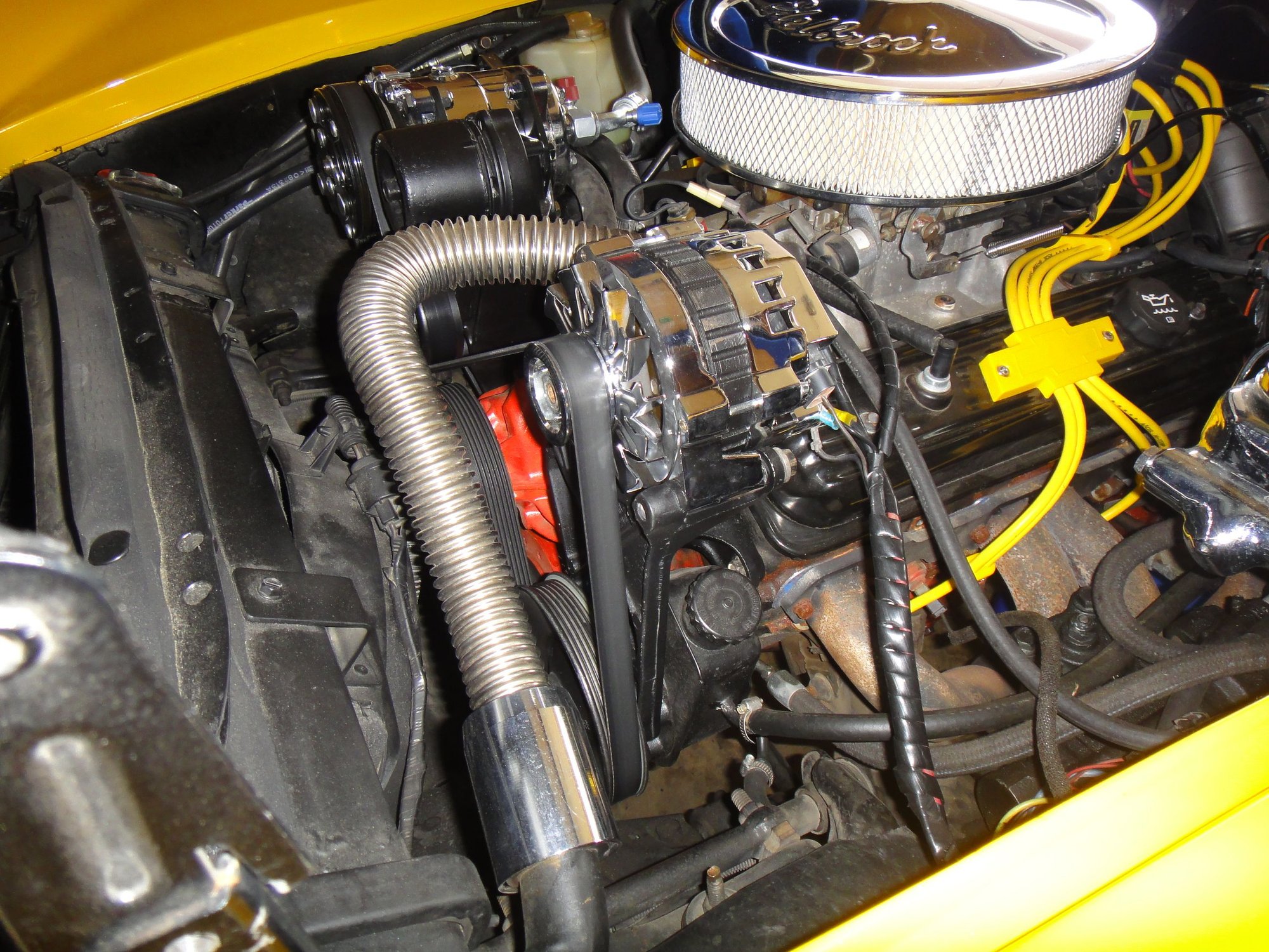

From: Duvall, WA
I used the stainless flexible hose, in black, like you would find at Summit Racing.

I used some SS exhaust tubing 45 º mandrel bent piece

Black S/S Flex was pretty easy to work with also.

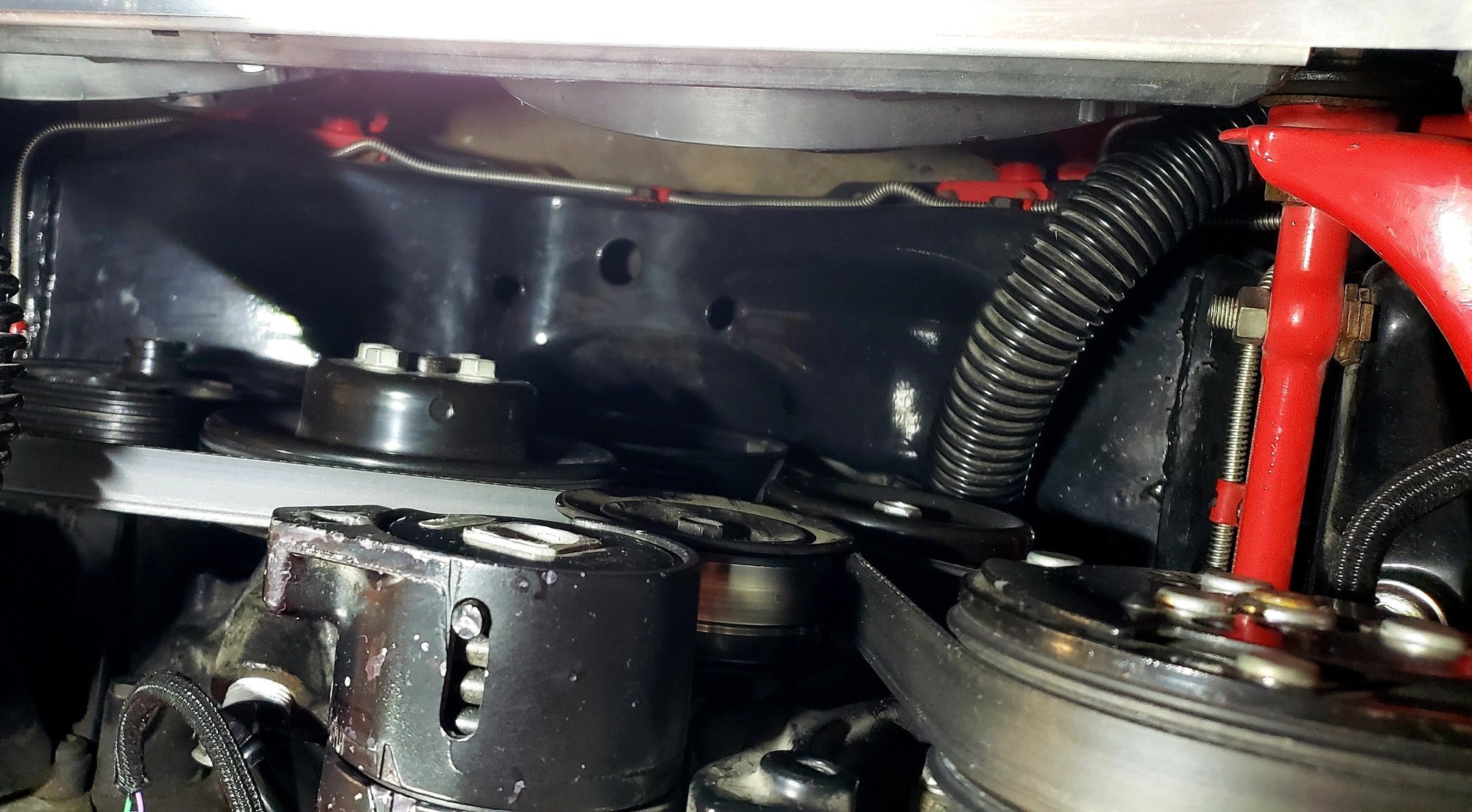

Originally Posted by '75
What lower radiator hose did you use with the GM serpentine set up on your C3?
For the upper hose with a serpentine setup I used one from a 1995 Ford Bronco. Now the upper factory 1995 Ford bronco hose has 1 extra elbow bend at the radiator side that needs to be cut off to fit as in the picture below.
Old Dec 27, 2018 | 10:57 AM
'75's Avatar
'75
Joined: Dec 2007
Posts: 6,422
Likes: 591
From: McHenry Illinois
Here's what I've been using, but going with a new aluminum radiator. I will re-use the top hose set up and probably go with the stainless hose for the bottom also. I was hoping someone had found a reverse rotation water pump with a hose connection like the C3 water pump so the original style lower hose would fit.
That Bronco hose looks good except it wont work with the 75 upper radiator neck that curves to the right instead of straight back like the 77 and later.
