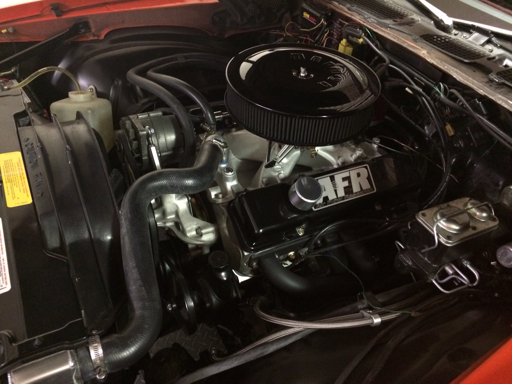

The absolute minimum for a 496, that will still lose SOME power, but manageable.... Is the 2" drop base air cleaner from the LT1/L88 etc etc... All the repro companies sell them. Then run any 3" element. You really need to have a carb with an HP mainbody or mill off the choke horn. This setup gets you about 1" of clearance between the bottom of the lid and the flow bowl vent tubes...Less then that, and you can have problems, not to mention the air flow restriction. That setup cost me about 10 rwhp from running just the base with no filter or lid.
Now I run a 4" filter with the same 2" drop base and the car traps about the same mph as no air filter, downside is you need a big hood to clear it.

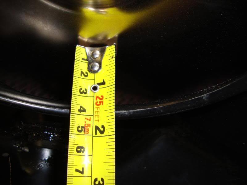

This is with the 3" filter, you can tell its still pretty restricted on actual flow to the carb.
