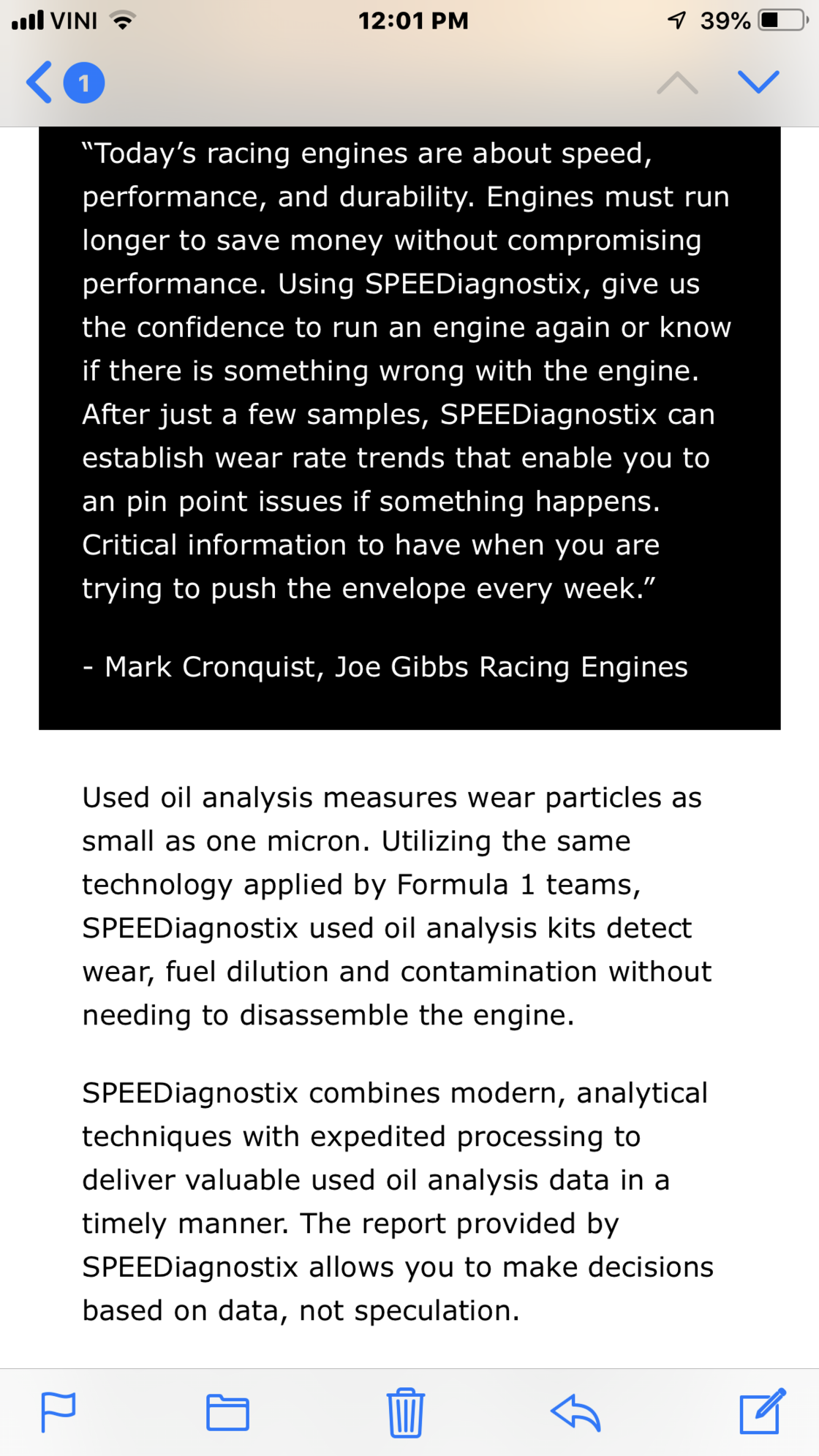

Got this in my email today.. found it interesting
thought I would share it..PD
https://www.speediagnostix.com/racers
Why Oil Analysis for Racers
Just like an engine dyno measures horsepower, used oil analysis measures engine wear without having to disassemble the engine. Utilizing atomic emission spectroscopy, used oil analysis reveals the amount of wear occurring within an engine and reports it in parts per million of each element. As such, increasing levels of tin and lead indicate bearing wear. High levels of aluminum indicate piston scuffing, and each SPEEDiagnostix report provides these details in plain English – no chemistry degree required!
Fortunately, used oil analysis does not stop at indicating wear metals. Used oil analysis also reveals contaminants such as water, coolant, fuel dilution and airborne dirt/sand. Contamination levels provide insight into the effectiveness of both oil and air filters as well as the tune up of the engine. High levels of fuel dilution indicate possible injector or carburetor problems, which are common with Ethanol blended fuels. Again, the SPEEDiagnostix reports highlight and provide guidance related to contamination in plain English.
Finally, used oil analysis provides trend analysis which reveals the “health trend” of the engine. When should the engine be rebuilt? Can the engine run another race? Trend analysis answers these questions and more. Once a normal level of wear and contamination for certain engines has been established, it becomes easy to spot potential problems early on before they become much bigger problems. Catching problems early saves time and money.
