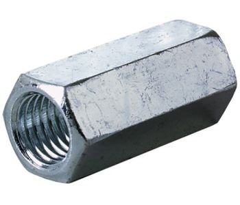

I extended the 2 front mounting bolts with a coupling nut. Did not have to do anything to the rear bolt.
Do you do this only to carry the flat? What do you do to take up the extra space in the carrier when you carry the spare?

You can get the spare tire bolts in a variety of lengths, these are listed as '64-'67 and should fit in the cross member in place of the bolts you have.
https://www.ebay.com/itm/Original-64...del%3ACorvette
If you unscrew one of the bolts you have you may find that they actually have a couple inches of unexposed thread so they can be unscrewed to allow room for a 255/60. If your bolts do have extra thread on them, just install a correct sized nut on the bolt before screwing it into the cross member or just carry them inside the car. If you can (and need to) lower the stock bolts, unscrew them, install the nuts on the end of the bolts (leaving enough threads to secure the bolt into the cross member) then use them to lock the bolts into the cross member. Probably a task you'll want to rehearse before you need to do it for real, but it can be done.

Drwet, your premise was that the tire was flat, therefore you are loading your rim in the spare tub. These rims are wider than the spare rim. You need to spin the bolt (front bolt with the spare tire lock) all the way down enough to catch the slot. That will get you home.
Now if you want to always carry a regular wide 255/60/15 in there you might need to buy 2 longer bolts (as Gusto pictured) and always have that the lock bolt spun all the way down. It will look like this (not mine). Myself, I would rather have the smaller spare:

So this is what I've learned about my car after crawling around under it and experimenting for a few days: The 235-60R15 tire will fit in the spare tire carrier if it is fully deflated, and the front carrier bolts are backed out as far as possible. (About 3/4" is what I could get.) 11/16" (for the lock nut) and 3/4" (for the head) open end wrenches are what's required. Also in order to get the tire in the tub, I had to jack up the car and turn in the rear carrier bolt as far as it would go. Doing that, I can just barely get the tire in the tub. I also packed a large garbage bag. I'm thinking if I were to get a flat when I don't have the back of the car full of luggage, it would be easier to throw the tire in a bag and put it inside the car. Hope this helps someone.
