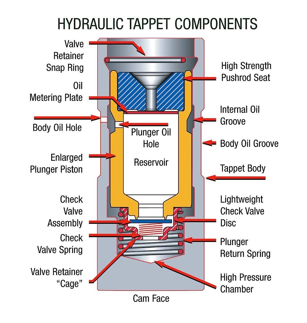

Oil enters the internal of the lifter and it needs the metering plate to control the amount of oil bled off to the rocker but still have enough of the pressurized oil to fill the space in the lower section of the lifter. The hole in the side of the lifter body used to fill the lifter with oil and the hole to the push rod without the metering disc are close to the same size, wont leave much oil to fill the lower section of the lifter.
the metering disc needs to be in there, don't know for sure this is the issue but if there is a noticeable difference in the amount of oil getting to this one rocker and this lifter is the one making noise then it would be the first place I would look.

Old Jan 8, 2019 | 07:41 PM
