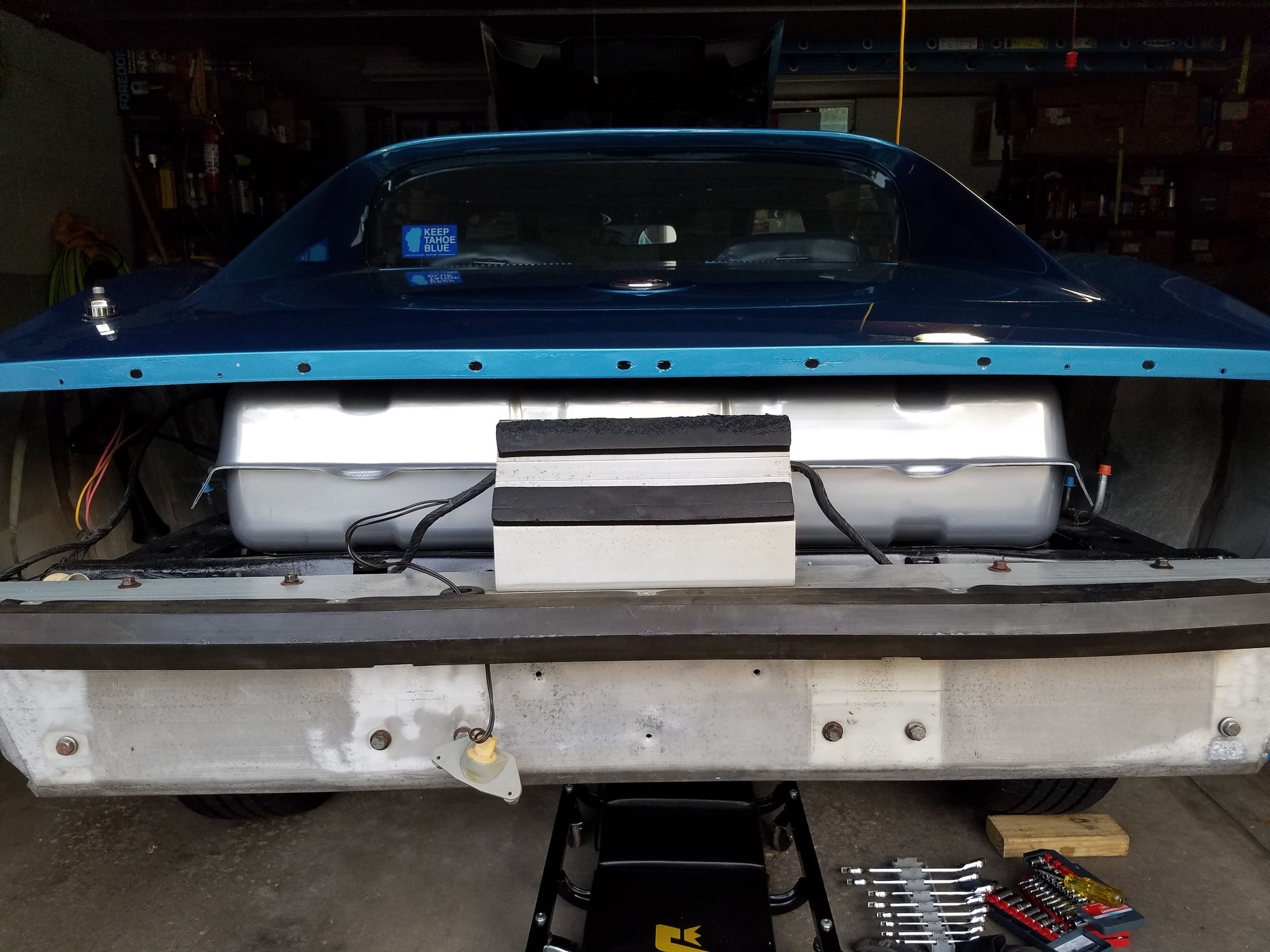

Dry fitting the EFI tank. I am going to use the Fuel tank Shield GT-319 when I permanently install the tank.
Perfect fit!
Great information from Justin. I just dry fit my tank and neck assembly yesterday.

Good info. I have a 75 as the base for my project and a Tanks EFI tank made for the 74 and earlier.
Always looking for ideas.
Thanks
