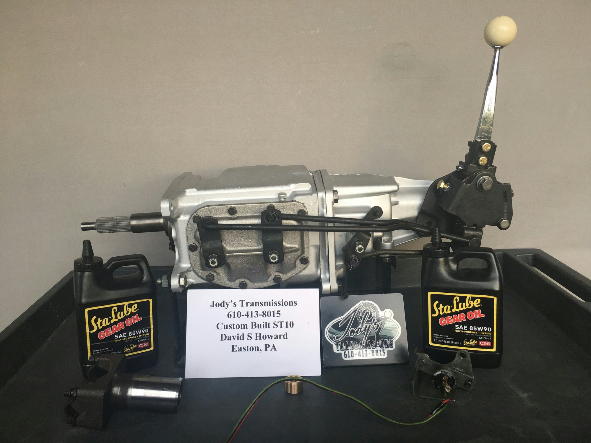

Here's a photo from another thread on this site (not my photo).
The "plates", the lever arms between the shifter linkages and the transmission, are held on by bolts. These were loose in my car, with the reverse gear loose to the point that the notch in the lever was no longer fully engaged. I tightened the bolts, with the lever slots aligned, and that cleared up some of the loose shifting. Adding a "Pit Pack" replaced the bushings between the shift linkages (rods) and the lever arm plates on the transmission.
