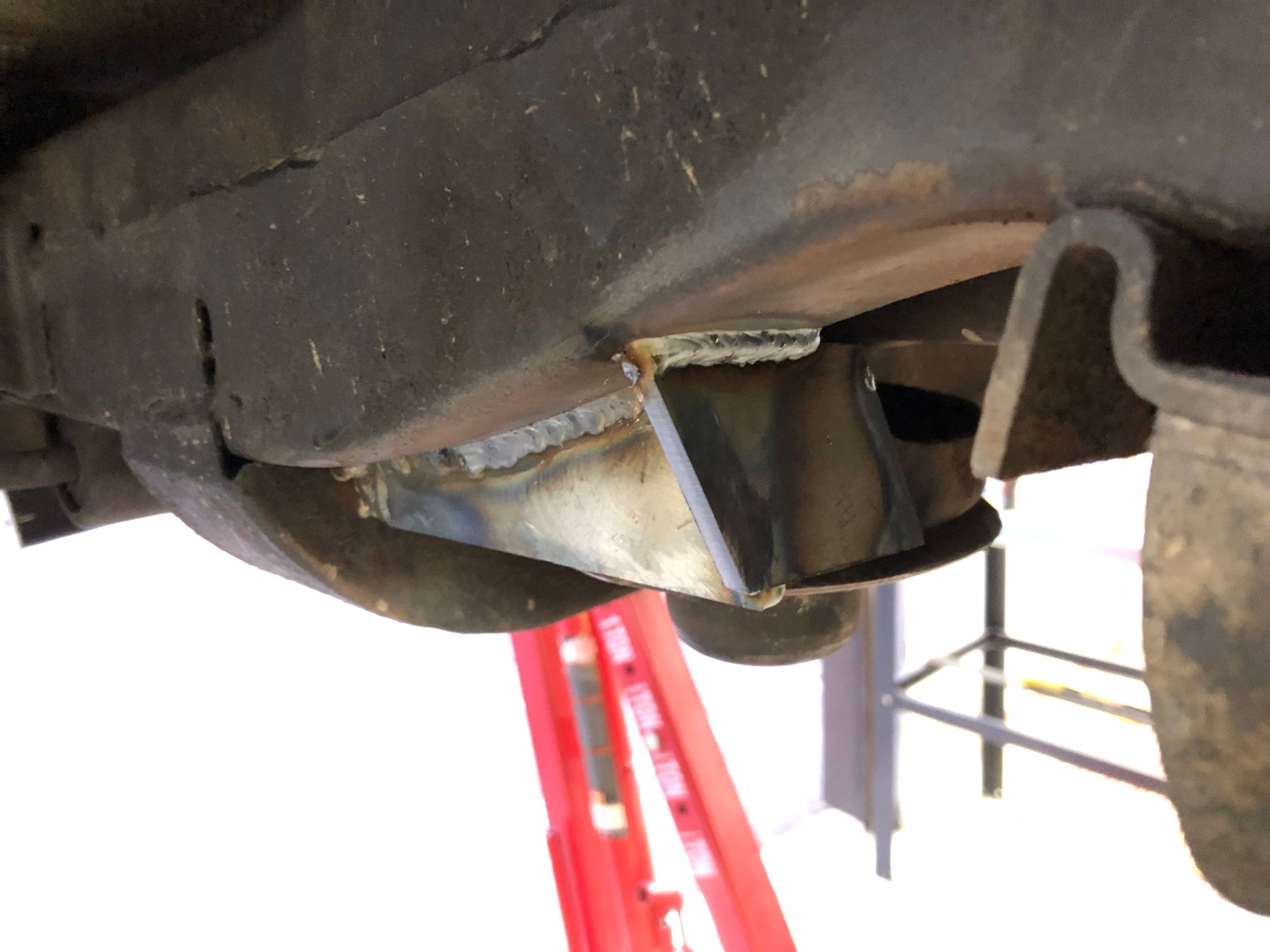

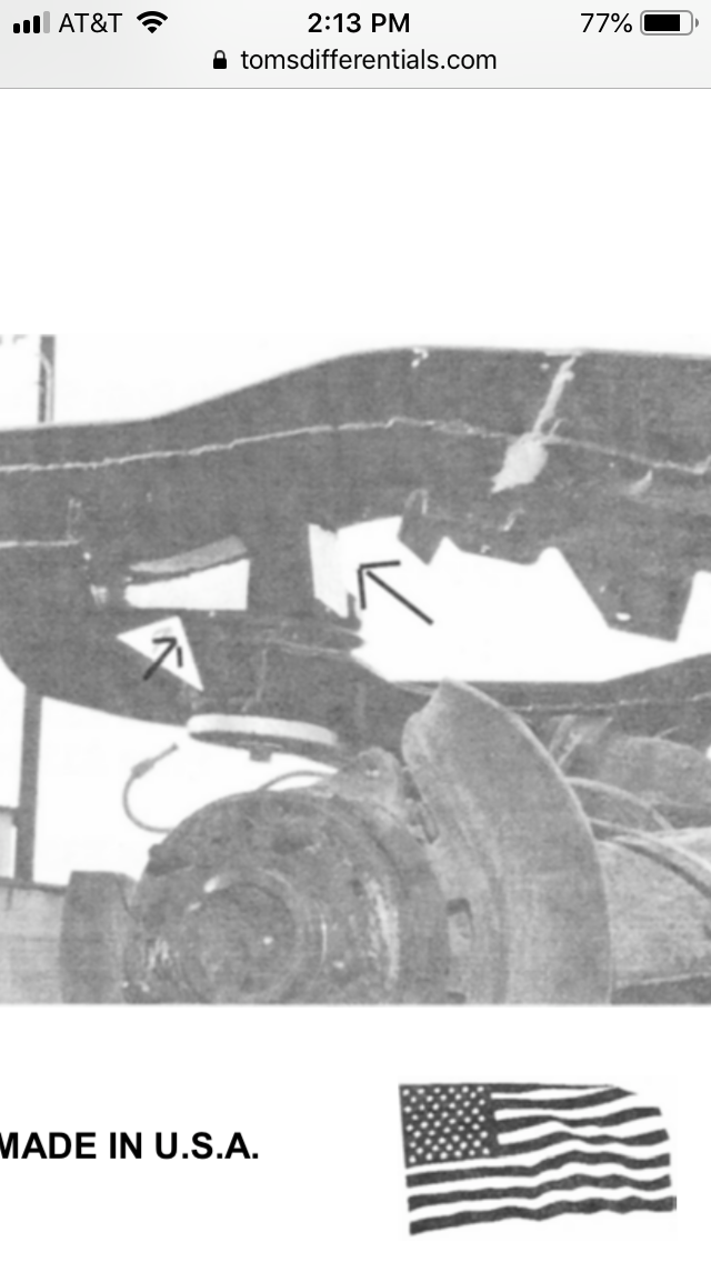

I have Tom's Frame Reinforcers that I am looking to weld in place and I wondered if anyone has pictures of how they installed them? The pictures on Tom's website are not that clear. It seems like I would need to trim a bunch off of the plates before welding them in place in order for them to install as pictured. Thank you.

Yes that’s great, thank you. That is how I was thinking of doing it, but it didn’t seem to match the photo from Tom’s page.

Well I had searched for it without any luck, both with google and on the forum, so thank you. I got them installed today.

Thank you, I am running the diff raised and mounted solid. That is why I wanted to install these gussets. I am hoping I don’t need to do anything more, but I know the kick up area is a weak point.
