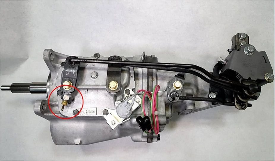

This is interesting. I cleaned the grease and debris out of the shifter. I stoned all of the moving parts and reassembled the shifter with no lube. I made the 1/16 by .644 gage plate and adjusted the shift rods. It works very well now. On the munice 4 speed, there is a pipe tapped hole under the 3-4 shifter shaft on the trans. This I think is the neutral safety switch. I have had a number of hurst shifters in other cars, and I am used to the shifter handle being spring loaded. If no spring is required, I will learn to deal with it. Or I will fab a piece of spring steel and install it to create the feel I am used to. So... if the safety switch is in the clutch pedal...what is the pipe tapped hole used for? What goes in it?

I found a picture

Ken, if you are asking about the sensor/switch in the circle below, I believe it is part of the Emissions Control System incorporated in some of these cars.
You will find quite an extensive discussion of the different systems and how they interact in this post... https://www.corvetteforum.com/forums...spark-tcs.html There is a good picture of it in post #6 (Transmission sensor/switch).
My '73 also has this switch, but the TCS/CEC is not installed on my car so it is not connected to anything.

it controls vacuum advance to the distributor, advance will only occur in 4th gear.

The part with the pink & green wires it the backup light switch.
Is that what you're talking about?
