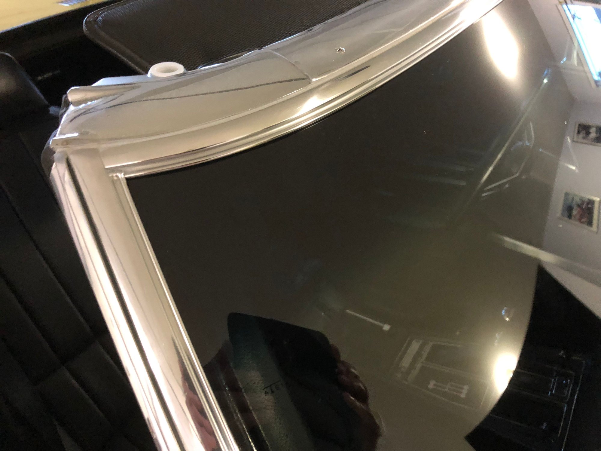

After I installed the glass with the help of my wife on one side, I used VersaChem Mega Grey OEM Import Gasket Maker to seal the long line between the stainless windshield trim and upper header or T-trim. It is the closest thing I have ever seen to stock and was easy. My gaps turned out perfect with 3/8 tall by 1/4 wide dam strip. Just plan it out, think about it and it will work. All that trim below is original 1969. In the bottom pic I used 1/4" spacers (white) sticking up at each top corner because in 69 the bottom support clip was off center and would allow the drivers side to sag before it dried if you replaced the windshield. I think GM put a clip on the firewall on the drivers side to prevent this in 70 or 71.

WOW how did your trim to shine like that? that's a perfect fit. So you put a sealer between the glass trim and the t top trim. I didn't know it went that way. If I could get mine 1/2 that good id be happy. I seen both of those vids. looks simple enough. But I'm sure I can screw it up if I try hard enough.
thanks guys
