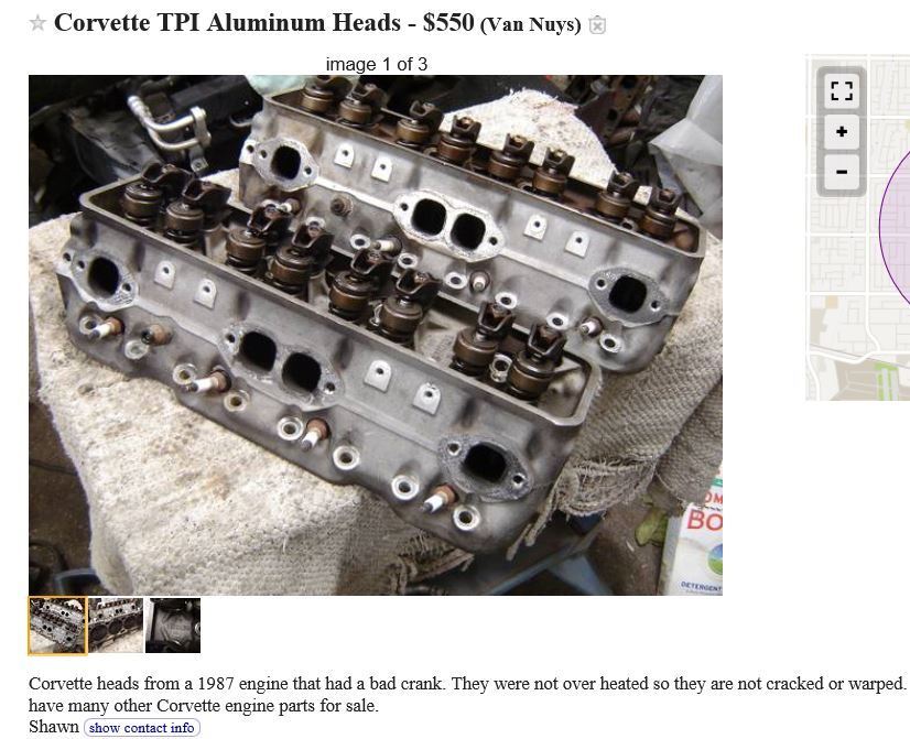

The L98 heads, because they have small 58cc combustion chambers, work really well with a stock, dished piston L48. Add the cam, an Edelbrock Performer (regular, not the RPM), headers and a Holley 650 Carb and you will be good to go, without touching the bottom end. Don't forget new lifters, if you get a new cam. My L48 motor, really woke up, with this combo. It was plenty fast, pulled hard all the way through the 1/4 mile at the drag strip (low 14's) and had 175-180 pounds of compression on the cylinders. I picked an RV-Marine-4x4 cam, because for a mild build, torque is more important than absolute horsepower, especially at the bottom end of the RPM range, where you want it to kick you in the butt when it takes off.
