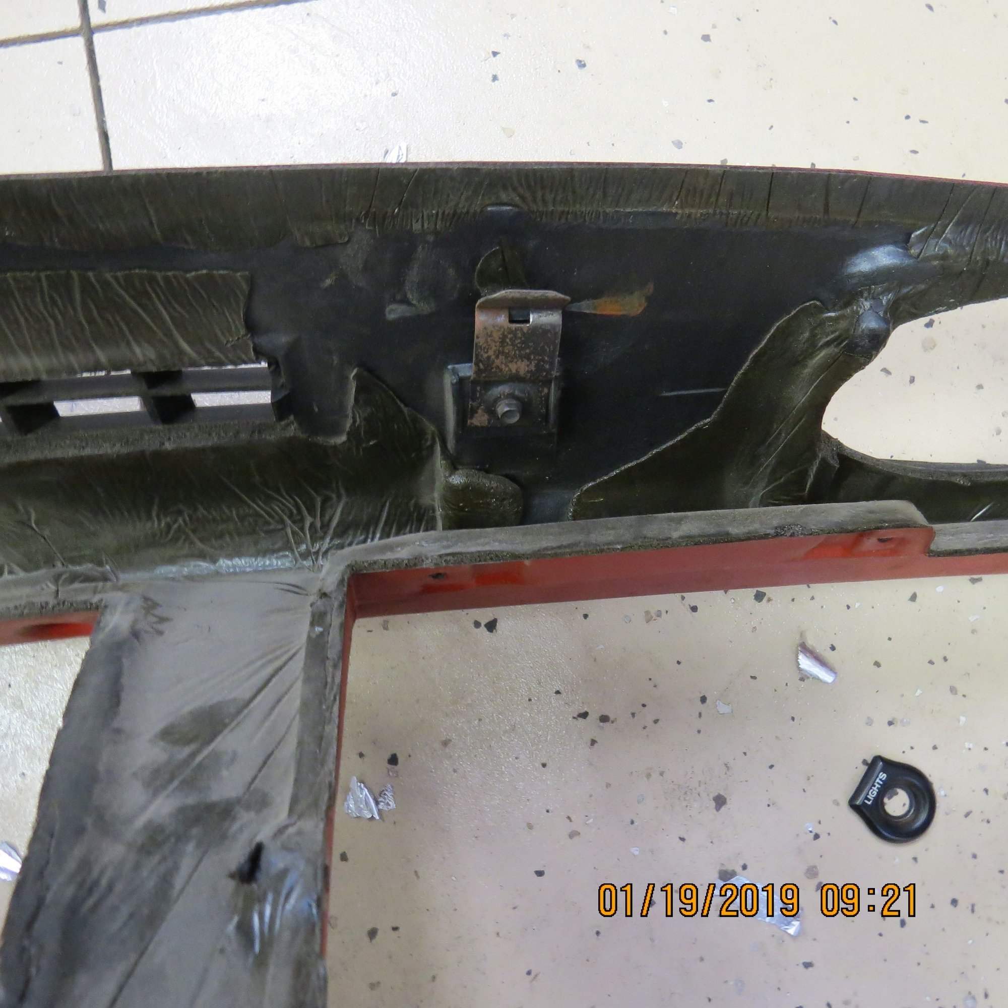

The clip screws in from the back side and clips forward. I'm not sure if you can tell from this picture but I hope it helps.

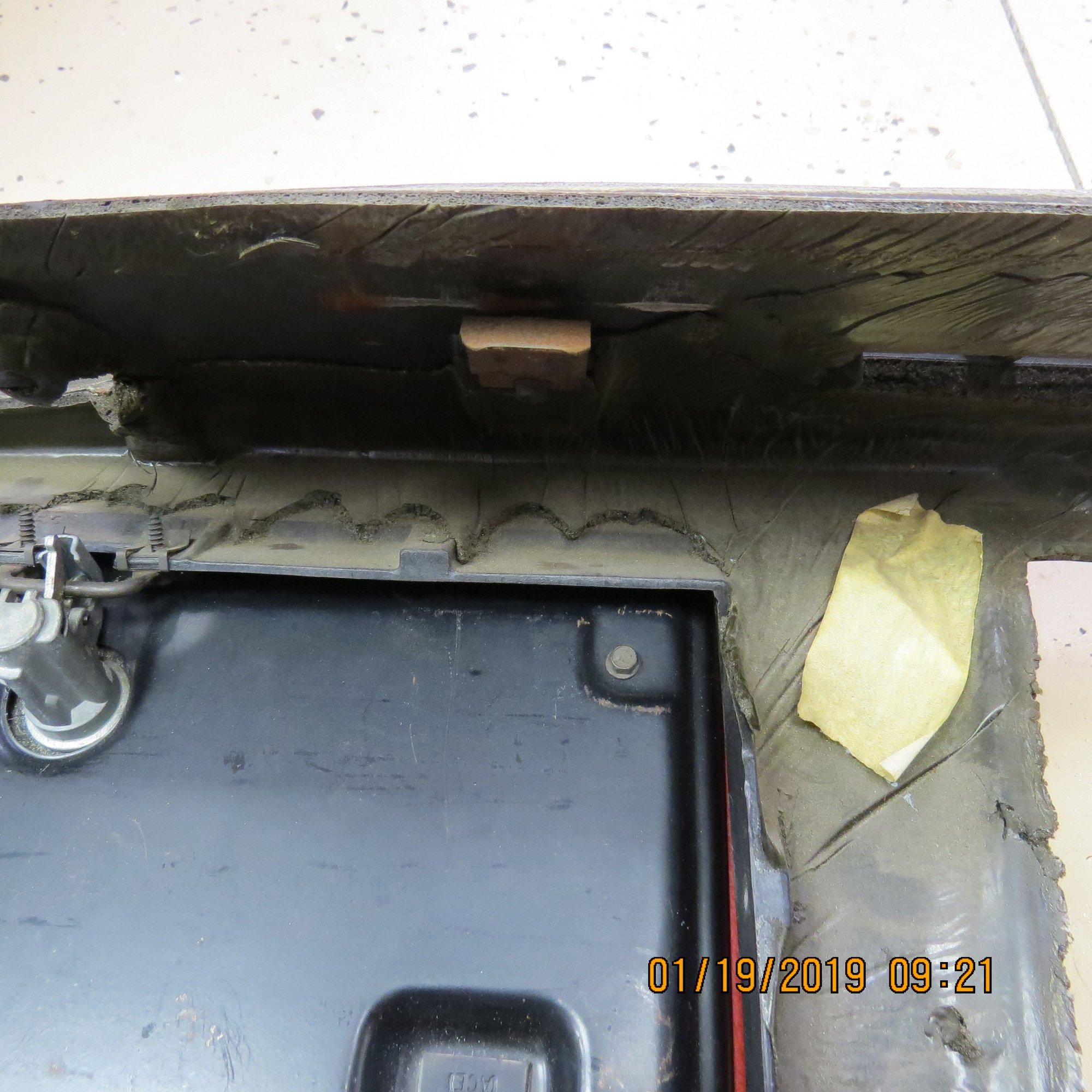

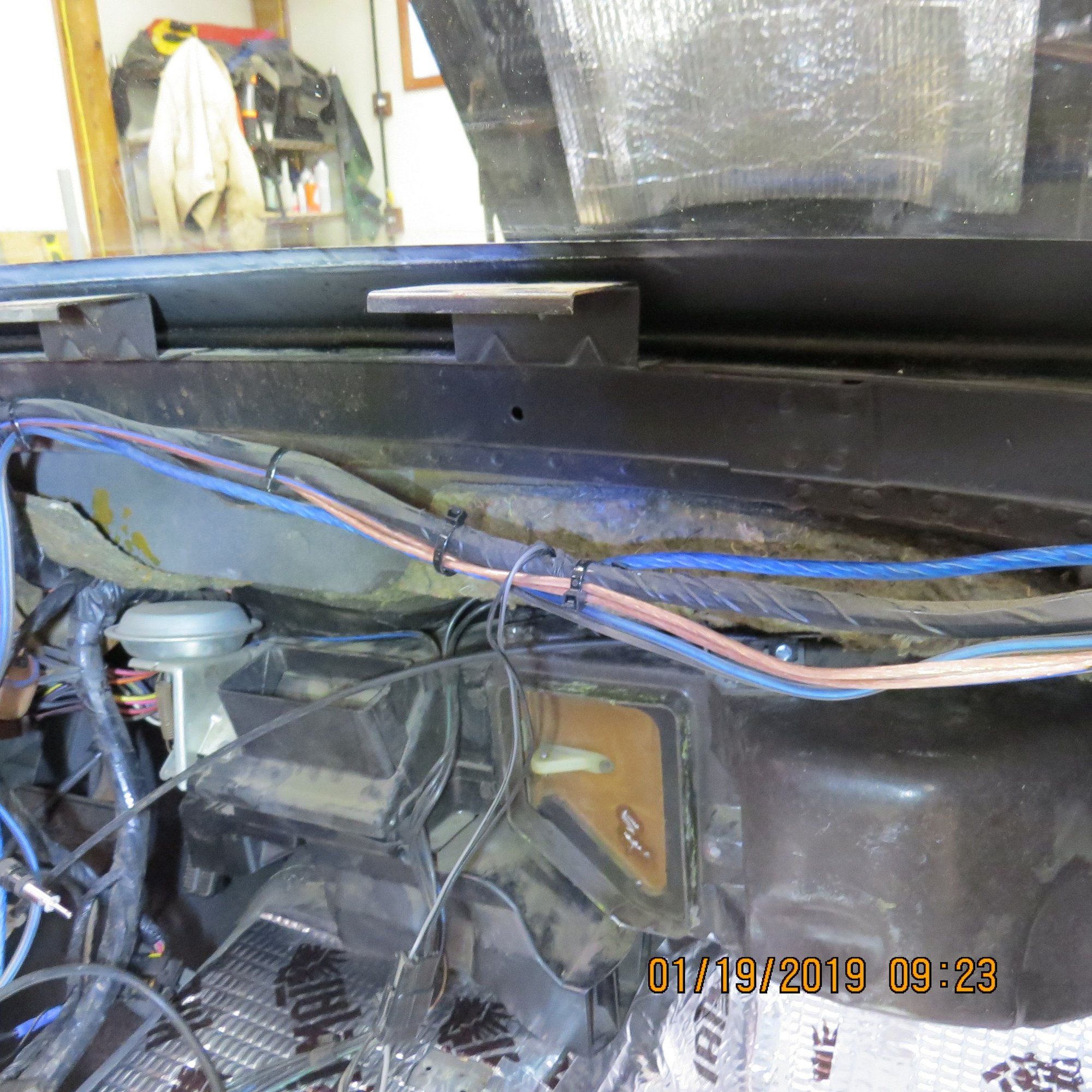

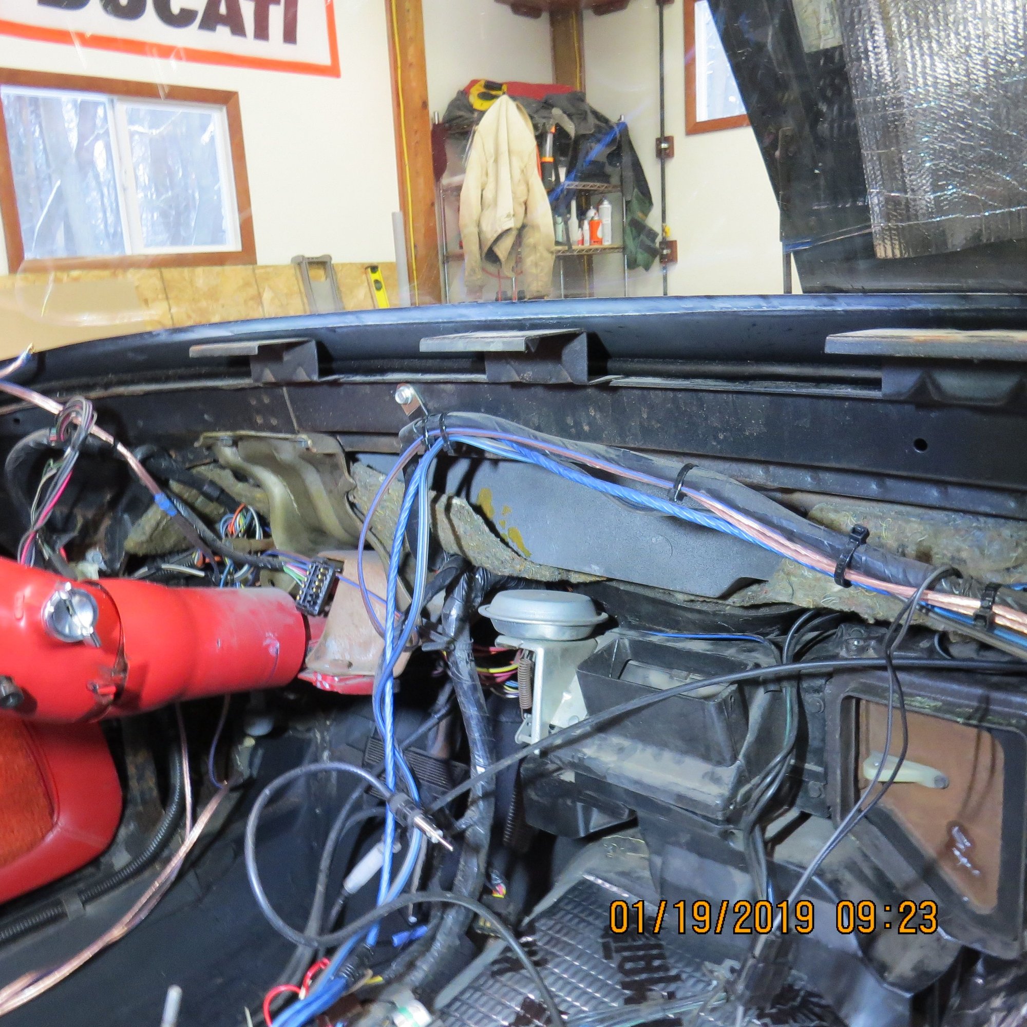

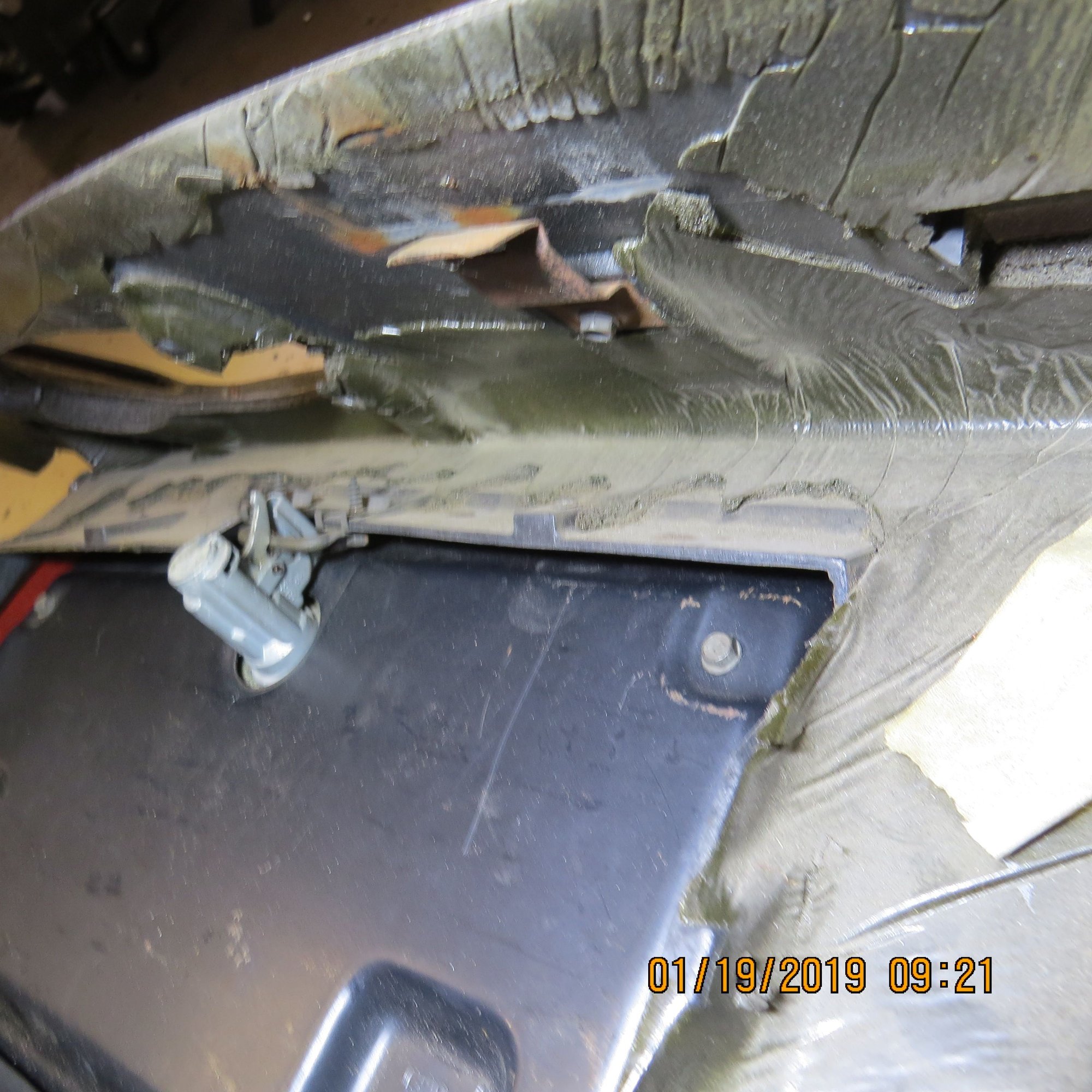

Hope this helps. Gil

Thanks guys I can now proceed building this dash pad.
