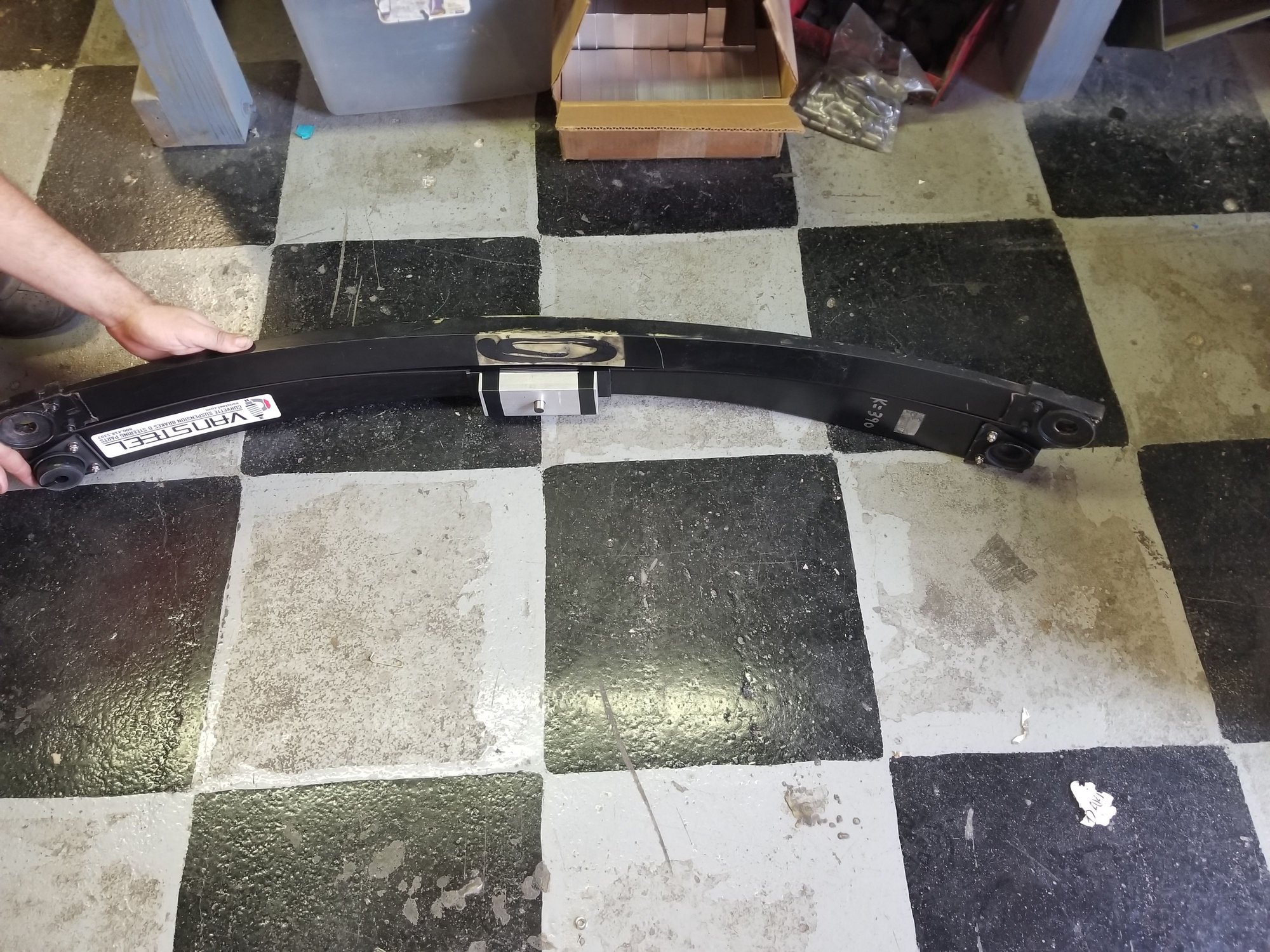

I recently swapped in 4.11 gears and at the same time moved my rear tires in a half inch, which required a shortened spring. The new spring is 440 lbs, the old was 360, so naturally the rear now sits higher.... I haven't topped off the gas tank or driven it much at all since the work was done, and now that it's snowing......I have time to gather parts for spring. Right now I have the 8 inch bolts, adjusted almost all the way down, and am wanting to drop the rear another half inch, maybe a little more, so ideally a nine inch bolt should work. In looking for that,......like hunting for skipe,.....no can find. Alternate solution C-4, C-x 10 inch bolts, then cut the unneeded thread off.
Anybody know of another option? I tried Fastenal, McMasters,....etc. Forget the big box stores...I don't trust picture hangers you get from there.
This is just a mock up I did to get an accurate measurement prior to ordering the custom Van Steel spring.

My 440 lb composite spring was made by Van Steel, as VB&P is no more. The old spring was VB's 360 lb, and I was using 8 inch bolts. On the floor placed on top of each other the springs looked very similar in arch, except the 440 was shorter per my request. This pic was taken at Van Steels shop when we were trying to coordinate my new spring. I sent him my old spring marked where I thought I needed the new spring shortened to. The difference in ride height with the bolts adjusted about the same as originally is only 1/2 inch,likely due to the increased spring rate....but the 8 inch bolts just won't make it. Needed to go a bit longer.

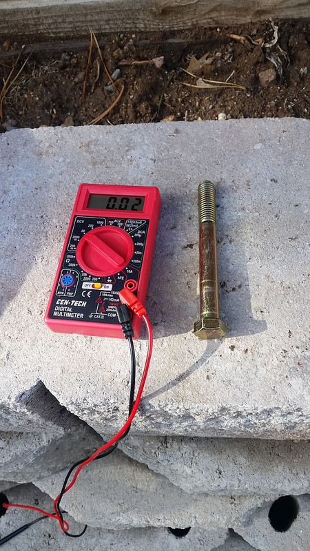

this is my removed spring bolt from a VB&P 420# which I bought at the nut and bolt store.
