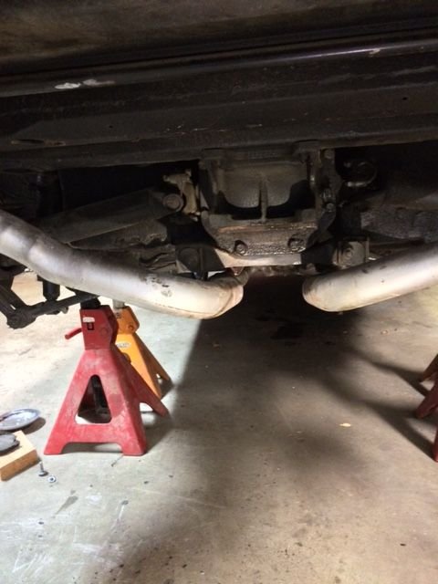

Well the rubber bushings arrived late

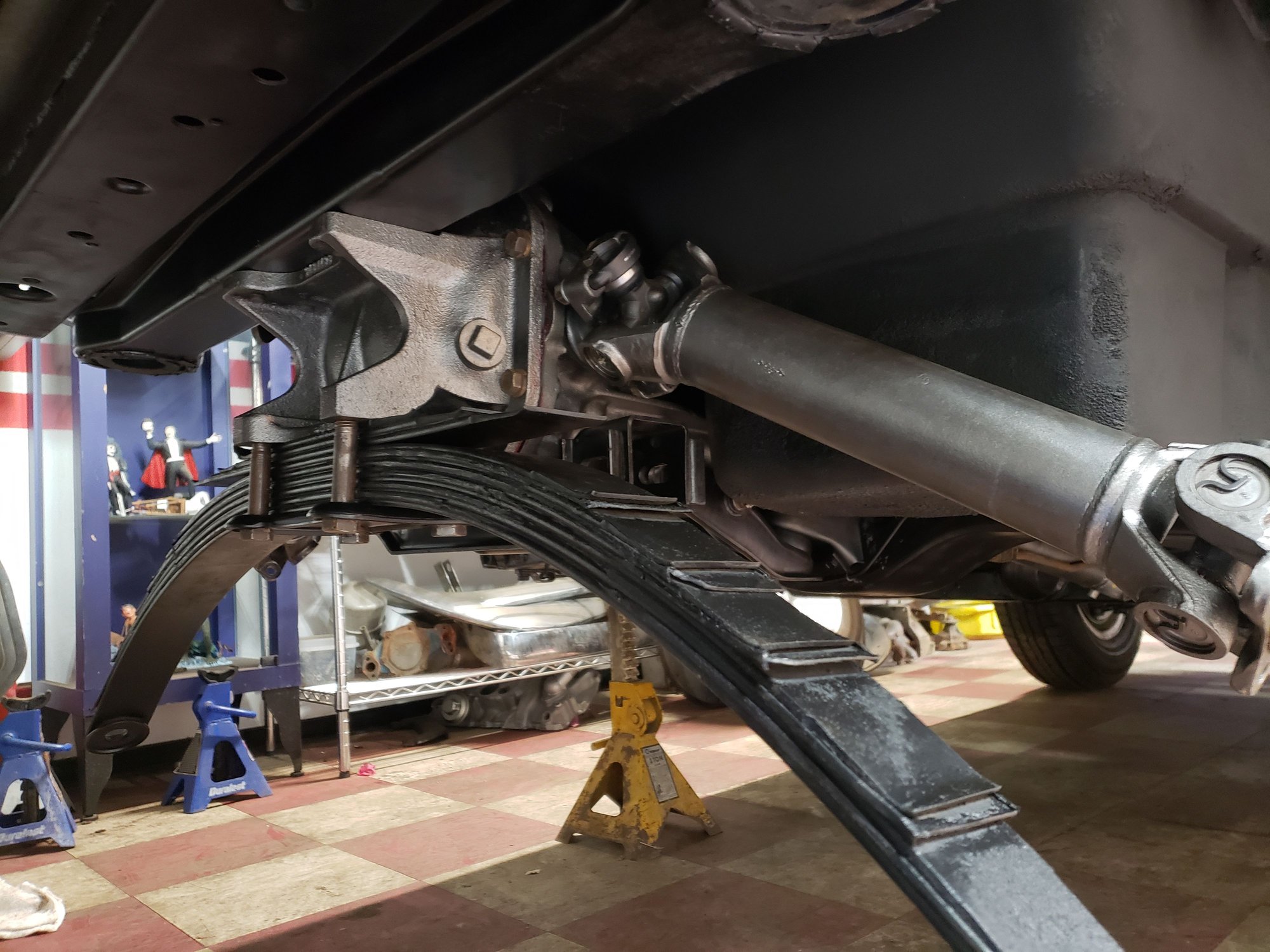

today to rebuild the parts when I remove my differential to replace a loose C clip on the end of one side yoke. No point in putting the 50 year old rubber parts back on. In about a half hour I got the spare tire carrier and leaf spring off, then called it quits for the day. Hope all goes as smoothly tomorrow with no frozen bolts or problems. Everything gets polished and painted before re-installing, so I can take my time. Hopefully this is the last under-car job I need to do.

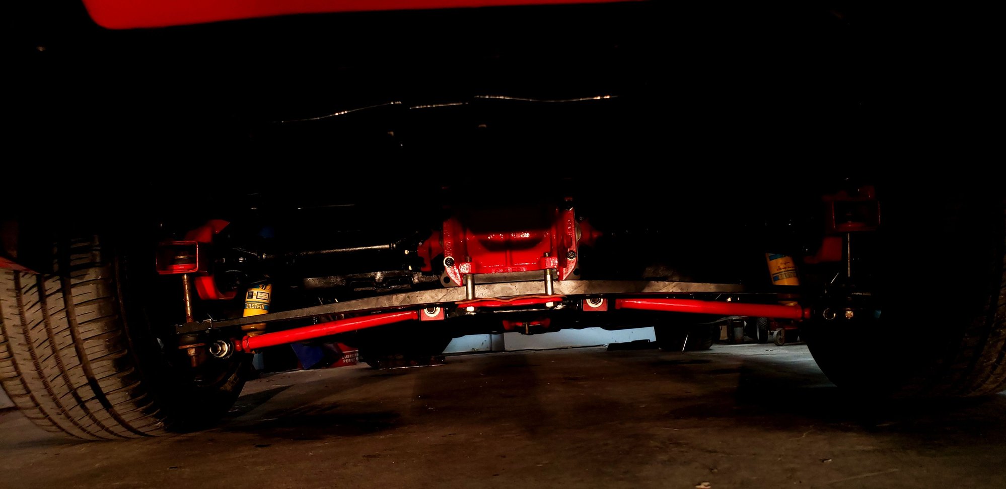

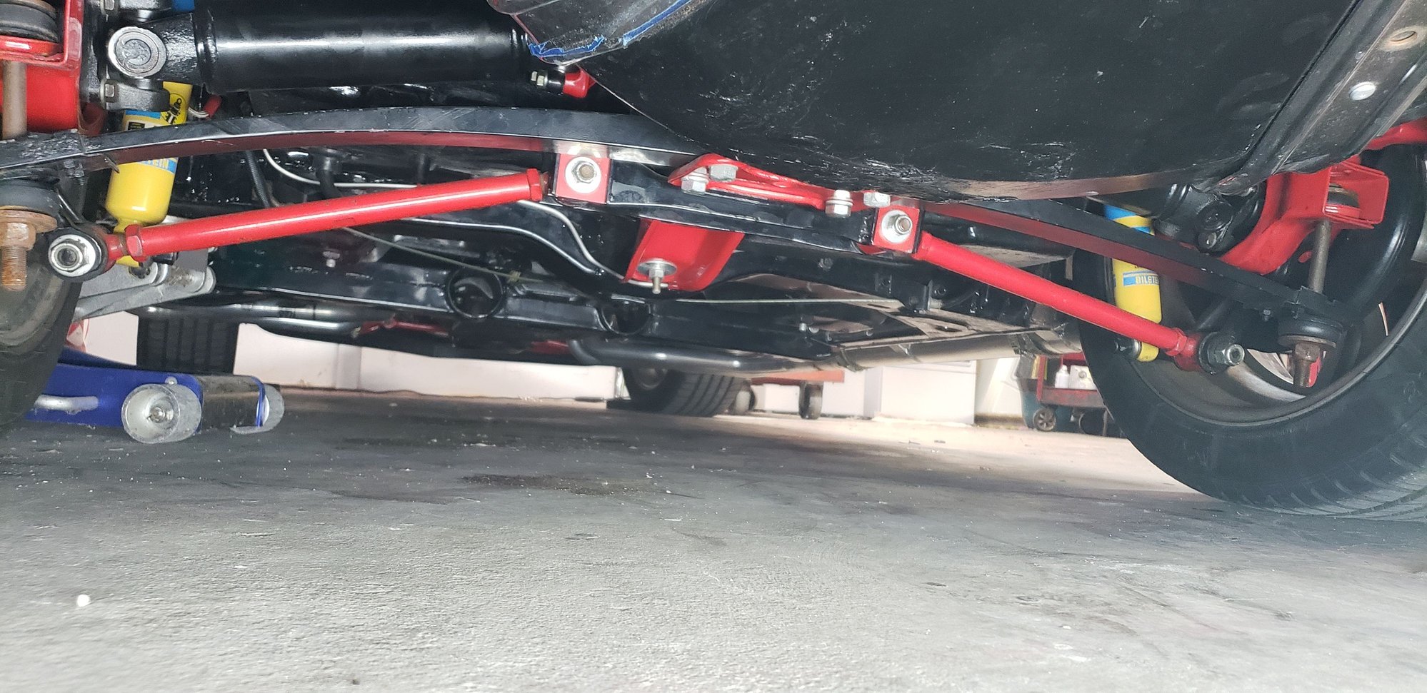

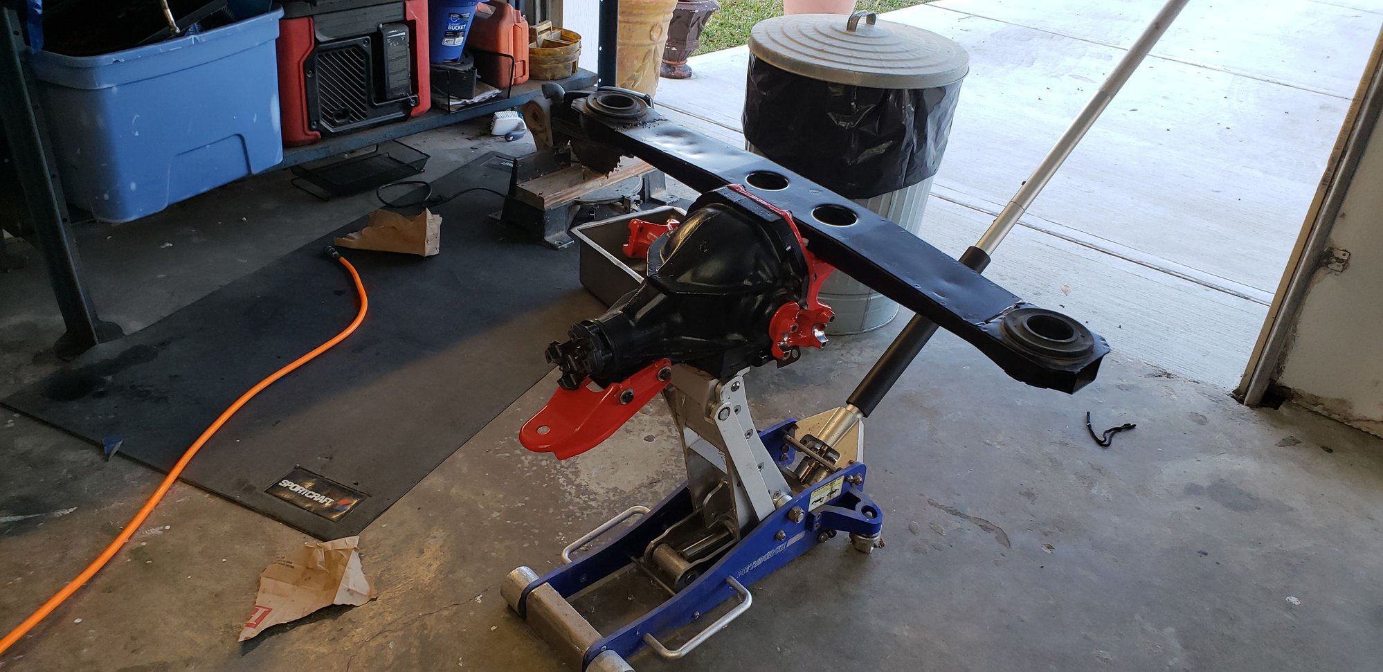

Must be something in the air. I finished my install last night and just test drove it a while ago.A few months ago the rear couldn't be aligned due to excessive play on one yoke. Turned out that the clutch pack was toast! all bearings races and seals were replaced too.Since I was there already I went ahead and replaced my greasable Moog U joints to Spicer Solids. ..Good luck on your install!

redcruz1120- nice looking job on your diff. I was going to repaint most of my parts black and the diff case aluminum/silver. The red looks much nicer.

Thank You ronarndt . I painted the black on the housing myself but I sent the cover out to powdercoat shop along with other parts,
