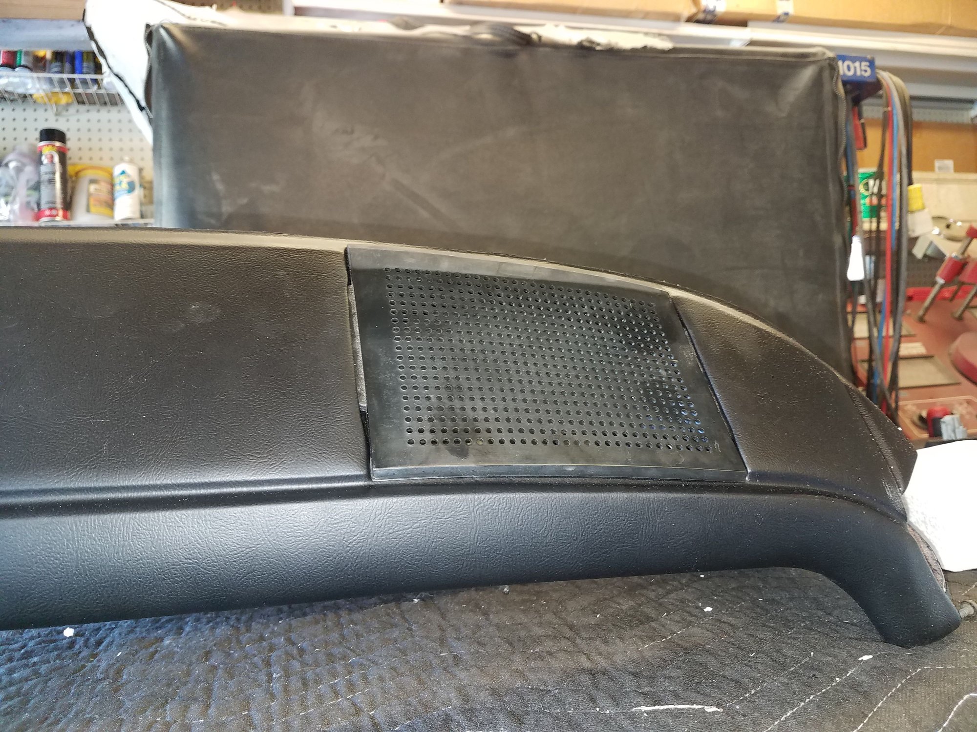

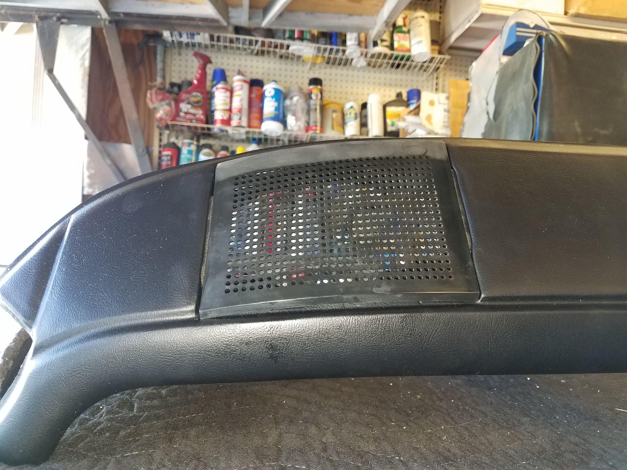

Bird is having exactly the same issues that I am having. That dash is not seated properly it needs to go further back in but the opening is too small and to try heat it over such a large span is asking a lot, odds are it will come out all wavy and look a mess. The wiper escutcheon is the same and my speaker grills were doing the same thing. I took a broad flat chisel, heated it with a heat gun and try to deepen the slots that the grill fits into. The chisel was really hot but I had very limited success getting the grills to sit flat. How hot are you supposed to go 200 deg 300deg who can tell us. It wouldn’t take much to go too hot and wreck a $500 dash. At the end of the day the tooling for these is wrong or the manufacturing process is allowing to much shrinkage. I still blame the manufacturers as they know what the dimensions need to be so what is the big deal, at least get the majority of them correct and sell a decent product. Had my rant but this is so frustrating and the dash is a major part of our cars appearance.

Again I think the speaker issue could be solved by heating it to a point where the vinyl gets soft, then push the grill in place and slap some cold to it.
Willcox
Nope. Doug and I did this several times with a heat gun and wet rag. It seems to hit some backing, and just won't go further. I have spare speaker grills, so I'm thinking trim the tabs and try again.
We had success doing this to all the components, but them grills just won't go in.
