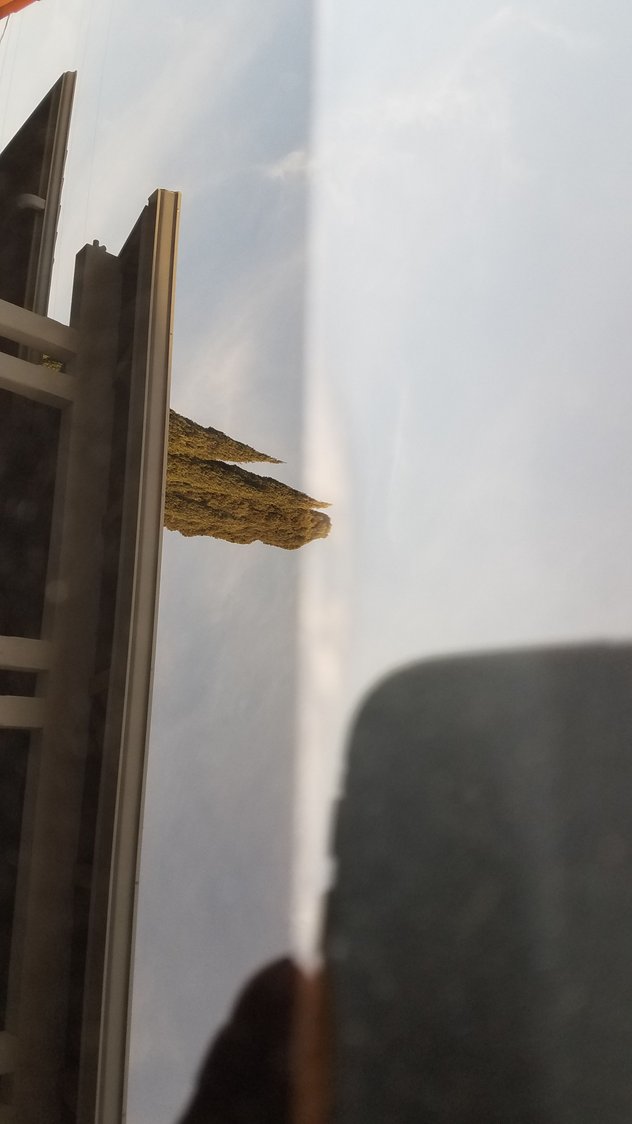

It's buckling/ peeling back at the winshield.

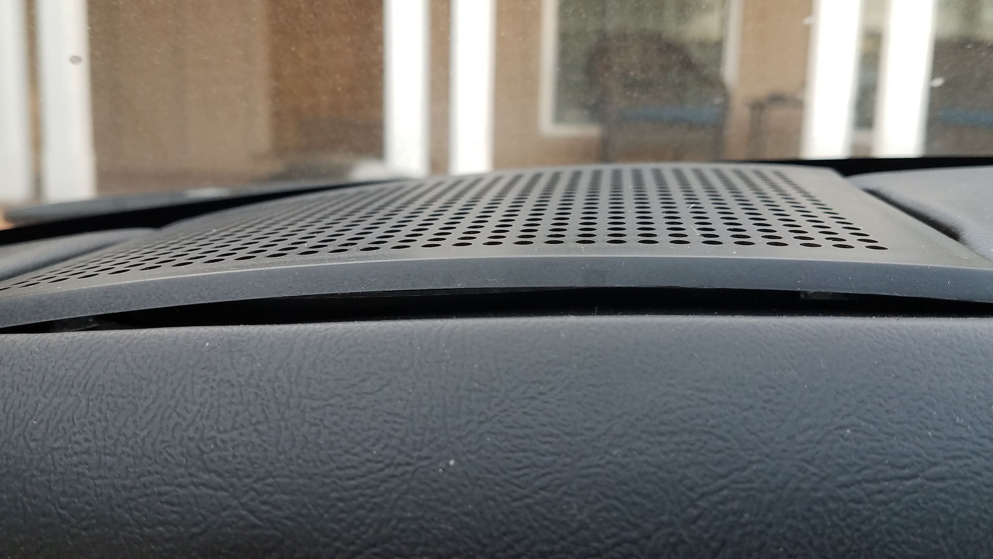

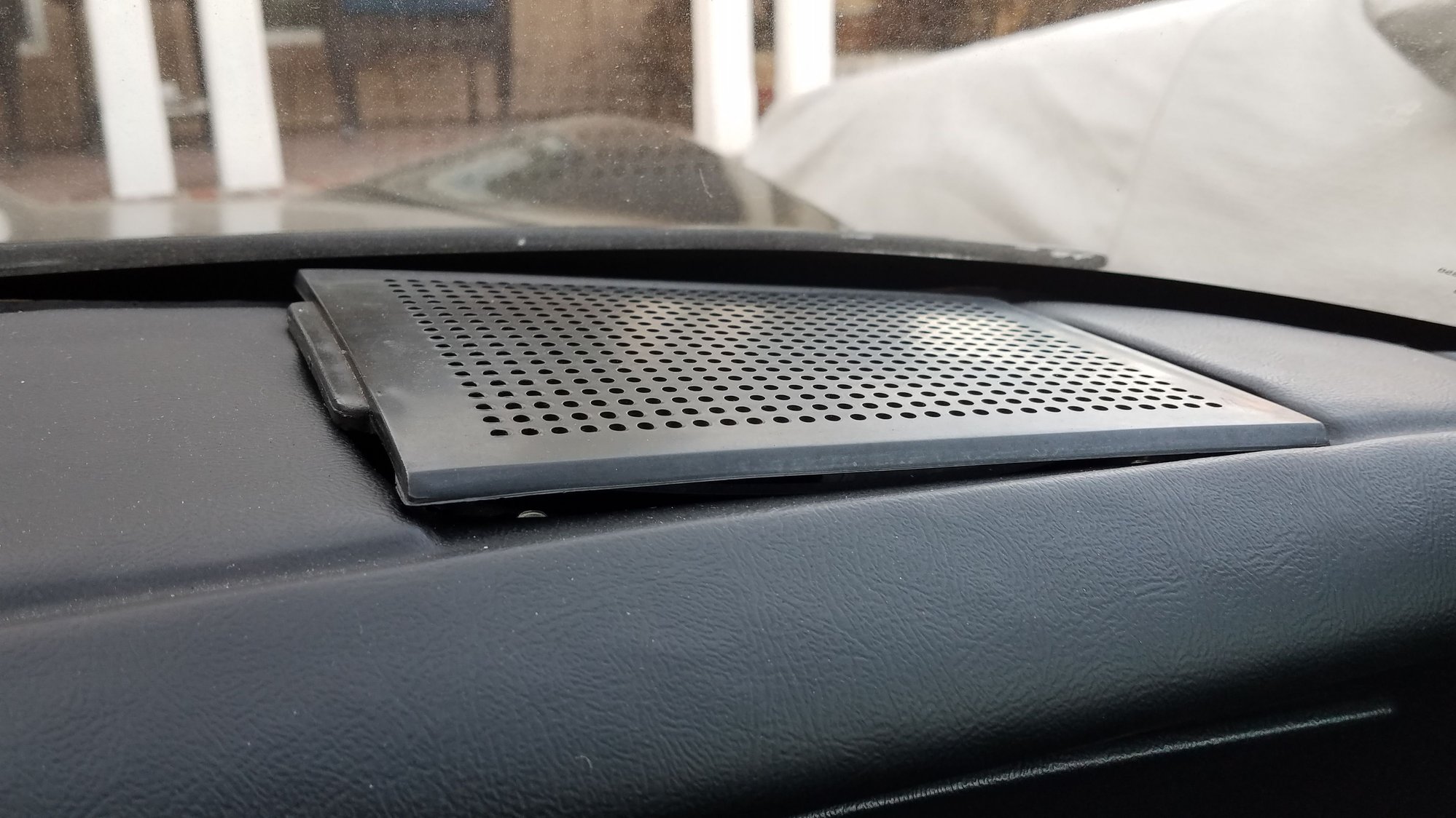

We worked the speaker grill slots with a heat gun 6 times. Just too small. I could cut the tabs, but then they will be short next time.

Bird... the speaker grills... First I'd get a cold wet rag handy, then I'd heat the pad with a blow drier, then force the grill in place, push it downward hard and then apply the cold wet rag.
Vinyl when heated will shrink up when you it cools on it's own, but vinyl will stretch when heated and if you cool it with a wet cold rag it will hold it's place. I also wonder if possibly the foam between the sub-straight and the upper vinyl hasn't moved as well... But if you get it hot enough both will collapse if you install that grill and hold it down hard.. .then hit it with the rag. The same goes for the wiper switch bezel. I was hoping you had a 1978 to 1979 Early car which used the metal wiper switch bezel... they make this easier because they are metal... so you can just heat the bezel. But you should have a plastic wiper bezel and I'd use the same technique as above for the speaker grille.... I'd heat the dash pad with a blow drier and then slip the bezel in place holding it where it belongs, then slap the cold to it.
Can you email me some other pictures of the windshield fit issue... Maybe one from a bit further back.
