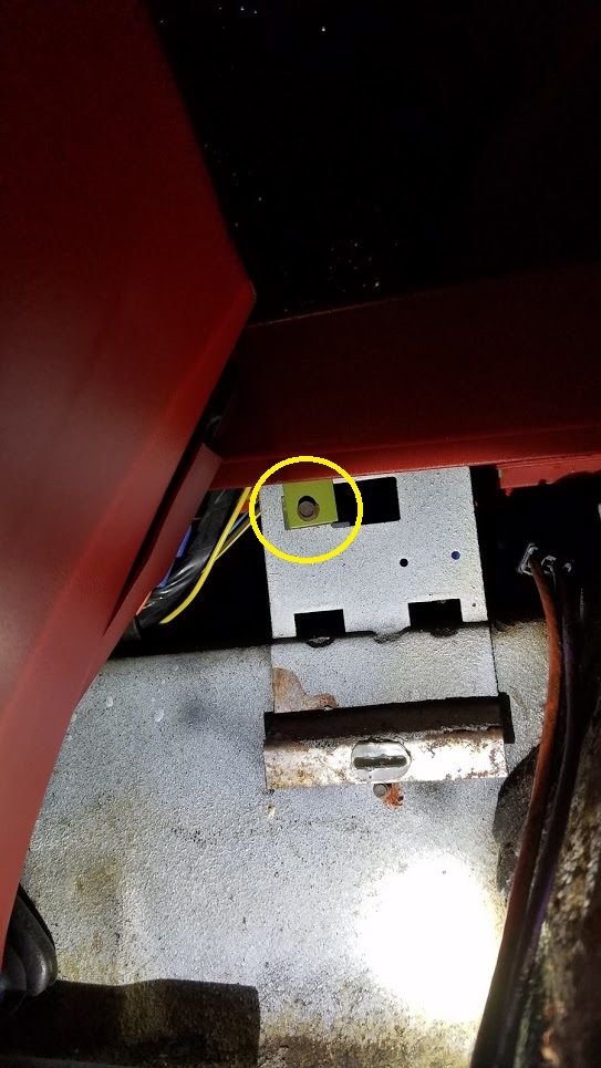

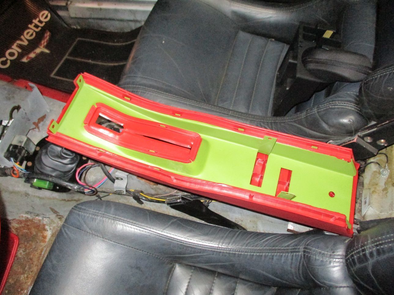

Vince, is this for your 80-82 Corvette (that matches your sig?). The above suggestions are all for early-model cars, not for bubble-glass with the new interior.
There is a metal bracket that holds the rubber part. You should take them off together. There are two screws that go into the rear of the center console plate behind the shifter (assuming they haven't snapped off already), and two metal tabs that bolt to the trans tunnel. I'll see if I can post a photo. This job is much easier with the seats out of the car.

Here's a photo. With the driver's seat all the way forward, you can just barely see the bolt on the tab that goes into the bracket fixed to the tunnel. There is one on each side (offset from each other, it will be clear when you take it off). The original piece is bare steel. I painted mine with zinc chromate, so it looks like Christmas.

Bikespace, yes it is for my '80. Thanks greatly for going out of your way to get those pics. That will certainly get me there. I hadn't snapped anything off. 30 years ago I probably would have done that first and then asked.
