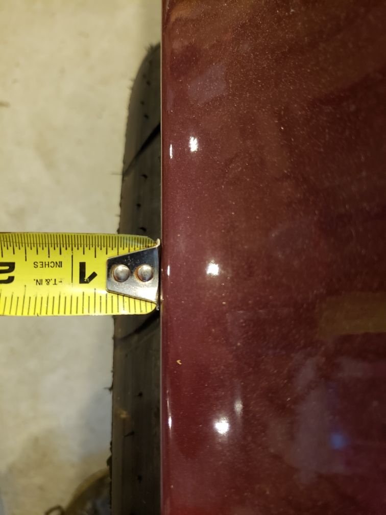

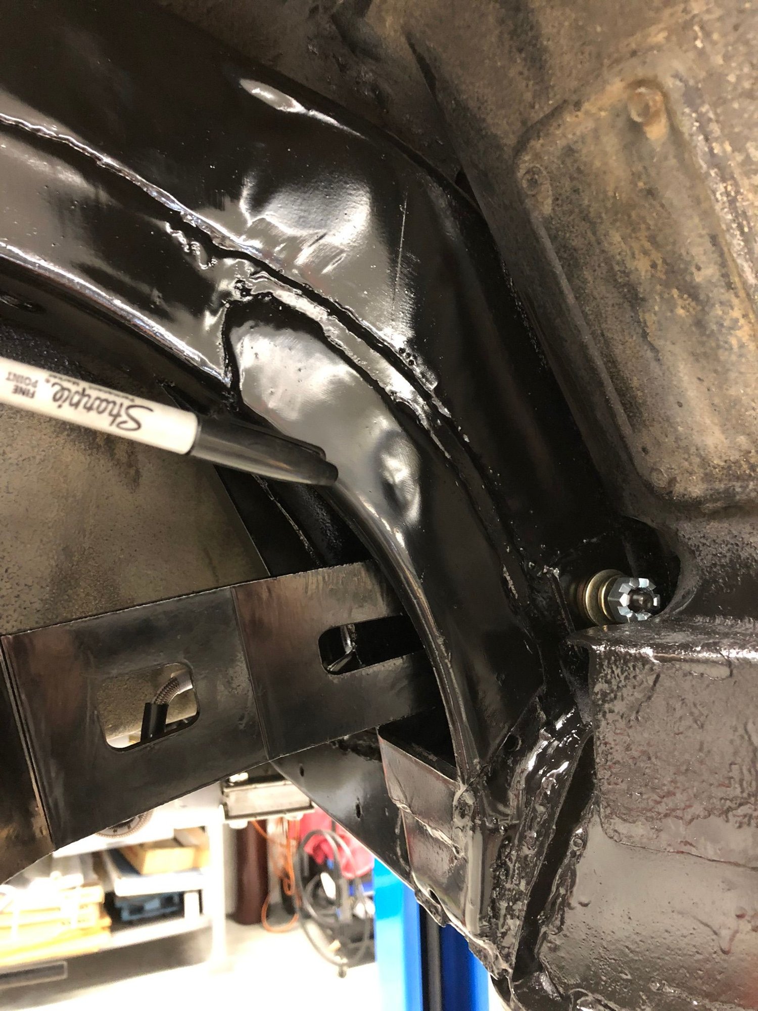

anyone bend or hammer this part of the frame for tire clearance? If so how did it go. Cutting and welding is also an option.

seems like you got the wrong offset for your wheels

depends how you look at it. 15x10 5.5BS

Does that tire stay inside the fender on suspension compression? That’s impressive if it does with a 295. Was going to try it myself. Is the tire hitting the frame sitting still or just while driving? Looks great!

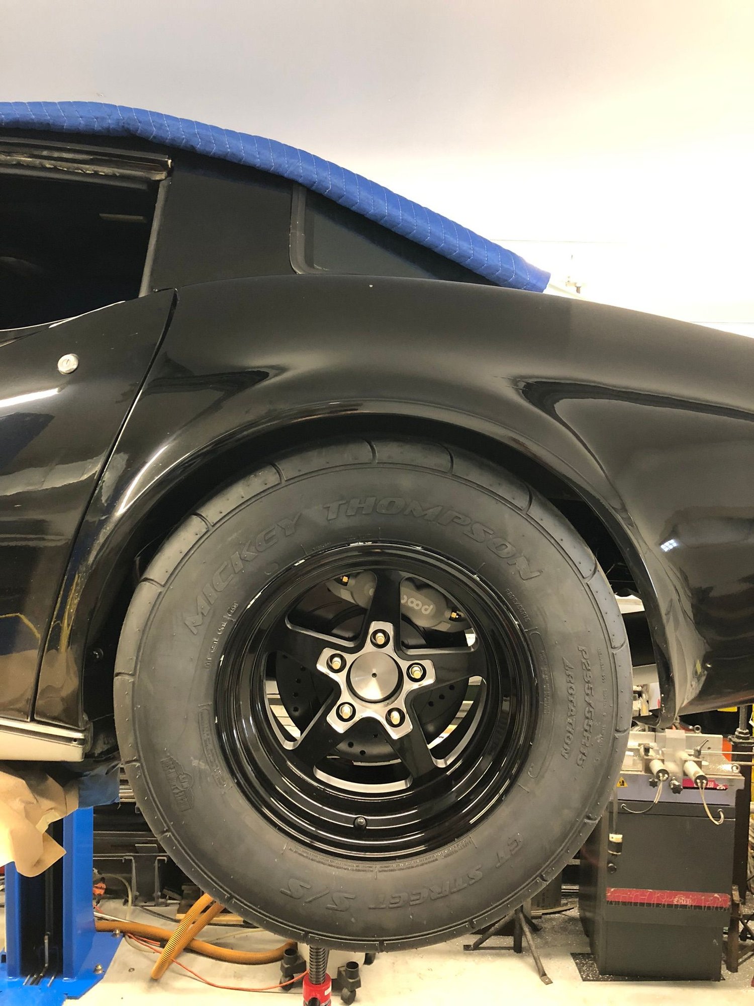

I just did a bit of work to relocate my 295 55 15 MT drag radials inboard. The wheels I have are Weld Draglites, and they are 15x9 with 5 1/2 inch backset. Of course they would not clear the calipers, so for years I ran a VB&P wheel adaptor that was 1 1/4 inch thick, but the tire stuck out one inch. Drove me crazy.
So my newest rendition is the same wheels, but using a custom .710 inch thick wheel adaptor. This brought my tire in 1/2 inch. While this was a good thing,....it required a shortened rear spring and removal of the rear sway bar. I had Van Steel make a 440 lb shortened spring to compensate for the loss of rear sway bar, and allow for the tire clearance. The ultimate goal will be a 15x10 wheel that sits like my 9 inch wheel sits now. Current backset is 4.79 inches, so the 15x10 would be about 5.25 inches, or 1/4 inch less than you see with wcmachine's set up.
I only took a short ride around the block as there was still snow on the roads the day I had it out, but there was no evidence of tire contact with the frame, or anywhere.
Here are a few pics I took while the car was still on jacks, and up against my bump stop.
I did test mine while the spring was out and under full compression the tire will not hit anywhere. I did modify my bump stop, and still need to drive the car a bit to see if I need to trim it some.
wcmachine,
I would try a 1/4 inch spacer and see if that will eliminate the need for frame bashing.

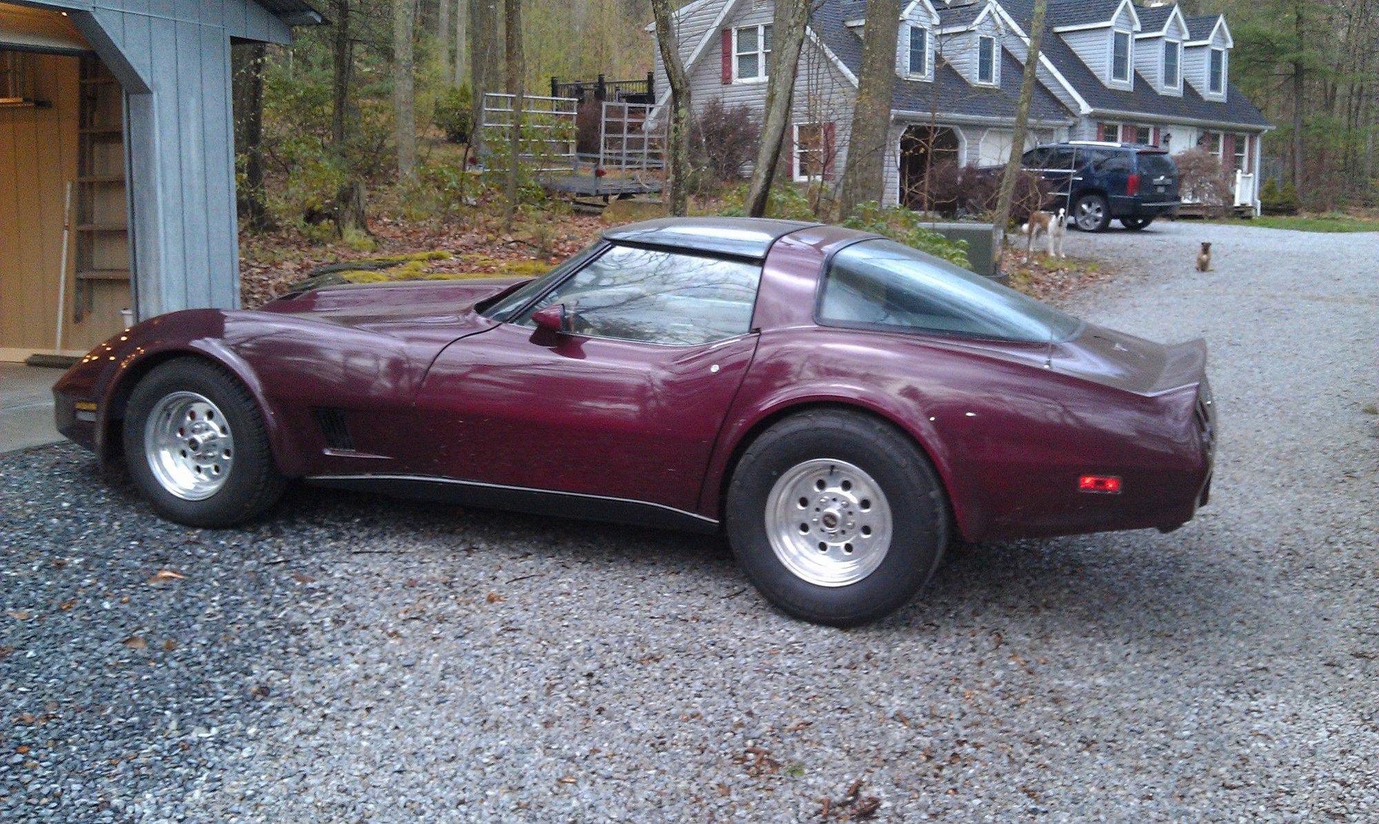

This last pic was taken before I started to move the tires in. Doesn't look bad in my opinion, but I felt it would look better if the tires were tucked in a bit more. Also I do want to go with 15x10 to get rid of the tire pinched look.

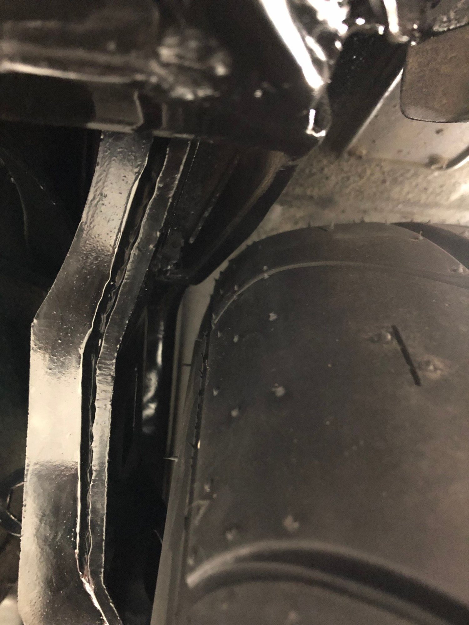

I run an 18x10 with 5.54" backspace and a 295/30R18 or 295/35R18 on my car when on the track. It doesn't rub anywhere at rest, or cycling the suspension up and down, but it has polished the paint off the chassis in the area indicated so must touch lightly under cornering loads. It has never rubbed hard enough to even make a mark on the tyre though.
