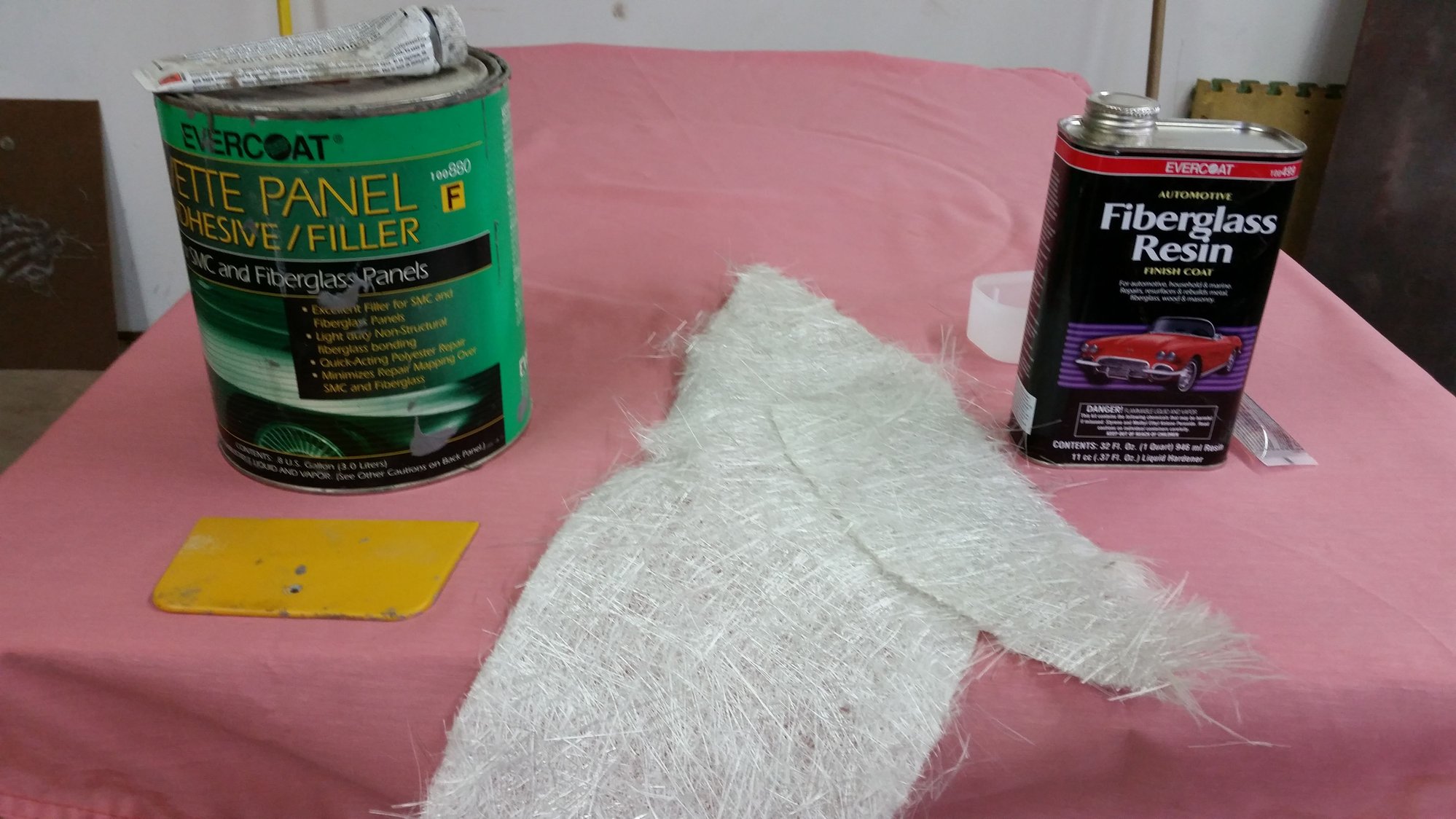

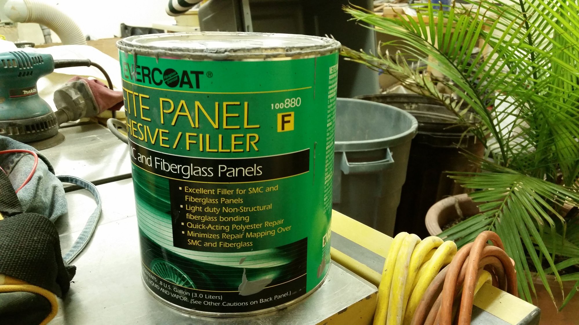

Old Feb 7, 2019 | 04:14 AM
SB64's Avatar
SB64
Joined: Jun 2013
Posts: 4,399
Likes: 793

Don't believe all you hear. Not all material is approved for fiberglass but you don't have to look hard to find one that is.
Both Evercoat Gold and Evercoat Gold Extreme body filler, available at summit is recommended by the manufacturer to be used on fiberglass. I am sure there are plenty of other brands as well.
http://www.evercoat.com/images/ePIM/..._2_2015_EN.pdf
https://www.summitracing.com/nv/parts/fge-112/overview/
http://www.evercoat.com/images/ePIM/...ME-12.2017.pdf
https://www.summitracing.com/nv/parts/fge-120/overview/

The Evercoat brand is an excellent product........hardens nice and sands easy.
