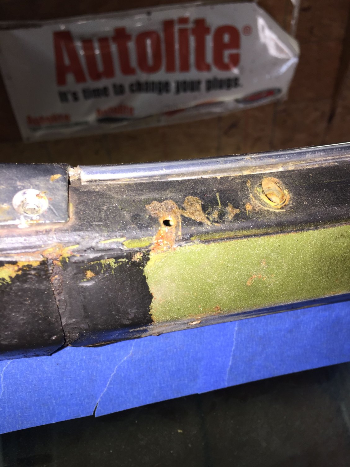

These are the screws I was asking about. Do these need to be removed to take out center trim?

Yes, if you remove those screws the center trim piece will lift out as you already have the top 4 screws removed. If it has never been out it will be held down across the front by a strip of sealer type putty between the stainless and frame underneath so start lifting up at the back edge and go easy so you don't distort the trim. The corner moldings are held down by 2 screws each on the front edge behind the windshield so you have to take the glass out for that but the top center trim has no fasteners along the front. If the windshield in your first pic of the first post is original it looks like someone filled the entire frame with sealer at one time as you should be able to see all the factory trim clips but the entire gap is filled up with something. It didn't come like that. I replaced the original windshield on my 69 recently because it was starting to delaminate around the edges and it would be a real crapshoot trying to get one out without breaking it. You also have to be very careful you don't mark or damage the dash pad along the windshield line when you cut it or wire it out.(Edited as I see your dash pad already is out.) It can turn into a can of worms really fast.... I also found that new glass is about .075" thinner than original, about .275 vs .200". If you pull the top stainless trim and find no evidence of rust and the structure down by your door hinge mounts behind the kick panels looks OK you might think about how far you want to go.

When all the screws are removed the large header trim MAY still need to be pried loose because of the sealant under it.
Be careful as you lift the trim so you don't accidentally kink or distort it.
Here's a photo showing the piece coming off.
Notice I was using a piece of wood as a pry tool.
Good Luck!

This is the same area as you show in your photo.
The hole to the right is one of those that holds the rear side of the trim in place.
The hole to the left is a hole for the screw that holds the header soft trim in place.

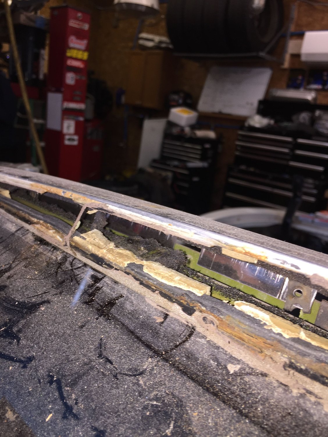

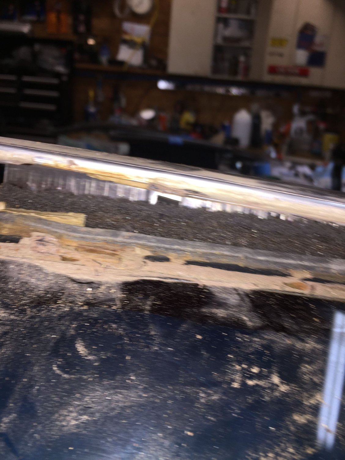

Okay finally got to spend some time in the garage today and tried pulling that header trim. It comes up in the middle and front but seems to be catching on the inside left and right corners. It’s almost like it slides into the corner trim instead of just sitting on top of it?
To More windshield and trim questions
Old Apr 20, 2018 | 04:54 PM
Alan 71's Avatar
Alan 71
Joined: Sep 2006
Posts: 31,283
Likes: 4,374
From: Westminster Maryland
Hi Pm,
I'm thinking ALL the screws are removed?
Notice the shape of the rear of the ss trim and the 'lip' on the rear of the corner casting that it clips over.
Regards,
Alan
Old Apr 20, 2018 | 05:03 PM
Pmccooey's Avatar
Pmccooey
Joined: Feb 2017
Posts: 1,462
Likes: 106
From: Cortlandt Manor NY
Thanks Alan. I removed all the screws and does your trim come on the outside of the header on the interior? Mine is in between the header and that little lip seems to be catching. It’s like I’d have to raise the center and try and slide it in almost but dont want to pinch the trim. All the screws are out also.
Old Apr 20, 2018 | 05:31 PM
CanadaGrant's Avatar
CanadaGrant
Joined: Apr 2006
Posts: 4,057
Likes: 421
From: BC
The stainless trim is supposed to be installed outside the upper header like in Alan's pic. Yours looks like someone (Bubba) has forced the stainless inside the channel.
