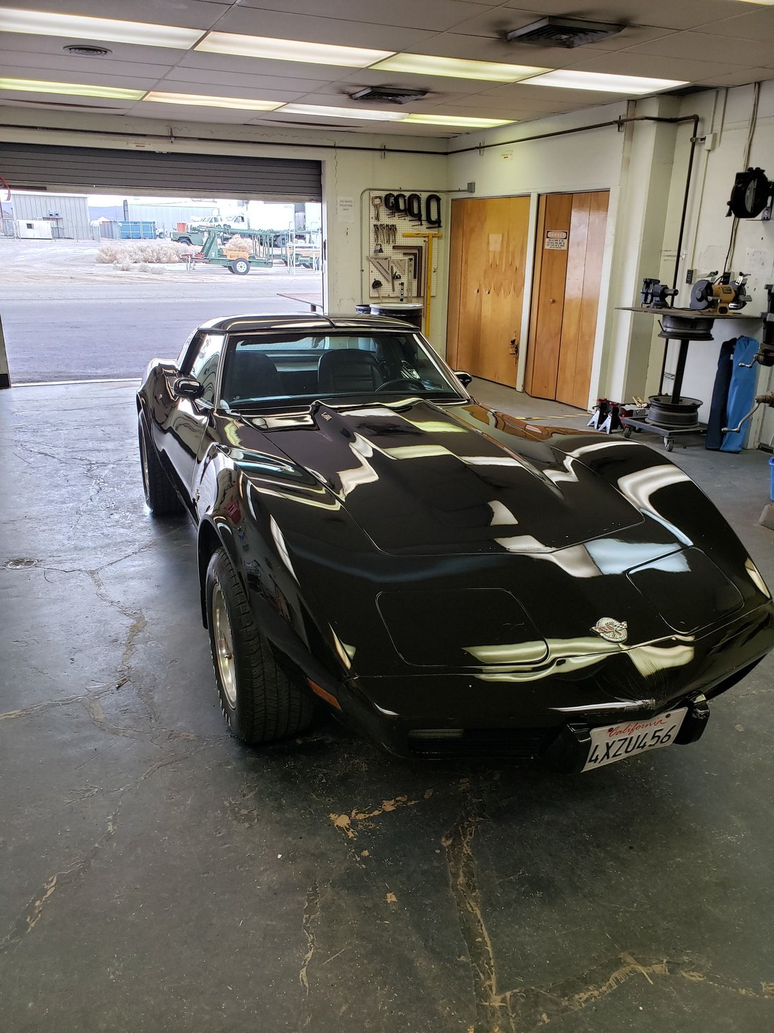

Does anyone know of a way to get any information similar to the invoice? Did Canada cars get records sent somewhere? I'll be on the lookout for a build sheet but not really going to take the car apart right now. Just finished compounding, polishing and waxing it. It's a driver quality paint job but a great 10 footer. Will get better as I touch up several chips also. I've driven it to work the last couple of days and it runs great... shifter is a little sloppy in neutral but I'll correct that eventually. Pic is from Wednesday....
