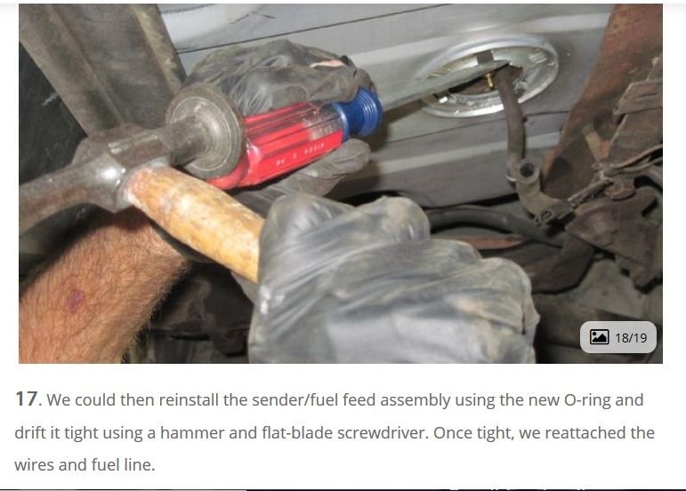

Not mine, but this should do it.

I went through this on my 66'........I made sure the o-ring was lubed up well with silicone grease (Dielectric) and the "leaders" on the lock ring I bent up at the edge ever so slightly to guide the ring under the tabs on the tank.......
Getting it started is the pain......this worked for me.
Jebby

Thank you all who answered my question. A special Kudos to Jebbysan with his wisdom to slightly bend the locking tabs enough to get the lock ring started.
That worked perfectly and very easy. Thanks again.
