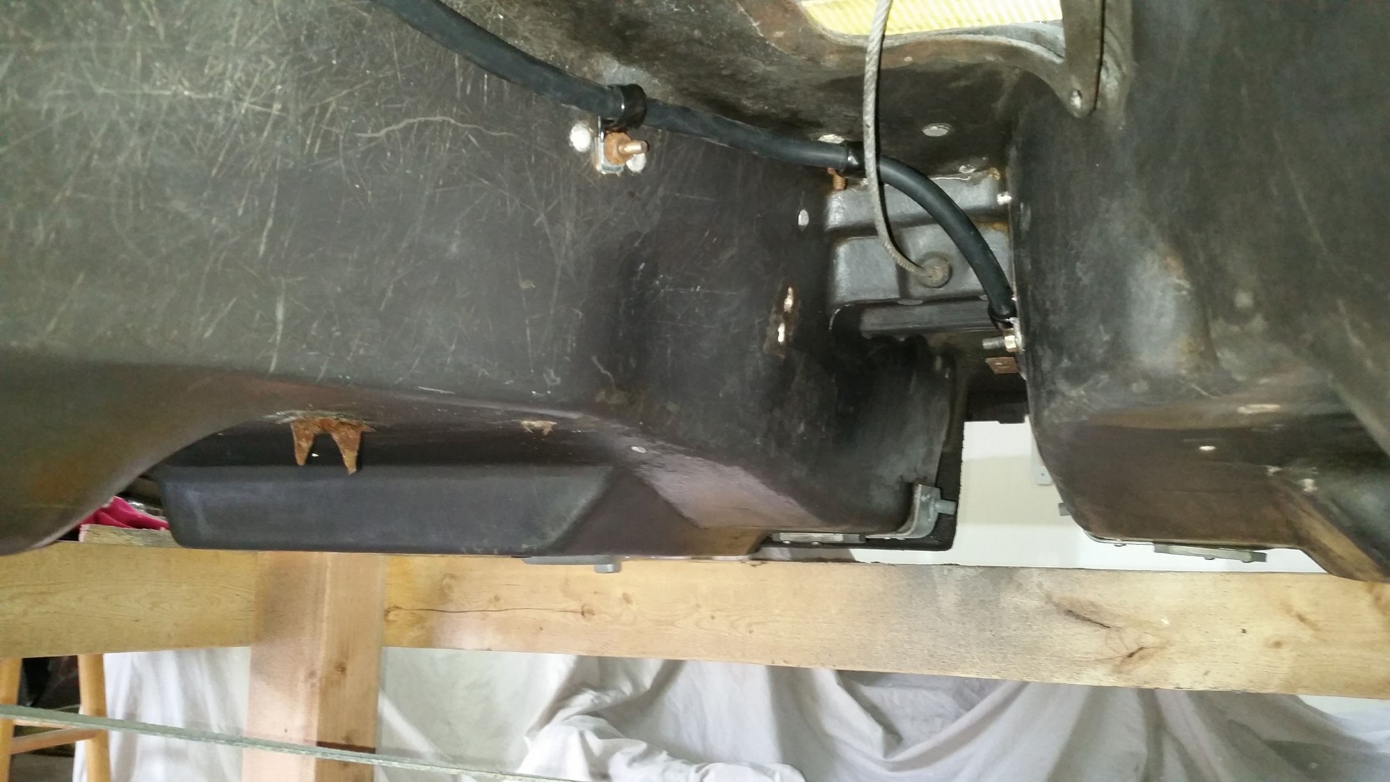

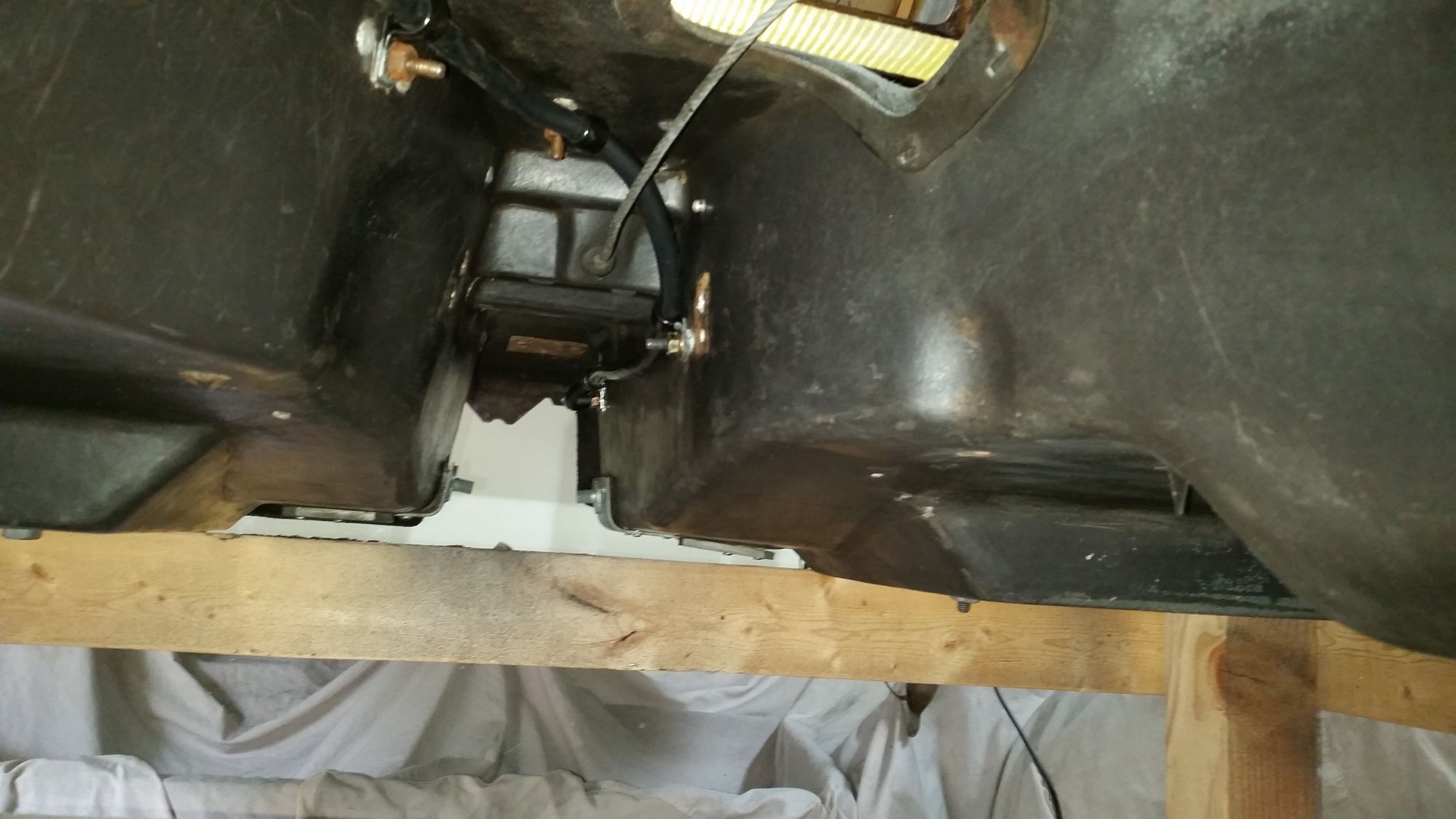

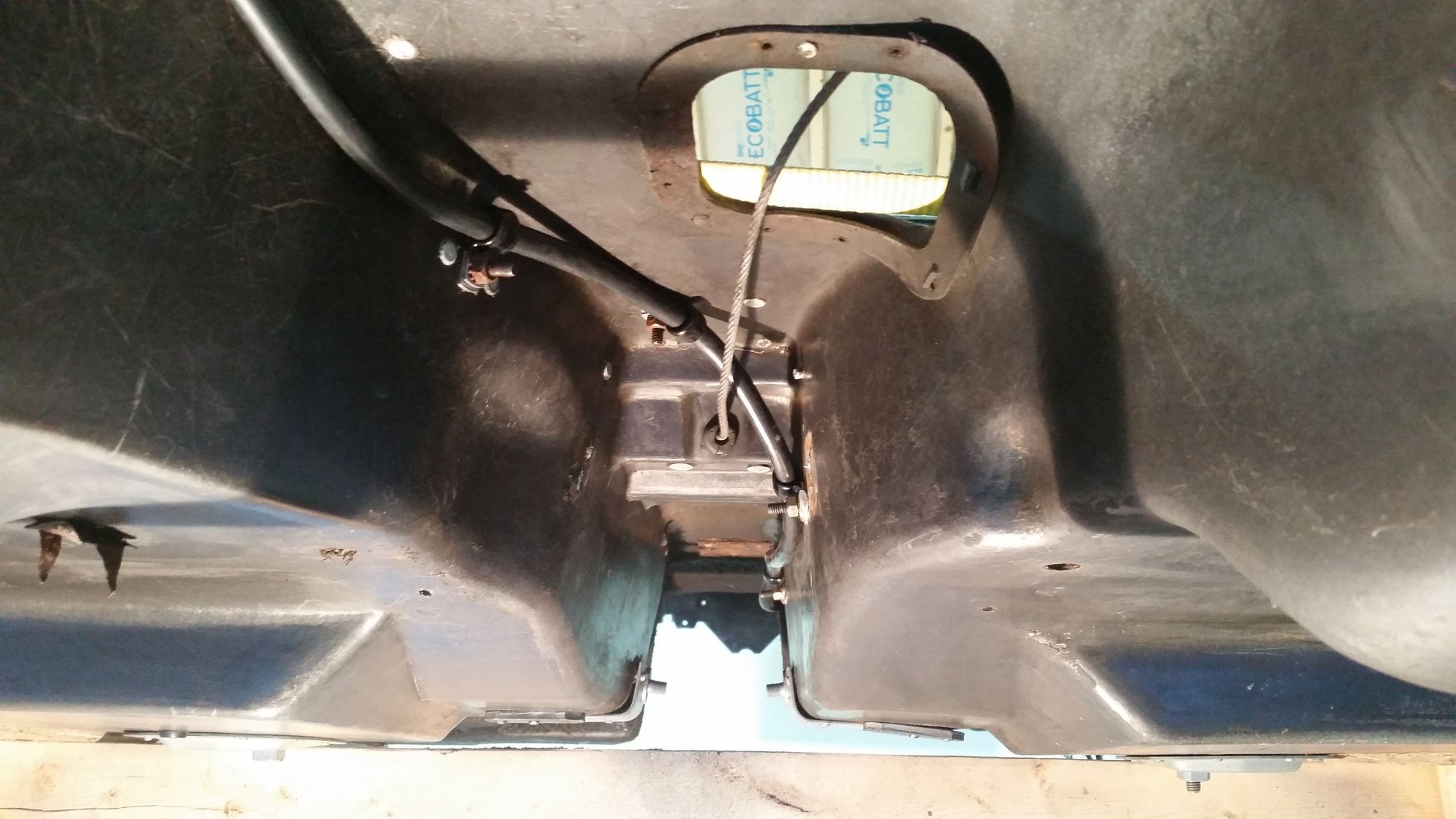

With the cable clamped down you do want to make sure you have enough length to the starter. Won't be easy if you are clamped and the wire is to short.
Regards
RVZIO

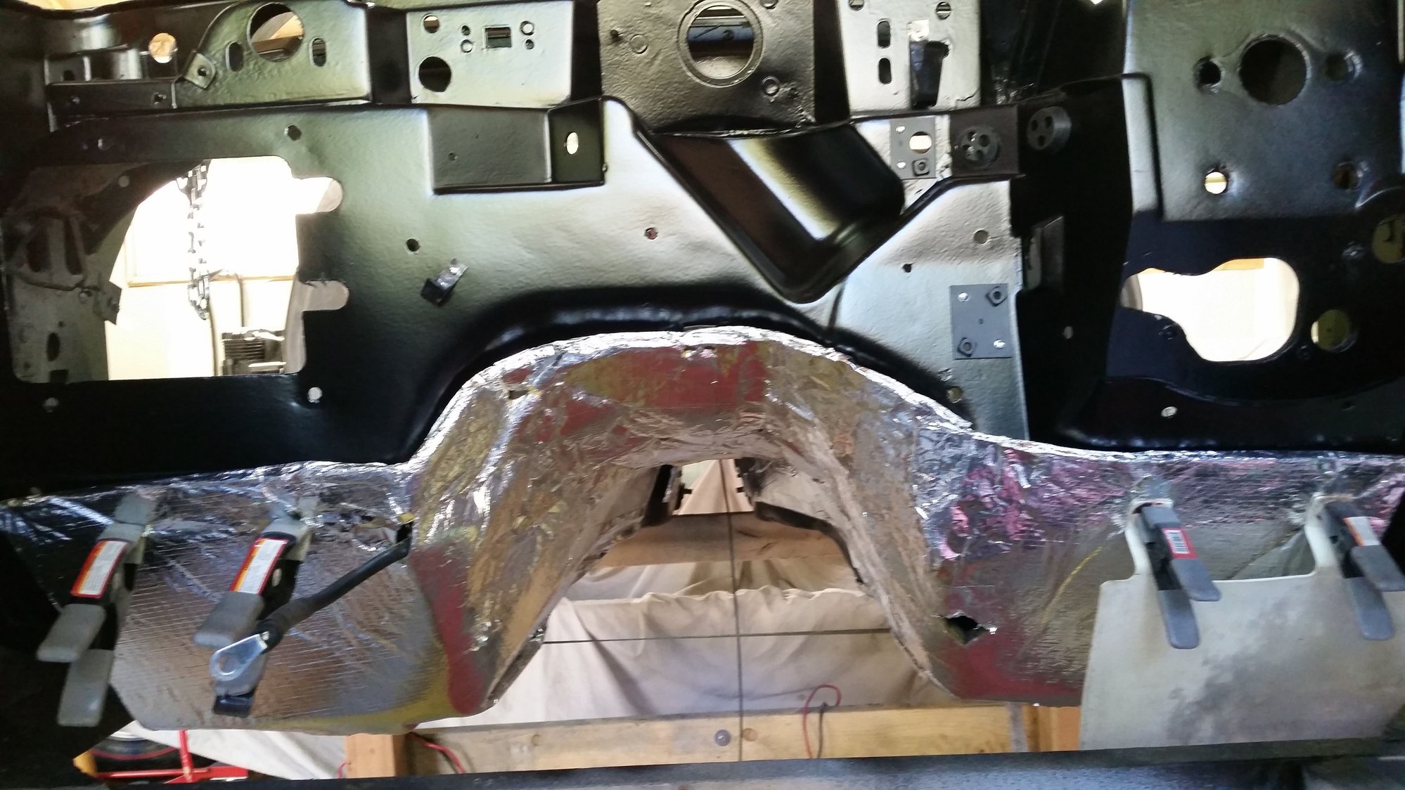

Thank you for your response. Pictures help a lot. However to raised another question. I bought tunnel insulation. It is a formed piece that fits up in the tunnel. I see yours is more like a blanket that also covers the footwell and behind the heat shield. Do I have the wrong piece or are both used.

I don't think so. The tunnel is a preformed piece. The other 2 panels are for the underneath and fire wall. I used silver tape for the seams so it may be harder to notice.
