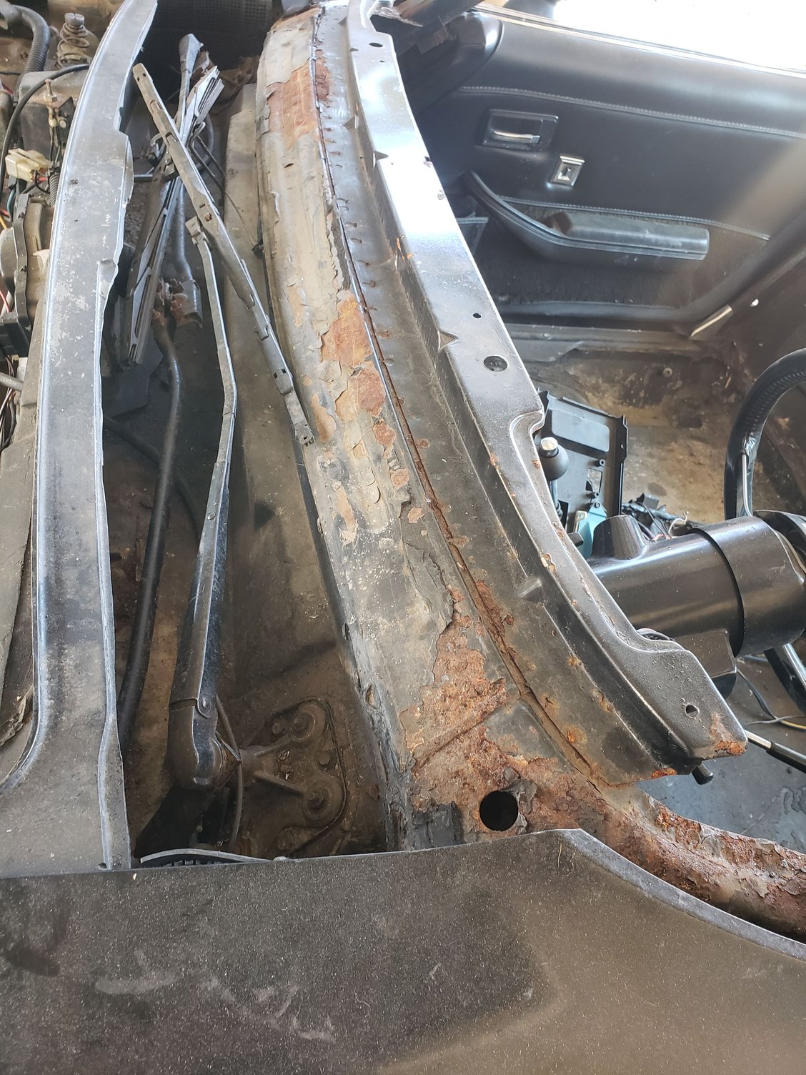

Here is some feedback for eastwood internal frame coating. I used it on the inside of my powder coated frame aswell. With some left over cans I did my birdcage and windshield section that I knew would be left under driveway under a car cover for some time( think its been there for 1-2 years now). It was pretty badly rusted and I did not want to do the repairs until it was actually the time but I did want to stop the rust for the parts that could be saved. I cleaned it with wire brushes also wet sandblasted some areas and used a rust inhibitor that I've had good results with called krudkutter rust inhibitor. Then after a few days I sprayed with the eastwood internal frame coating when fall season came I put a car cover over it and it stayed under covered driveway since then here's some rust starting to show after I think it has been 2 years now.

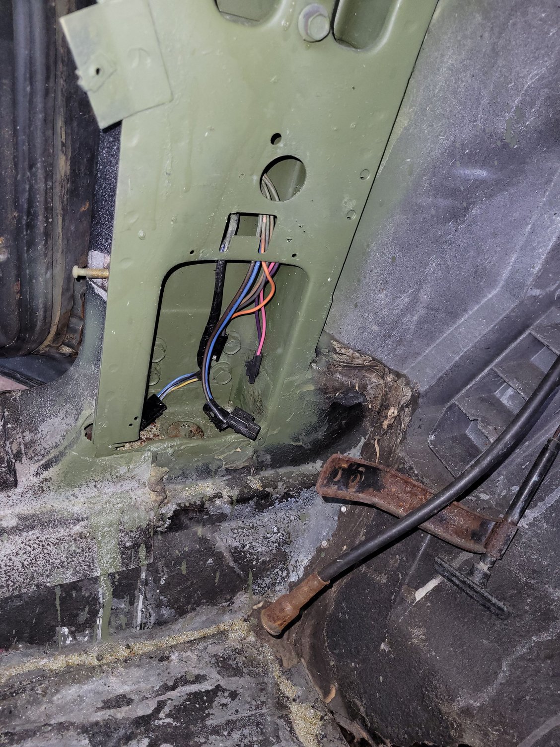

Here is the body mount areas some sand has gotten back in there. It may be a reaction from the frame coating not pentrating through the rust inhibitor in the heavy areas, I can't remember if I hit it with a wire brush after the inhibitor or washed it off I think I did can't remember. I may grind down the areas where the rust is showing and spray some the eastwood again and see what happens.

I hit it with the drill and wire brush to see whats underneath and the metal still looks clean, I guess the car cover itself was wet or so causing surface rust or something that had rust on it rubbed off on to the paint
