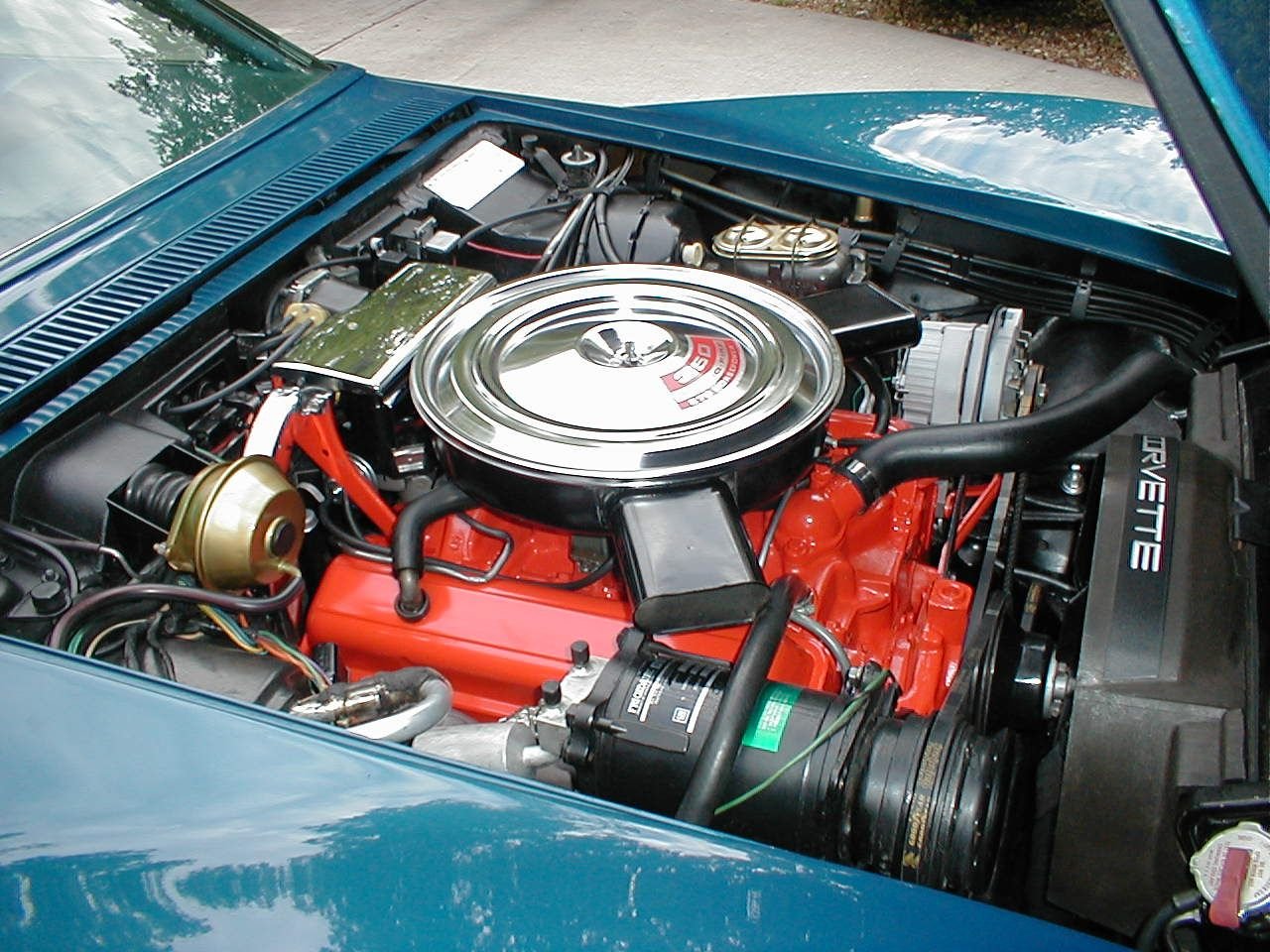

Actually, being as "****" as I am, I first shoot some self-etching primer on the metal, then a coat of chrome paint, then a light misting of bright gold metallic. While the gold is wet, I'll spritz a bit of transluscent red and some green around the surface, then shoot clear lacquer. Since all of those last ones were done while wet, they all blend together and look more like the multi-color chromate wash than just painting it gold.
You can see what my vacuum can looks like after that process. The horn relay under the left fender got the same treatment. The master cylinder cover was relatively new and has bright chromate wash finish (with clear lacquer on it to keep that look).

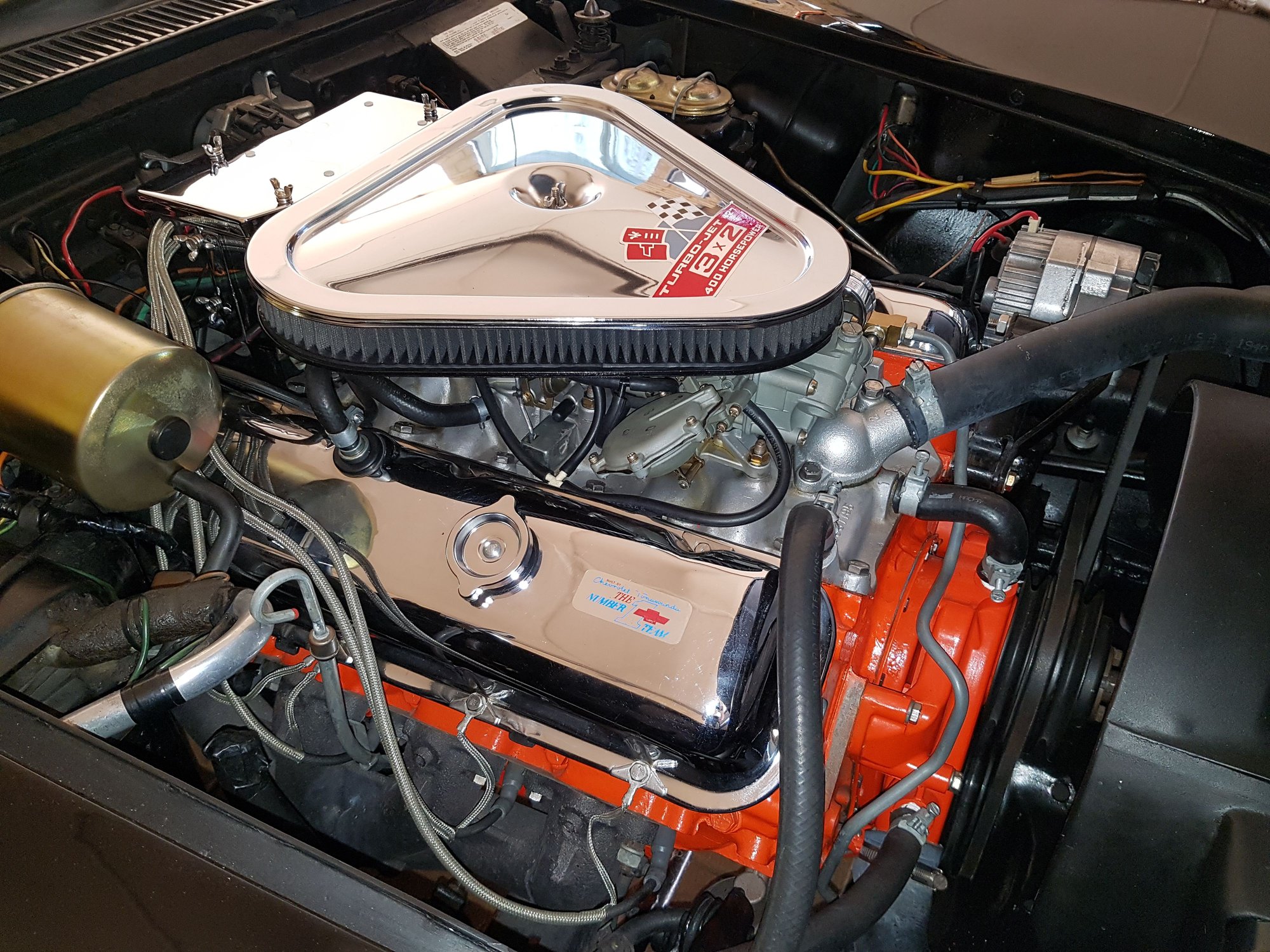

Trips setup. Pull that intake and get it perfect. That engine is a showpiece, not a wash it with gunk and paint it orange engine.
