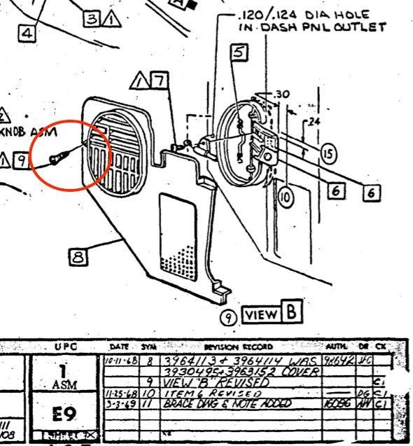

I am replacing the carpet (just pulling out the old) and this is my first restoration...so does this piece simply float? It seems to!!
Any input?
Thank you!

the rear of it fits underneath the leading edge of the sill plate.
there is one long screw on the forward edge of the kick panel that screws into the body.

Thanks very much...dont suppose you can point to where the screw is? I do understand about the sill plate...

The AIM is your friend:

From a later car but you can see the hole in that same spot

FWIW: check the factory AC section of the AIM (C60). Factory air required the RH kick panel to be trimmed and that may have changed the position of the trim screw.
