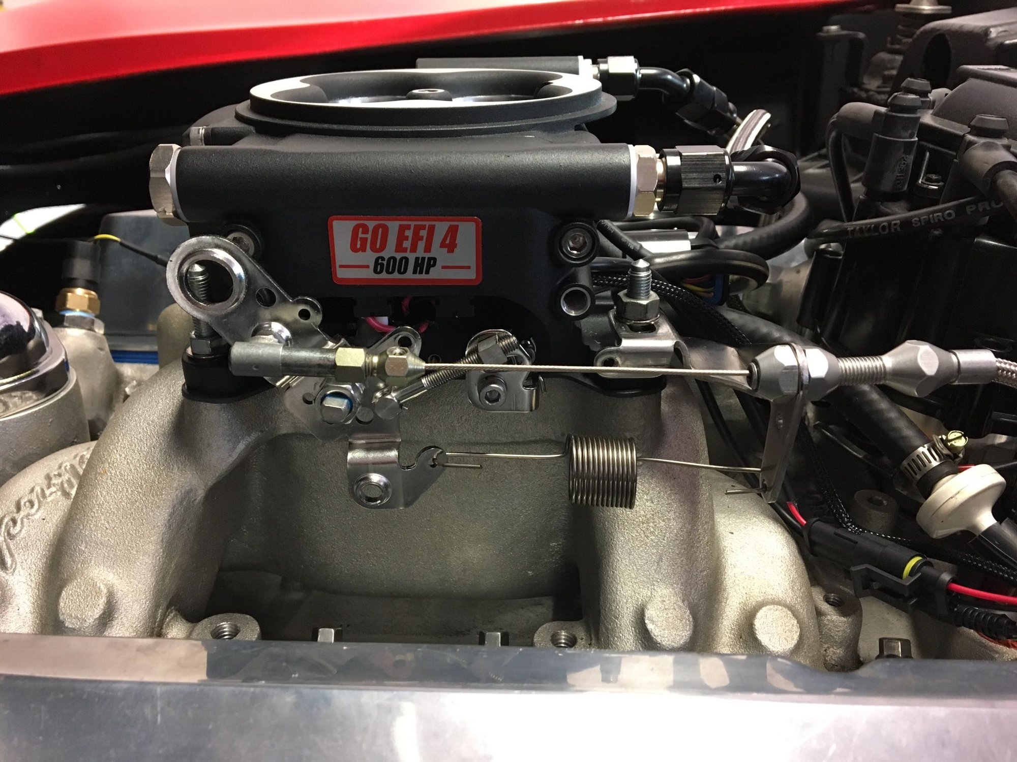

Old Feb 22, 2019 | 07:52 AM
Cavu2u's Avatar
Cavu2u
Joined: Oct 2013
Posts: 2,569
Likes: 126
From: San Diego California
