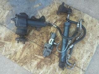

I don't claim to be an expert, but I have converted two C3s away from stock power steering, greatly improving both in the process.
The Borgeson valve replacement end link pictured replaces the stock power steering valve at the end of your center link. It is intended, I believe, to be used with the stock power steering Pitman arm, and the Borgeson power steering box, which is how I have it in my 79. I would expect it would work fine with your center link, power steering Pitman arm, and a stock C3 steering box, with the other power steering bits removed. I think the problem comes when you mix the Pitman arm and center link assemblies (manual or power needs to be consistent, as the Pitman arms have a slightly different geometry, and presumably the center link components do as well).
FWIW, I used a rebuilt manual center link and a new manual Pitman arm when I converted my 80 to manual steering. I read a lot of threads on this Forum and elsewhere, and determined that this was the surefire way to work. In your case, the stock power steering valve is absolutely expecting fluid pressure, and will work terribly in manual mode with a lot of slop and dead space. The Borgeson replacement end (pictured) should clear up most of that.
BTW, do you have the two sets of holes in your steering arms, and are you using the outer ones (further from the ball joint axis)? I don't have that option in my 80, but that is the stock manual configuration, which gives you more steering leverage and slightly slower steering.
