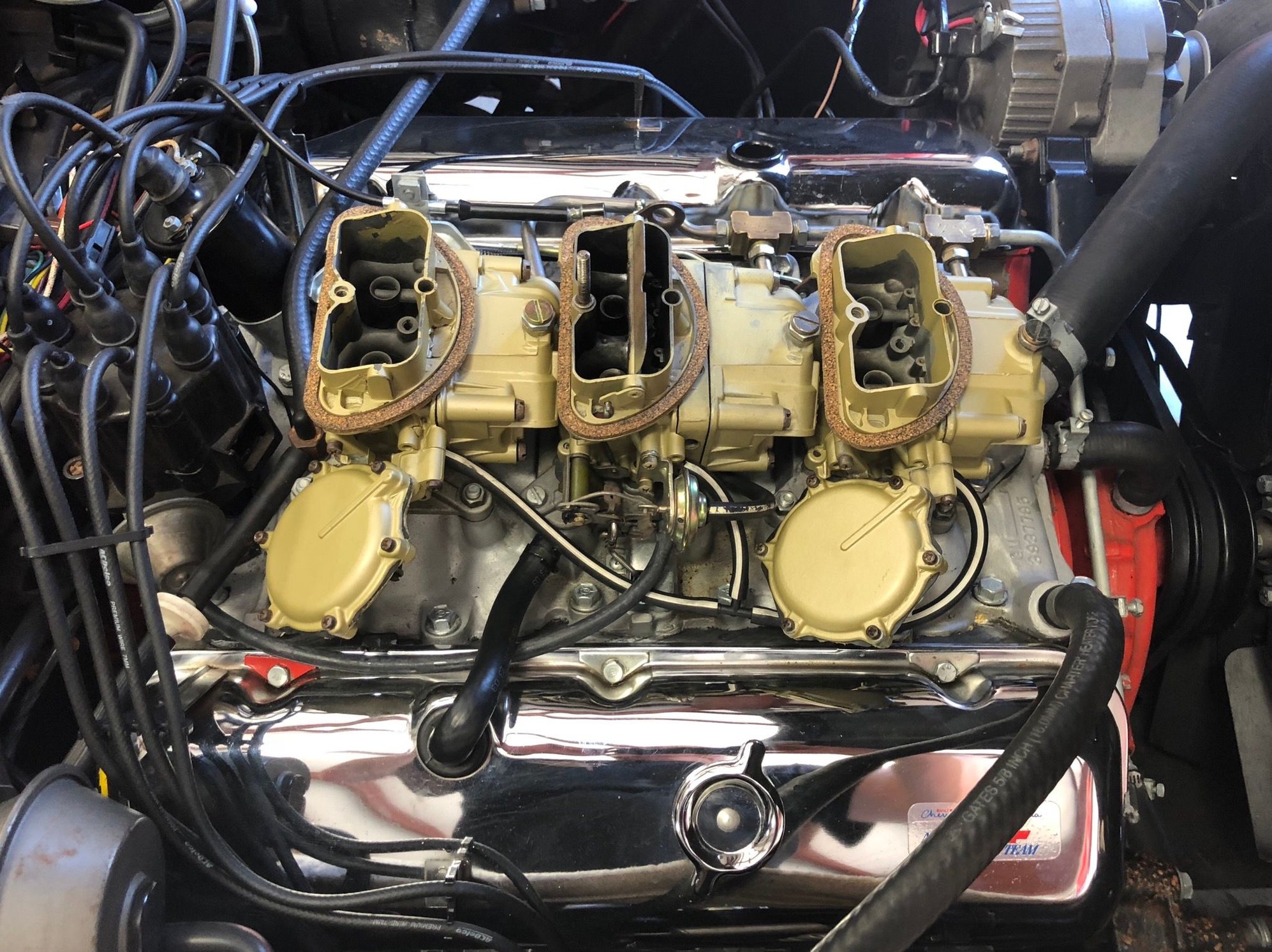

First check is make sure the end carbs are opening at WOT.... Second check would be the timing (total timing at 3500 or so).... THEN start digging into stuff. I would bet your secondary carbs are not opening all of the way.
We have a 69' 427/400 car and the tri-power end carbs only open about 1/2 way at wot, and they were "professionally" restored.... Ours has a nom bastard motor in it that floats valves by 5200...Its a total dog as well... I haven't dug into it too much yet though, my dad just creeps it around town and is content with it. LOL..

Yes its a numbers matching authentic L71. Yes the fr/rr carbs open but I don't know how much and seemingly not until 4500-5000 rpm.
I never checked ignition timing but I will. Yes the pedal does achieve WOT. The exhaust riser is moving, maybe I should lock it open but I don't know which way open is (against the spring when cold?)
Can I ask some specific questions - the car has a 'warm' cam in it (I have the specs somewhere if thats important) otherwise its stock.
- What intake vacuum should I see and where should it be ported from to be accurately measured?
- My distributor is stock with an Ignitor 2, it has a vac advance can but its not hooked up (its blanked) - is this correct and if not where should it be ported from?
- What advance curve should I be looking for an L71 (generically would help at least)
- Can anyone confirm the correct take off position for the centre carb vacuum connection to the F/R carbs, and the correct take off position for the centre carb 'bellows' vacuum. (a photo of the underside would really help)
- Could the fact that the car has factory A.I.R be playing any part in this?

One thing to keep in mind on the Secondary operation, the line from the center carb only provides some of the Vac. signal, the rest comes from ports in the Secondary Bore so if you have an exhaust restriction or some other problem preventing the engine from moving enough air the Secondaries won't open as quickly or as much (I also believe a low restriction Air Cleaner can affect the operation, I'll be testing this once things warm up here, I run my foam dry rather than oiled as GM specs.)
