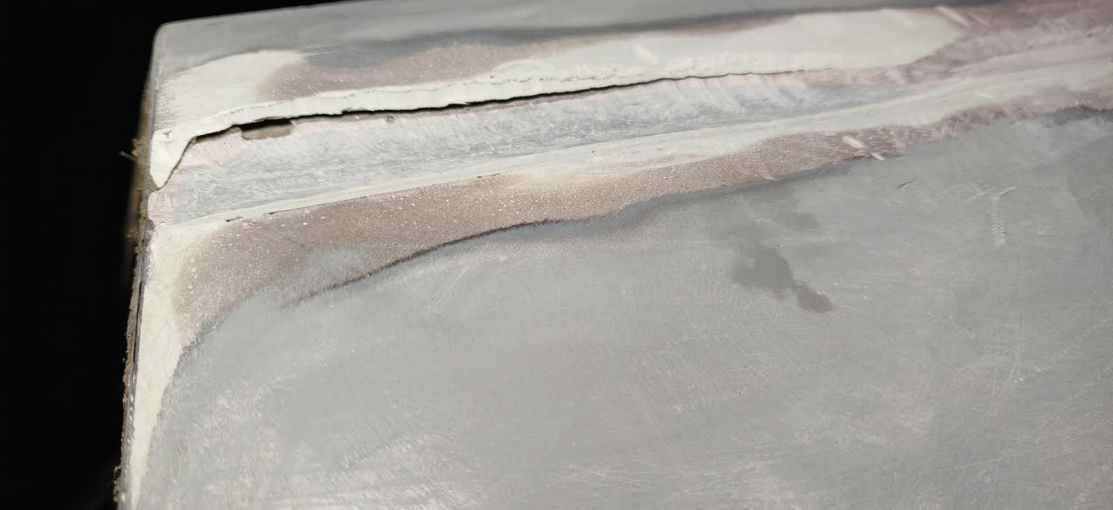

OK...IF you are JUST re-working the seams and filling them in. Using VPA is going to do just fine and NO NEED to laminate it. Not like I have been doing this for decades and ONLY trying to tell you what I know that works. But go ahead and laminate if if you want to. No need to do it the way I do it.
All I know is that from the photos of your car....if it were in my shop. I would prep and clean out the separated panels seam areas...inject in the SEM 39747 (because I keep it on hand). Any of the oozing SEM product that comes out on the outer area gets ground back to where I can only see the thin seam of it. ThenI would apply the VPA.
NOW.....due to ONLY seeing what you have allowed us to see in your photos. I have run across some scenarios where I have needed to laminate in some West Systems epoxy resin and then finish out the area.....but those areas are usually on the flanges of the panels where the bumper makes contact.
DUB

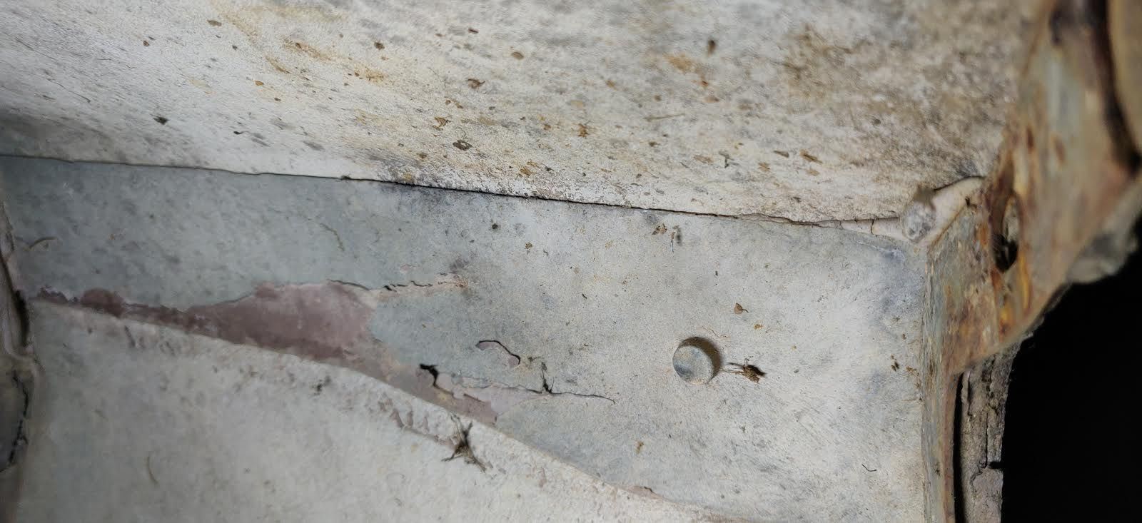

This is pretty much what I was looking for. The picture of the small split is the only part of the seams that are bad it seems. I have already talked to their support on the phone and the guy was able to answer every question I had.
The rest of the imperfections I have ground down so far, I have seen no cracks in the panel to the bonding strip thankfully. From what I understand the best approach to those are to sand into the old filler and put VPA over top. With my back bad seam, I will mix up some of the G/Flex 655 epoxy and inject it into the crack and let that set for a day then grind any excess out and fill with VPA. It says cure time is 10 hours so a full 24 should be plenty of time.
Hopefully I am on the right track now, I thank you and everyone else for the responses so far.

No need in removing the bonding strip.
I run into this SAME type of issue and I do much like what you have thought of repairing it by injecting or using a spreader to press the adhesive into the open seam area to fill it in.
I do agree that whatever method you can find to allow you to try to separate the panels enough so you can take a drill and small drill bit and route out some of the old adhesive and get it kind of scuffed up is good enough. A Dremel tool works good in this area also
IF you can separate the panels enough and take a piece of 36 or 80 grit sandpaper and slide it between the spread apart panel and drag it back and forth to scuff that area...that would work also. Blow this scuffed area well with air.
The 'trick' here is knowing when you can get away with NOT having to do a little bit more panel separation. Sometimes I actually will heat up the area and get it to come apart a bit more so I have a bit more flexibility in the panels so when I spread them apart....I KNOW I can get in that area and prep it so I KNOW my adhesive is going onto a ROUGH prepped surface. Sometimes wasting time trying to prep a tight seam that does not have movement in it is just not worth it. Knowing that I have to cover it with some VPA....trying to keep the repair to the minimum is often times more of a hassle.

Thank you for the tips, I plan to pull the rear bumper today or tomorrow to hopefully have a better look at what's going on behind the panel. Just placed an order for some VPA so that should be coming in soon.

When prying on it with a screwdriver, it barely moves up. I pried on the bonding strip some and it barely moved, maybe a millimeter or 2 out at the top and was solid at the bottom.
