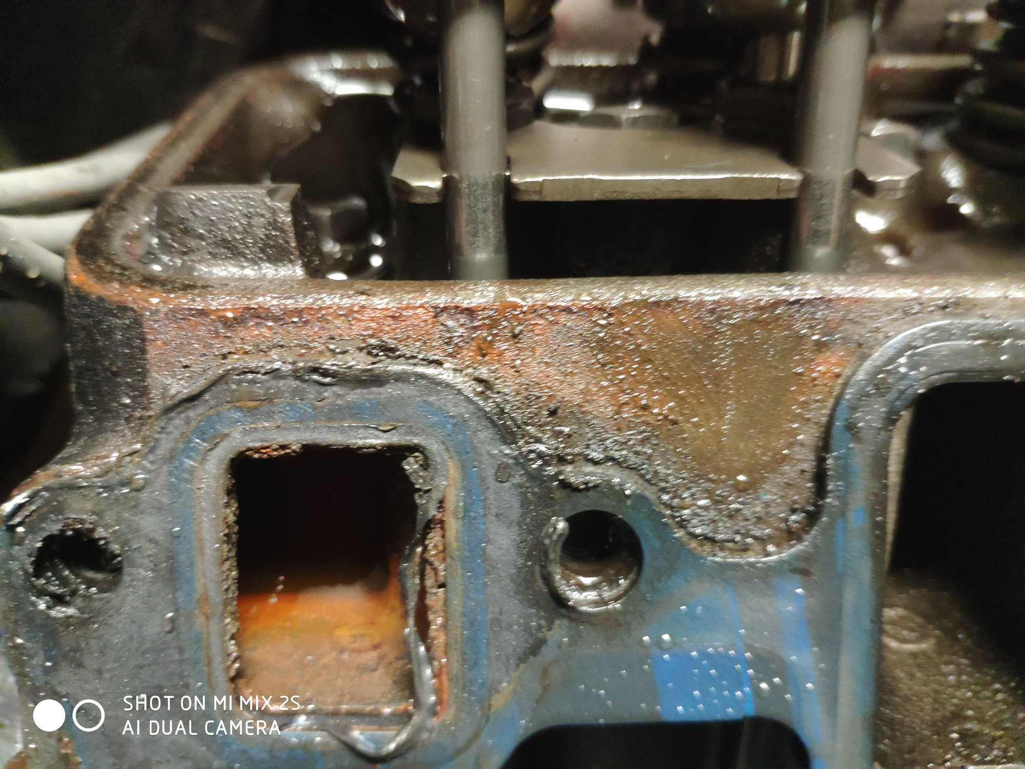

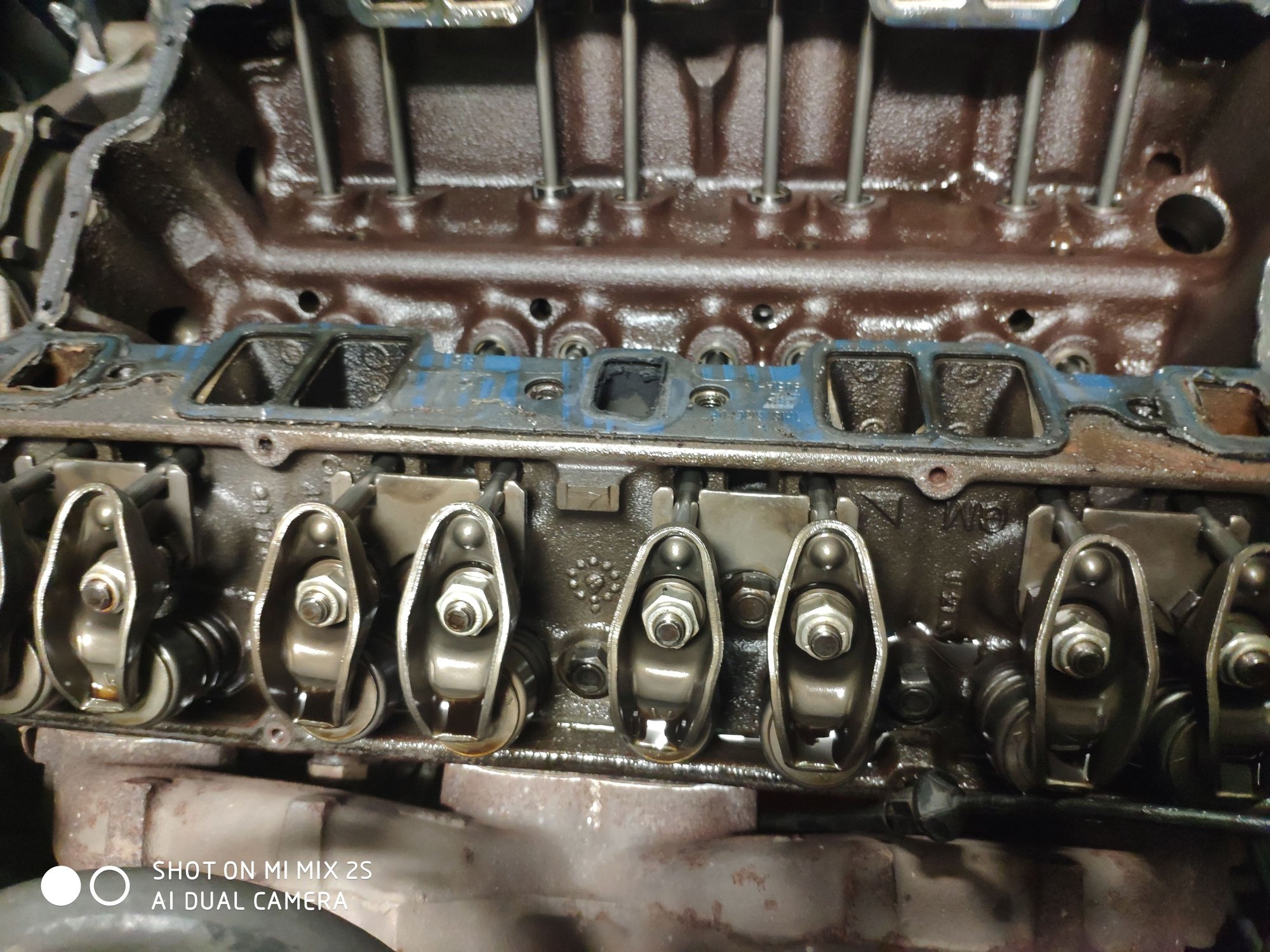

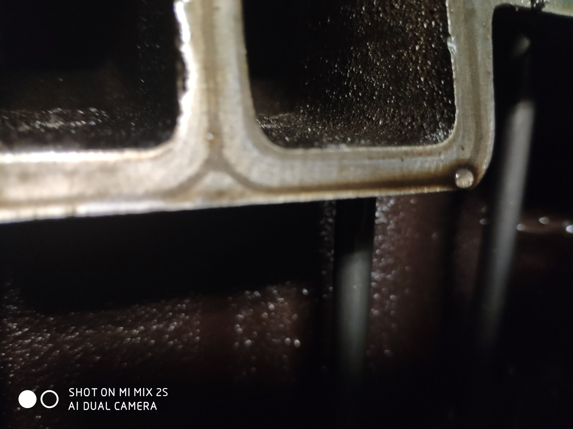

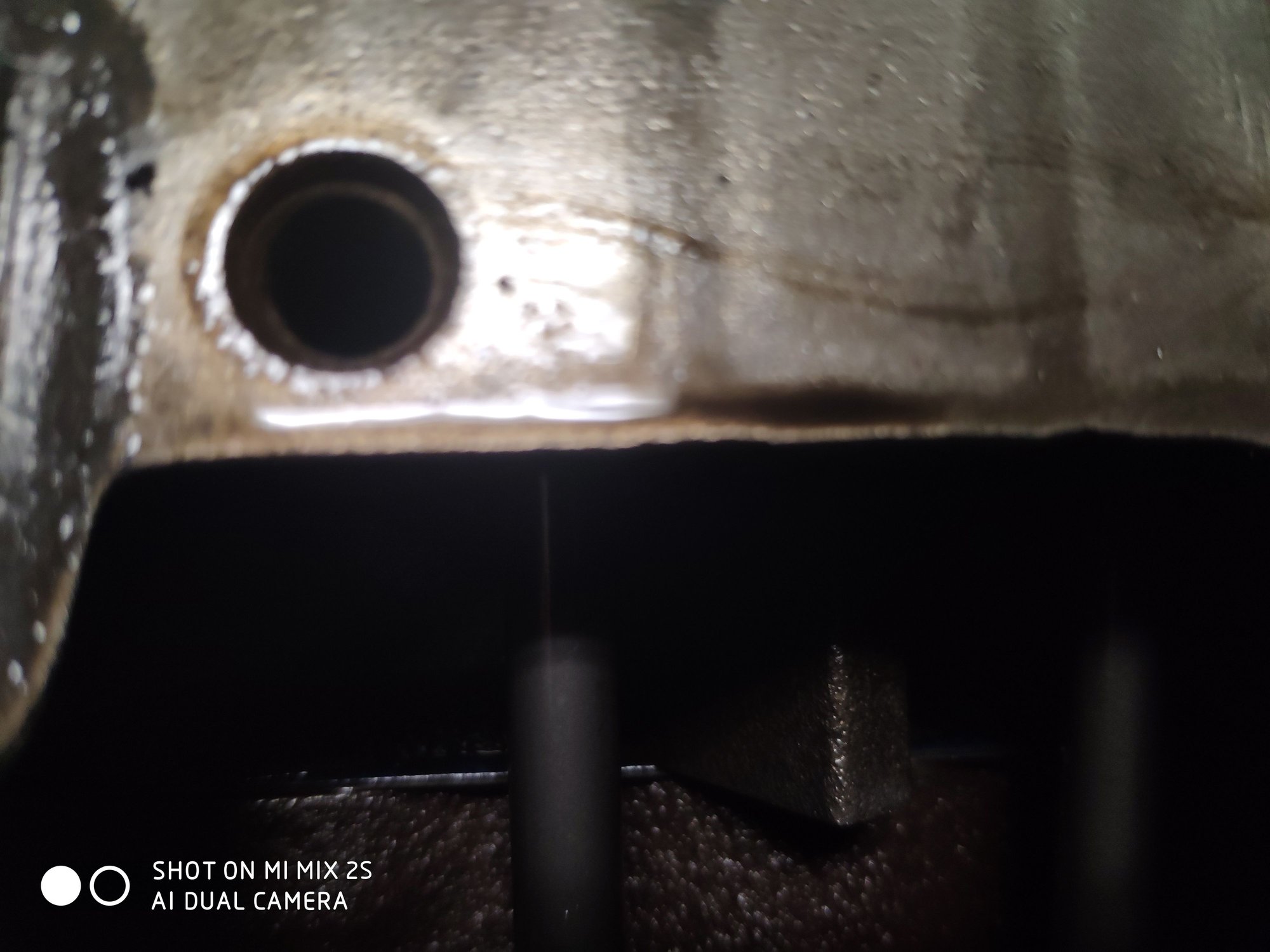

Sorry for the delay guys but I finally got sometime today to take the intake off. I found some strange stuff along the way. so the first weird thing was when I went to unscrew the intake bolts some of them were just finger tight, about half were tight half were not. The other weird thing is that the gasket had not seemed to have moved or shifted any so I pulled one of the gaskets off a little to check behind it and found a lot of oil between the gasket and the head. Also there was a lot of built up dirt on the cylinder head where the intake did not cover and a lot of oil in the intake runners. I would say this oil could have been leaking from the valve cover but it didn't have any of the other symptoms of a leaky valve cover. Here are some pics I took in the on with my finger that was wiped from right in the middle of where the gasket sits. Tell me what you guys think.

No doubt, your oil consumption was from the lifter valley. So, shove paper towels into the cyl head ports. Start scraping the head with a plastic putty knife or there are some pretty slick plastic razor blades on eBay. Either one will not scratch the cyl head. When you think you got it clean, wipe it down with Acetone. Then do the china walls.
Go to Summit and search Gaskets>Intake>FelPro. I do not know what size ports you have, nor which part number you need. You will also need Edelbrock Gastinich gasket sealer and a small can of The Right Stuff for the china walls. DO NOT use the rubber gasket provided, pitch those worthless things. And new valve cover gaskets.
This is a great time to decide if you need new intake bolts also. Those bolts should receive a dab of thread sealer.
I see your rockers have adequate oil circulation. Valley looks good. Normal wear on the pushrod / guide plates. You should be good-to-go.
I think you will see a huge reduction in oil usage.
