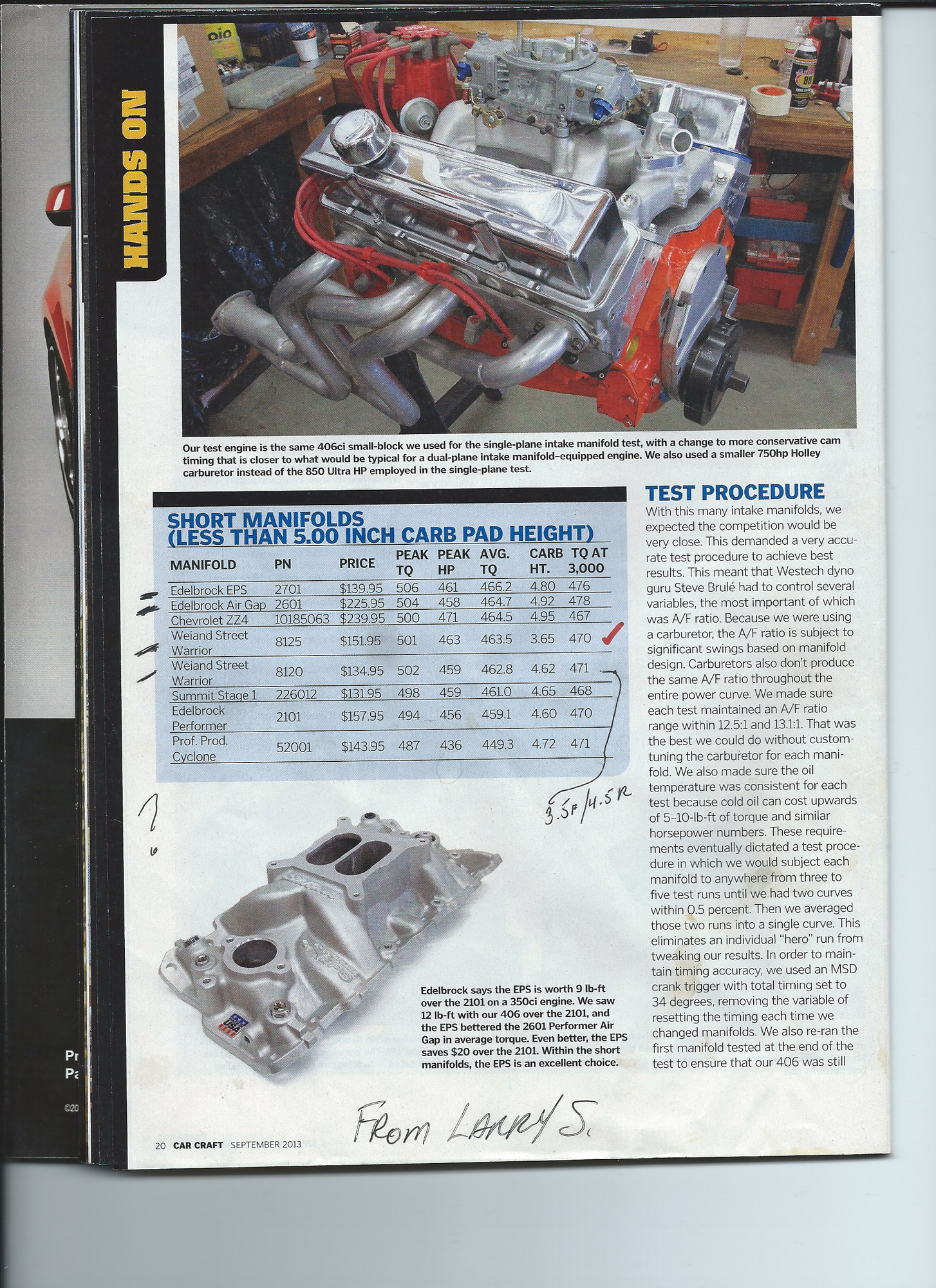

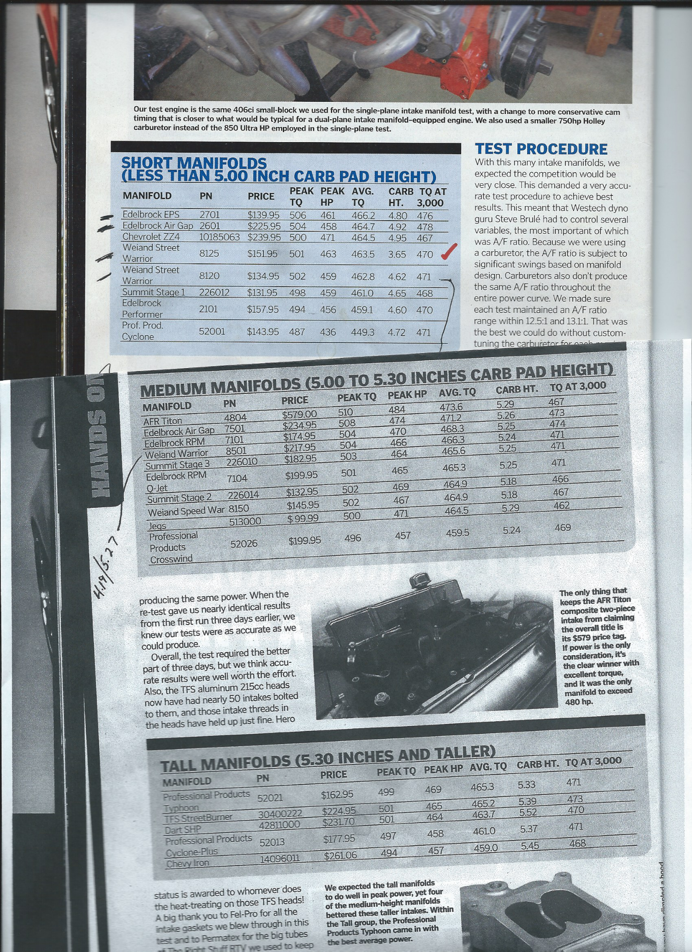

File Type: docx

Please note when looking at the numbers in the above article the Air Gap is the Performer Air Gap not the Performer RPM Air Gap.

You need to do a lot of homework on manifold heights. If you visit Edelbrocks web site, you can find the Carb Pad height of any model for comparison.
I believe the 2101 is close to stock height. So, you will need to write down that carb pad height. Then check on the Air Gap 7501 and so on.
Your best bet is a Drop-base air cleaner. Those bottom parts are usually 1 1/2" lower than stock. And if push comes to shove, there are 2.5" tall filter cartridges.
The Air Gap has shown between 22 -25 horse gains on a dyno. But what's important here is not just the power gain but rather getting the carb and fuel line up and away from the heat. As all C3s owners know, fuel percolation has always been a thorn in your side. The Air Gap reduces carb base temps and is worth every penny to isolate the vapor lock issue.

The 2101 shows 456 H.P. (and that's a little better that the GM)
The 7501 shows 474.
So there's +18 more.
With the right combo, the 7501 will vetch 20-25.

Test engine was a 406 SBC as per the article.
