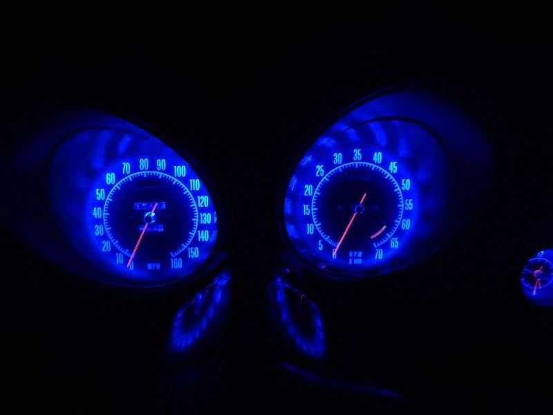

I used blue LEDs in a '72. A little too much bling for some but I like it. The stock dimmer would not give "fine" adjustment so I added a PWM and can get a better range of control.

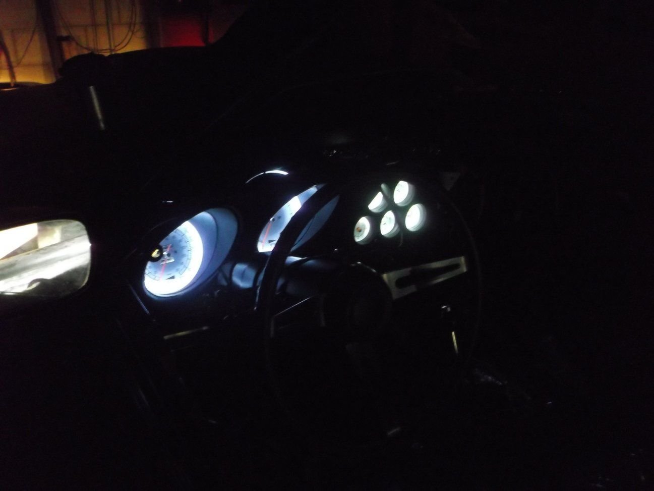

With mine I did a white face overlay and white LED bulb replacement.
