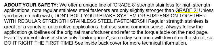

buns's Avatar
buns
Joined: Feb 2006
Posts: 4,142
Likes: 704
Info from Totally Stainless
