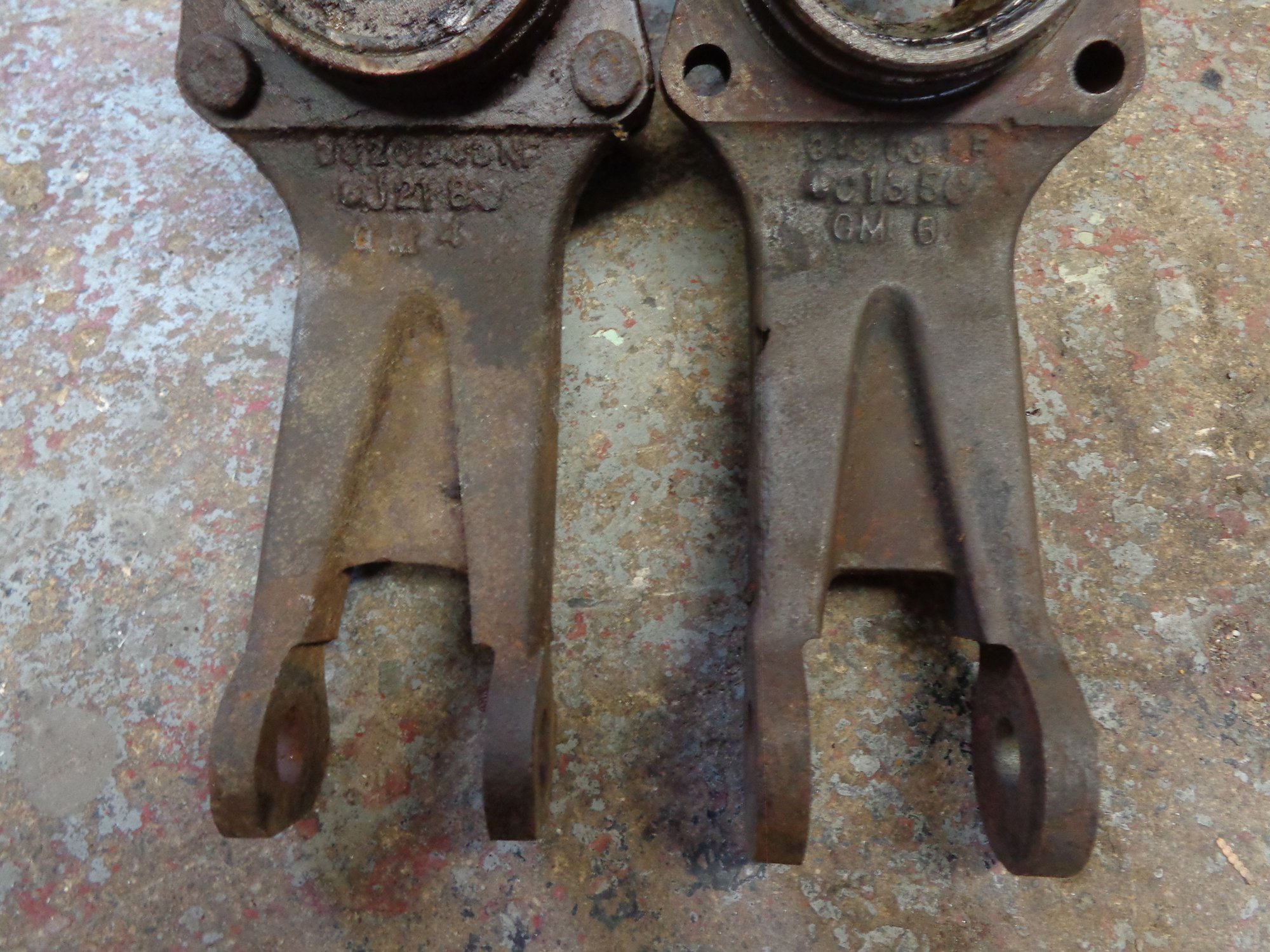

One has the flat area at the bottom where the shock mount bolt goes through

It looks like the bottom of the one on the left has skidded down the road and got worn off.

many of the legs had flats ground in them. Those are small heads and the date codes appear to be J21 8 & C13 5 so I would say they are Oct 21 1968 and march 13 1965. If they were the large heads then I would say they are 78 & 75's
