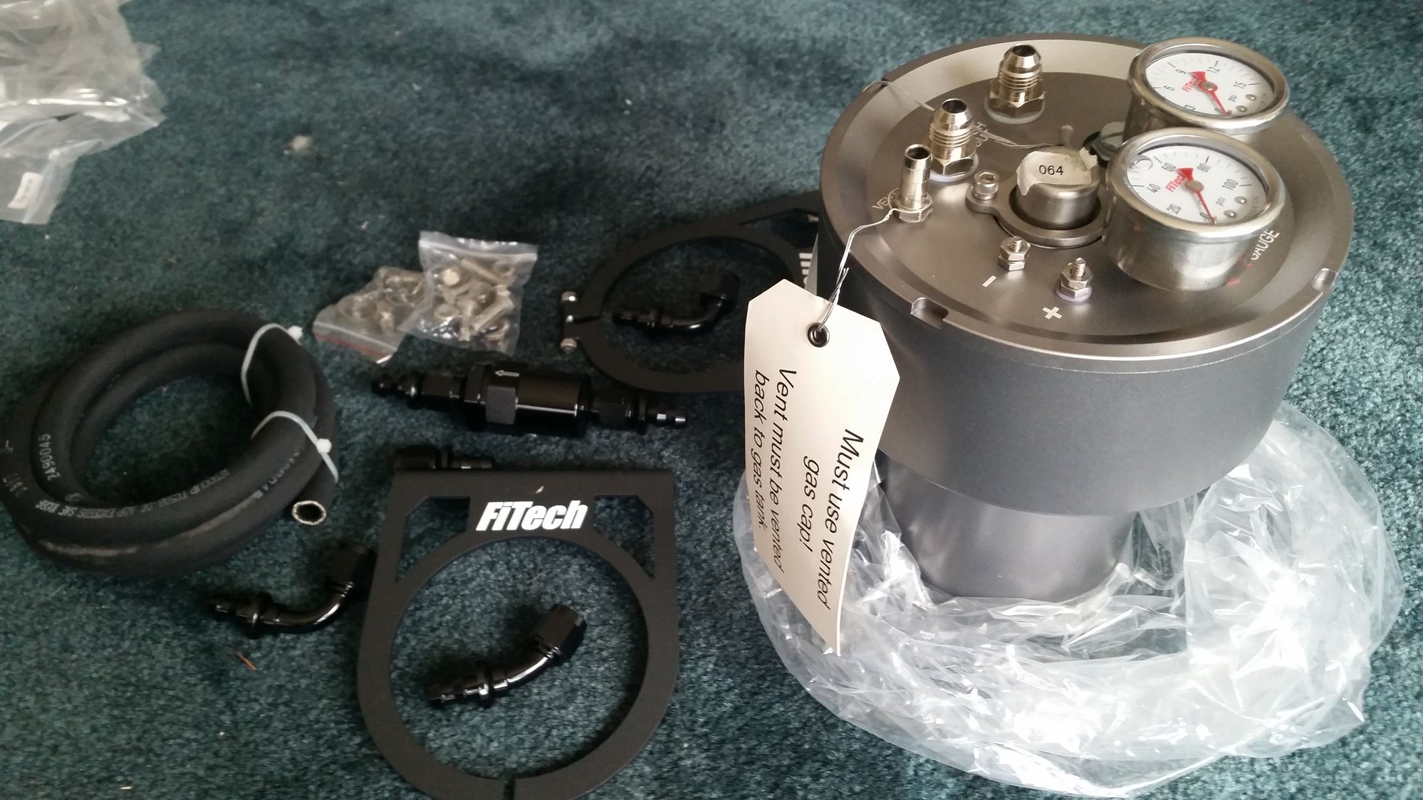

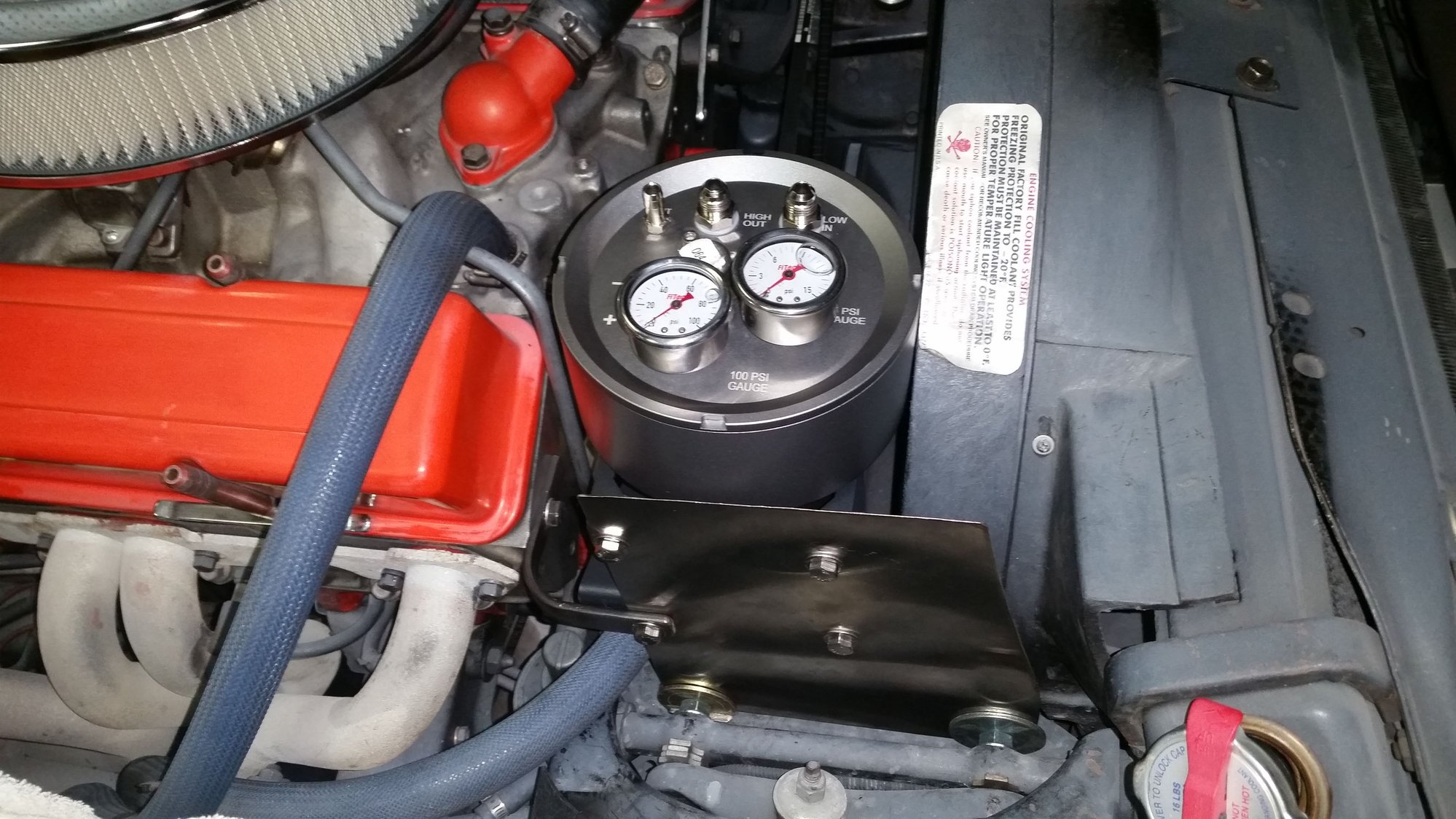

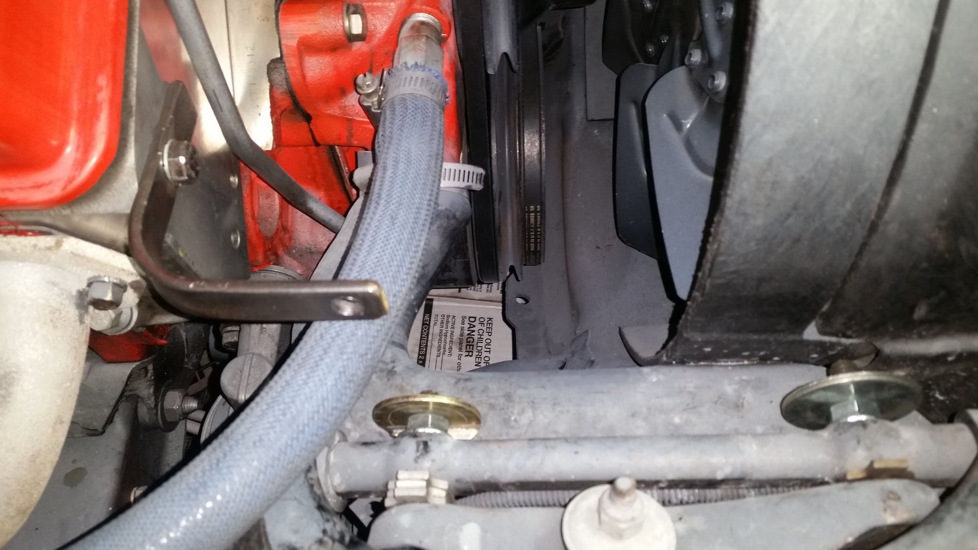

"If everyone else jumped off a cliff, would you too?" Kinda how I feel about this modification. A lot of people are doin it. It's a 383 and gets 11 mpg around town with a stock Rochester.

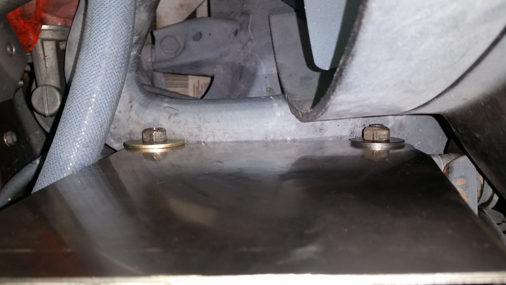

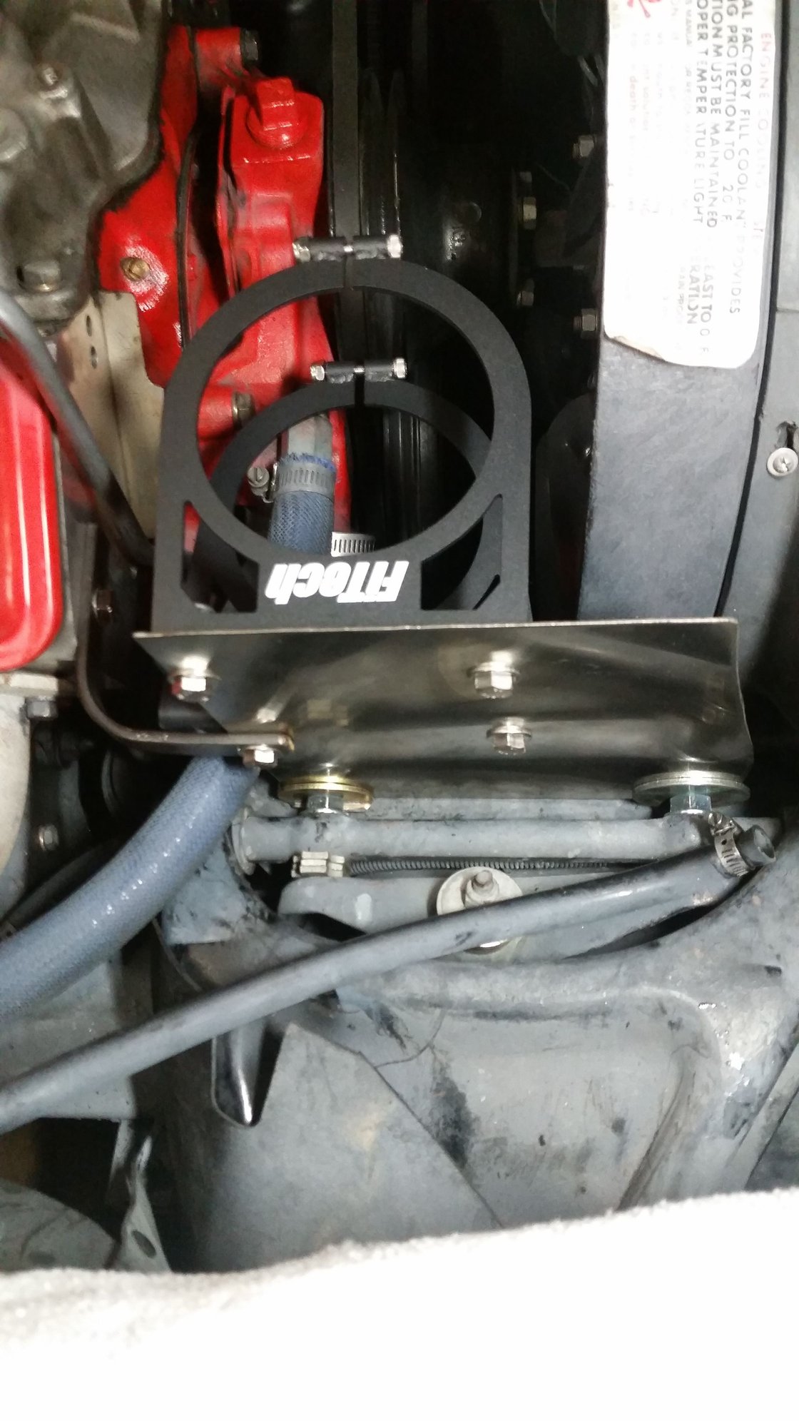

I'm concerned about the bracket between the Block and plate, which is attached to the Frame. Will engine start/vibration tear up the Plate after a short time (It's stainless steel)?

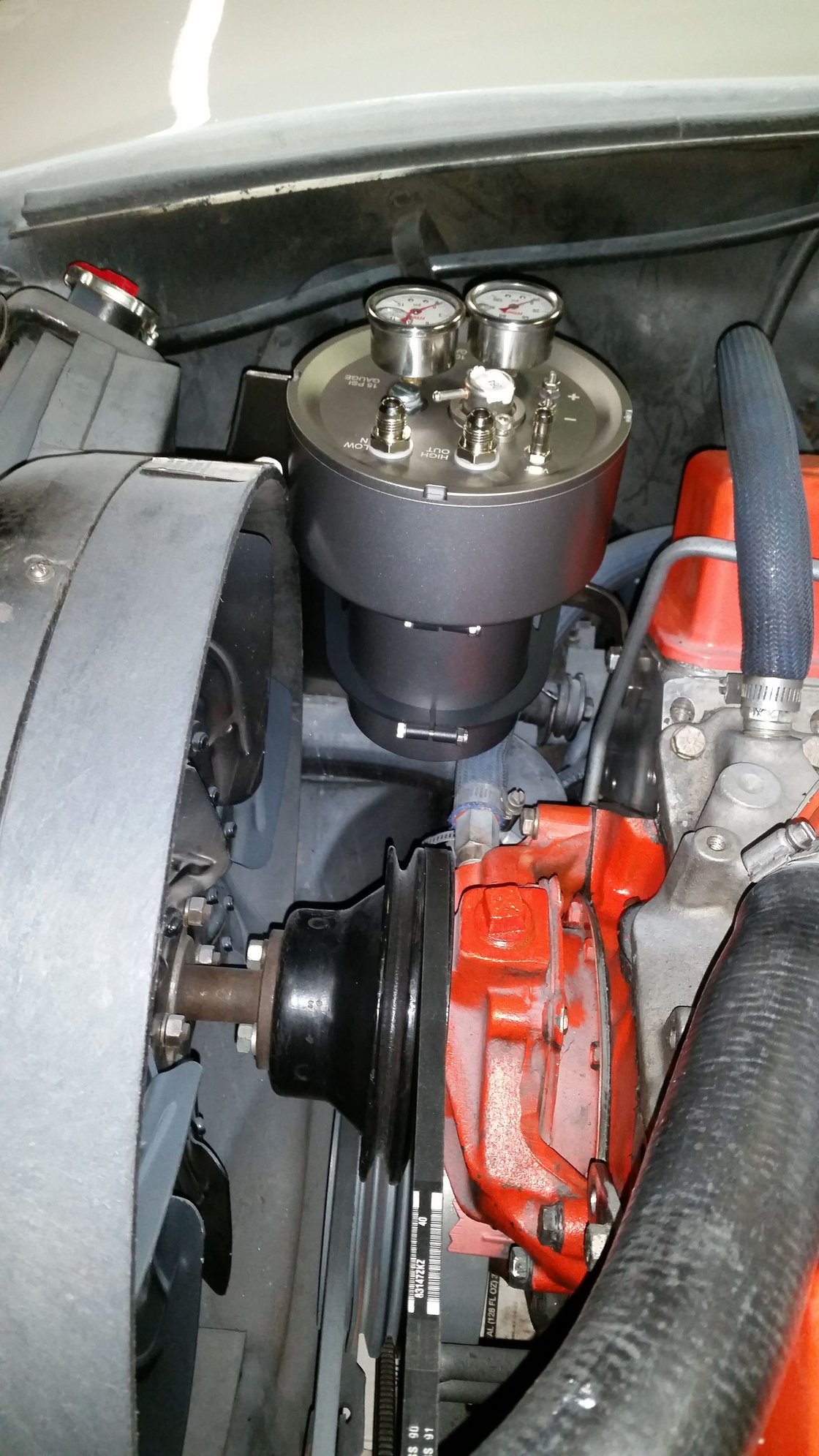

Also, the "Fuel Command Center" 's canister edge is not quite an inch from the closest Fan Blade.
Any thoughts on this installation is appreciated.
Steve

The engine does move quite a bit unless you have solid motor mounts. I would be concerned about it. Is it possible to put some kind of rubber isolates on the bracket to absorb some of the movement? I have not used the Command center, always went with electric pumps. I have heard some problems with the command center but others have said it works fine.

Looks like a very clean install considering you’re limited on space considerations. I will be doing similar in the near future. However as others have pointed, the bracket attached to engine will add to the vibration and movement, both counter to your goal. Is it possible to run an additional type of support bracket from your radiator area?

Thanks. I like that idea of looking forward, around the Radiator somewhere, for a support attachment.

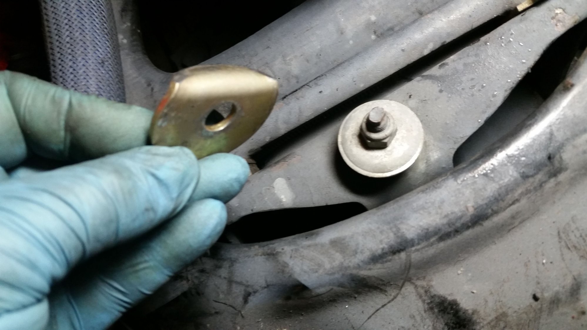

Just not enough height on the plate's other side, between the hood and the Shock Stud/A-Arm, which moves up of course going over a bump.
Steve

Maybe this?
https://www.mcmaster.com/9213k29
Large diameter. Between Plate and Arm.

I wouldn’t feel comfortable with that installation method on my car, the engine does move, unless you have solid mounts.
Your cylinder heads have multiple bolt holes; fabricate an L bracket that captures more than one bolt hole on the cylinder head, which will then allow the device to be supported solely by the engine - or - come up with a new plan to support it entirely on the body and/or chassis.

I would move it. I understand that Fitech made some changes to the unit and have had fewer issues. If you are not happy with the CC send it back and if you are still commited to using the original fuel tank look into a C5 regulator or a RobbMc Performance surge tank.

I would think that the first time you put the car in gear and push on the accelerator the torque of the engine will rip the bracket from the A-arm or at the least bend the L bracket mounted on the head.
Either way this seems like an accident going to happen.

Take the mounting plate that's bolted to the a-arm bolts and bend two 90 degree bends on the vertical sides of the mount. Maybe 1/2" wide. The bends will make it very strong. I'd also make it out 12 gauge sheet metal. What you are using looks 16 gauge or less.
Also as others have said take off the engine mounted brace.
Second option.
Make a bracket that bolts to the frame instead of the a-arm bolts. For what ever reason I don't like your current bracket bolted to the a-arm bolts.
Again just my .02. Hope the FI works well.

And for that matter I would use an In-tank pump and avoid another contraption in the engine compartment. From your fabrication skills it looks like it'd be easy for you. I used an in-tank fuel pump that I pull out from the the top.
That being said, I would NOT mount it like that at all....
