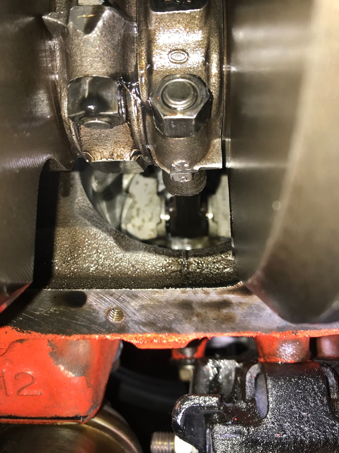

I dropped the pan and found no obvious issues. No parts in the pan and the oil did not have a sheen to it. so it doesn't appear as if anything is getting damaged.
I check the caps and bolts and all seemed to be tight.
I removed the number 2 cap and noticed that the bearing stops were on the same side ! The bearings look good fortunately. But how to solve this?
What would you do?
a) flip the cap around so that the bearing tabs are opposite like they are supposed to be, but the 'heavy' side of the bearing will be facing inside instead of out.
b) turn the connecting rod and piston 180 degrees. This will allow the oil hole to be facing inward per the service manual, but the piston would be facing the wrong way. This is a flat top 350 piston so is it an issue?
c) Pull the head, the piston and rod. Reassemble correctly at a significant cost and time. (my least favorite option.)

I cannot see well enough from your pics
But OE pistons and their OE-type replacements usually have a pin offset.
Those that do have offset usually have a dot or arrow etc in TOP of piston indicating which way to install ... for example pistons with dot must be installed with dot toward front of motor... all so offset pin is installed correct,
That offset is engineered in to reduce piston slap/knock.
Aye, but here's the rub: if that offset is installed backwards (e.g. dot to rear) the piston will slap/knock more than if its pin were not offset at all.
Is your piston installed wrong? I don't know
Does your motor knock because of incorrect offset? I don't know.

I think you do not want to rotate the piston in the bore. Valve reliefs will be on the wrong side. I couldn't tell you what to do. Probably pull the head is what I'd do and check the piston. Pretty much almost ready to pull the piston and rod right now, just the head, intake and cover left.
Someone here will set you straight. Oh, maybe you can get a borescope down #2 plug hole and check the top of the piston for marks, etc.

I will try the borescope today. I have one. See if that piston is in correct.
I found this article online and it makes me wonder if I have to worry at all about the orientation of the cap. http://engineprofessional.com/articles/EPQ416_50-54.pdf per the pictures on page 53. (its a article from a magazine, so its not 53 pages long. ;D)
And this article suggests that the orientation of the rod is correct. Note that the chamfer on the rod is facing the correct direction. Perhaps this is not the issue at all?
Maybe a cap is crossed with another odd numbered rod? hmm.
I also used a torque wrench to unloosen the nuts on the rod cap. It only took 50lbs of pressure to do this. It should have taken upwards of 70lbs +. Maybe it just needed to be tightened down more.

Bearing tangs are SUPPOSED to be on the same side.

Take a look at some pics of new rods on ebay - search "connecting rods". On many, you can see inside the big end, you'll see that tangs always face each other on the same side of the rod. If it's on the other way, the cap was installed backwards. Same with main caps.
More important now is what the bearing looks like. Shiny is fine, even with a few shallow scratches. Deep scratches or visible copper means trouble.

There was nothing wrong with the bearings. They were clean and perfect. I pulled number 1 and number 2 just to be sure. I put the oil pan back on and I am convinced now that it is probably the fuel pump and it's missing the tension spring or something. It's a new pump but have to believe it is something simpler than a lower end problem.

#4 main and 7 & 8 rods are usually the first to show starvation problems. If you've checked those, you're probably good. A rod won't knock unless the bearing is junk.
It can be so frustrating locating the problem since sound is transmitted through the block. When you pull the fuel pump and pushrod, use a borescope or something similar to check that cam lobe.
